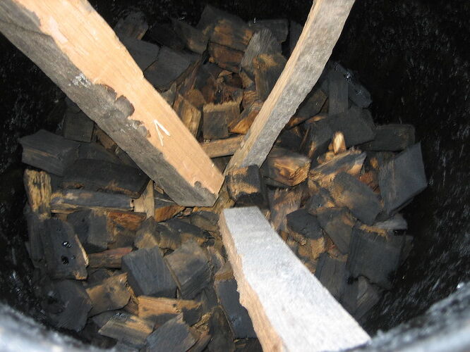

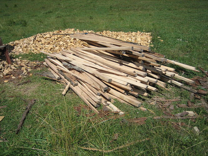

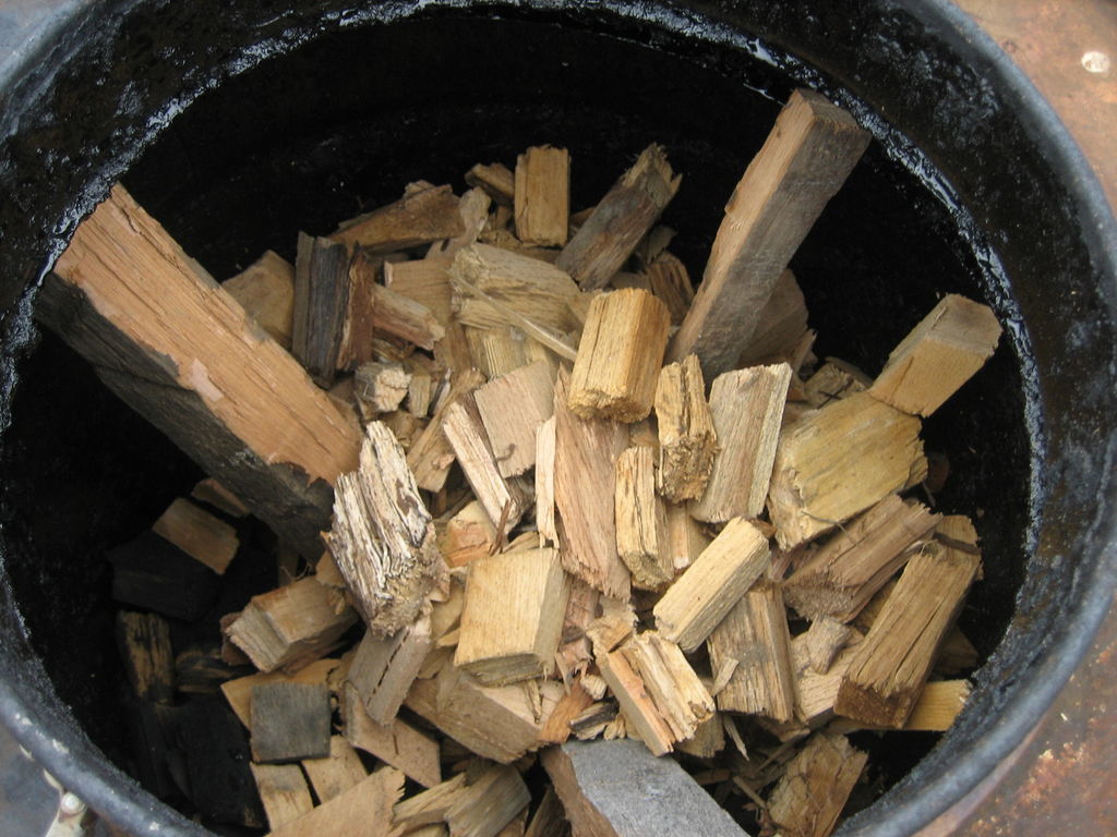

The first picture shows hickory sticks and the second shows a load of hickory chunks. (Tough stuff)

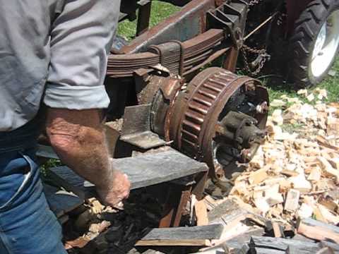

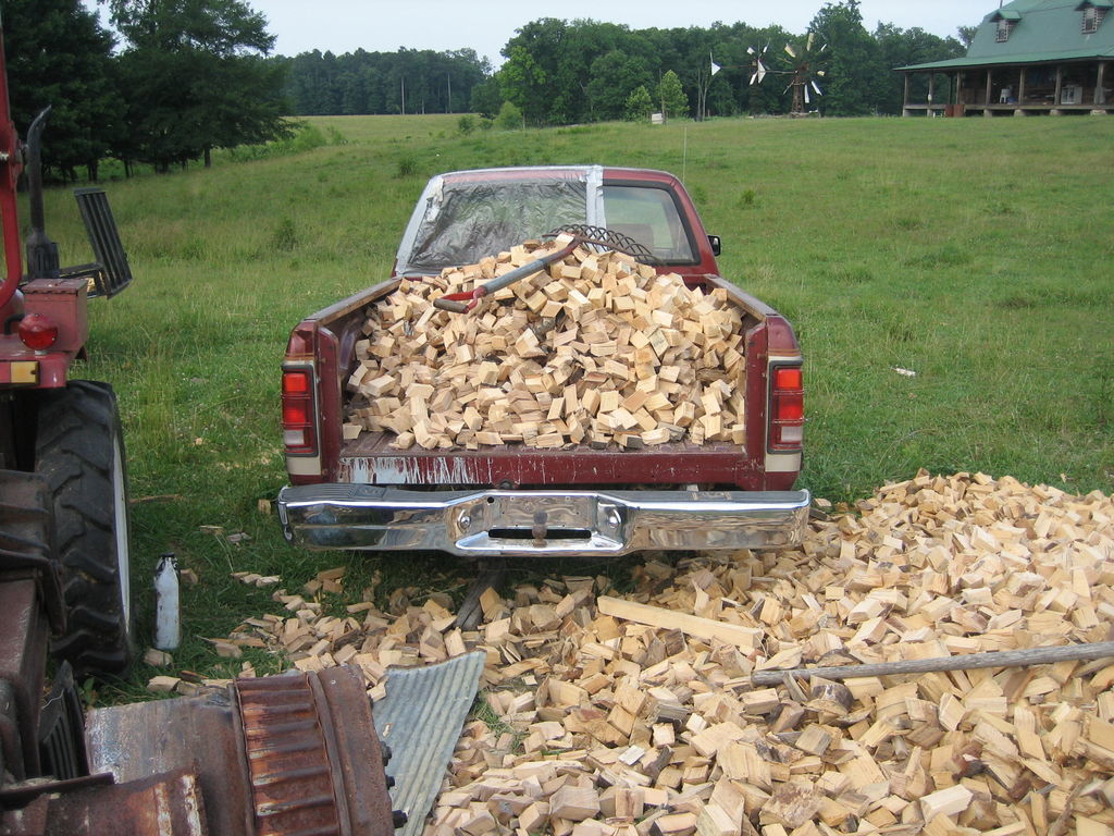

I have a lot of oak boards that have DRIED out for a couple years and need get them out of my way.
The wood chucker will splitter them if I try to cut them in small blocks so I use them in long lengths.
I think I could have idle down the splitter somewhat, it works faster than I care to.

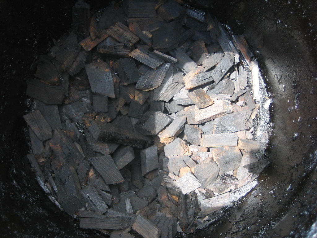

The last picture is 25 miles later.
