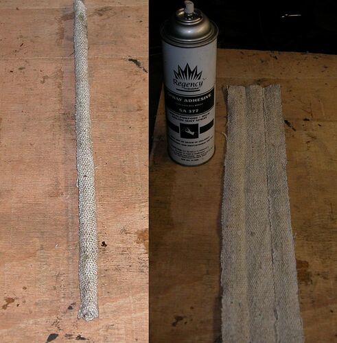

DIY high temp gaskets, this is what I use and they work excellent. I had a old welding blanket that I cut
into strips then I spray the strips with contact glue and roll them into a tube. They will form to make a good seal.
