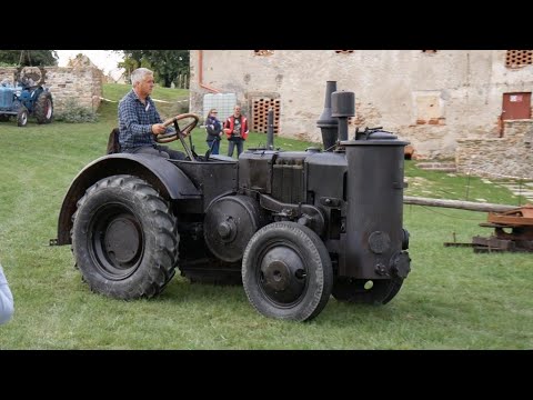

Diesel/ holzgas
I wish my hydrostatic Kubota was that fast
