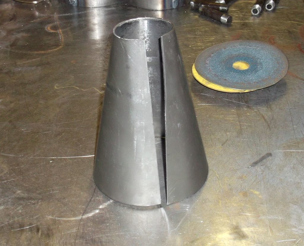

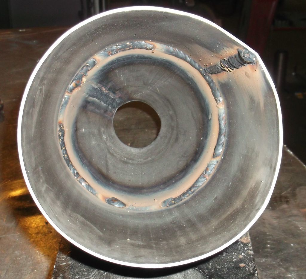

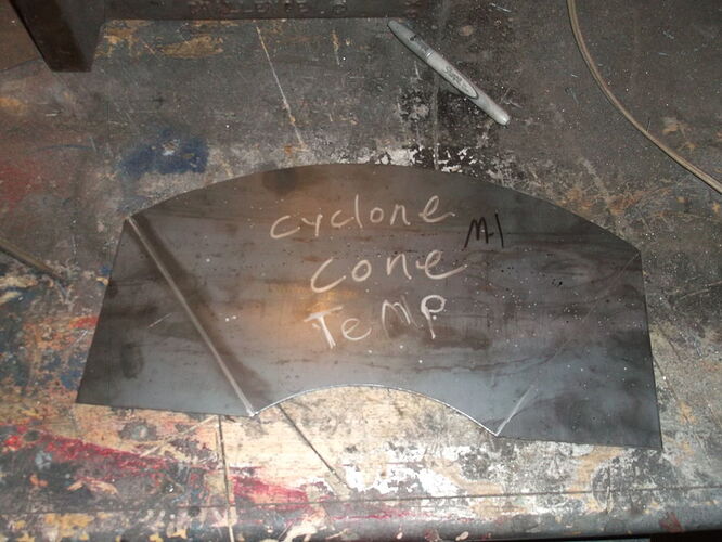

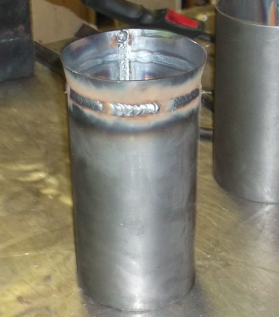

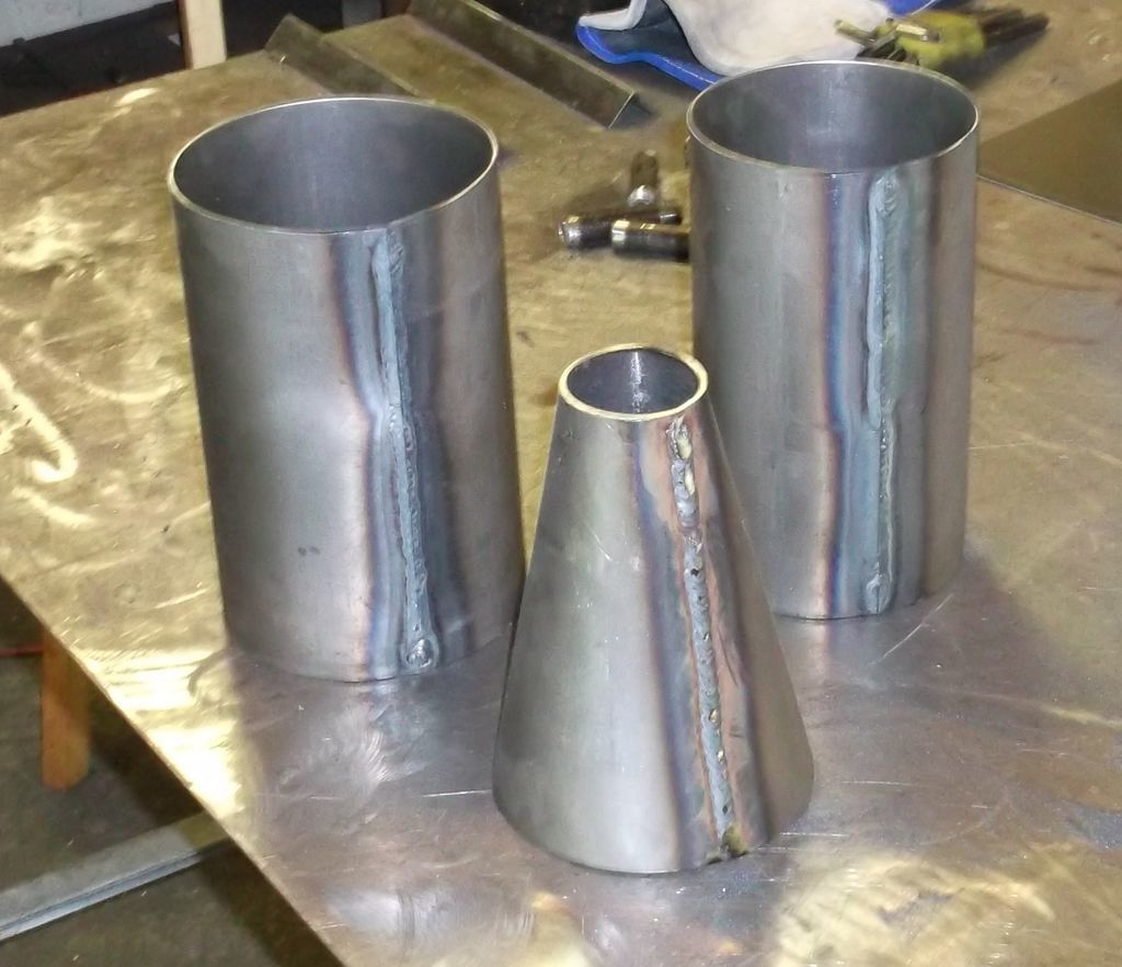

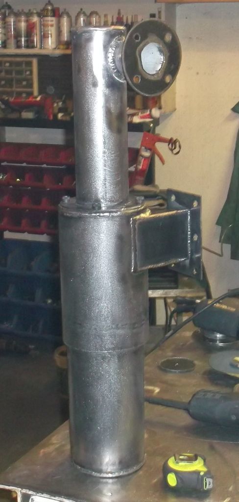

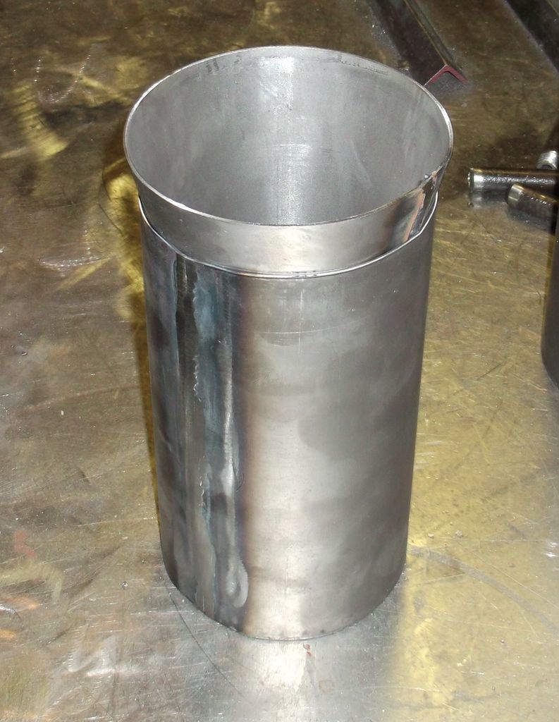

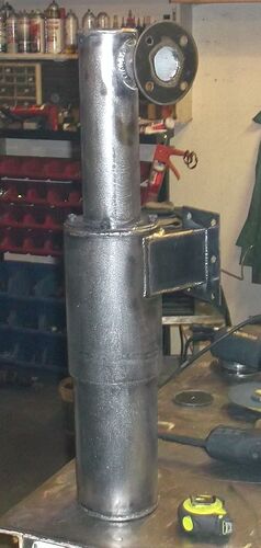

Today I built the cylcone for an E series build, below are the pics of the build. If you need further detail on how to build the roller let me know. If any one would like to attemp to replicate my cyclone you have my blessing :slight_smile: There are some things I do to the top end that are top secret though lol

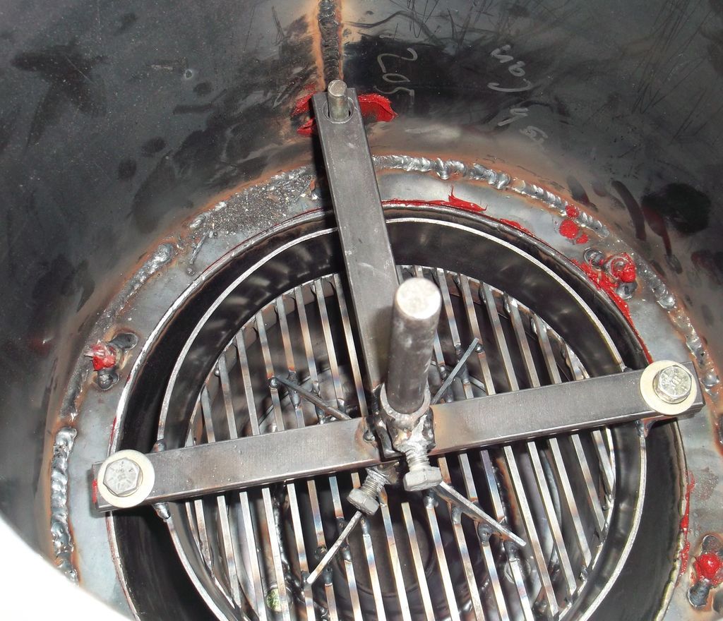

Pepe, Also here is a pic of my grate set-up. See the last pic.
Hi Matt, Very nice quality work all the way around. Your cone roller is a design I’d really like to build, care to share some build pics. I’m also curious about the grate setup actuation mechanism, rotate, shake or vibrate?
Thanks, Pepe

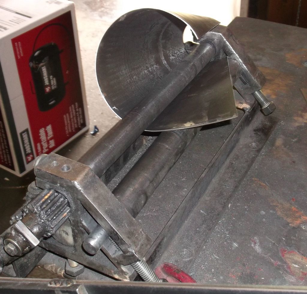

When I built my slip roller I just googled it and I really could not find a whole lot on one of these. The best I could really find the pic in the Harbor Fright add. I just studied it and built mine how I though this one was built.

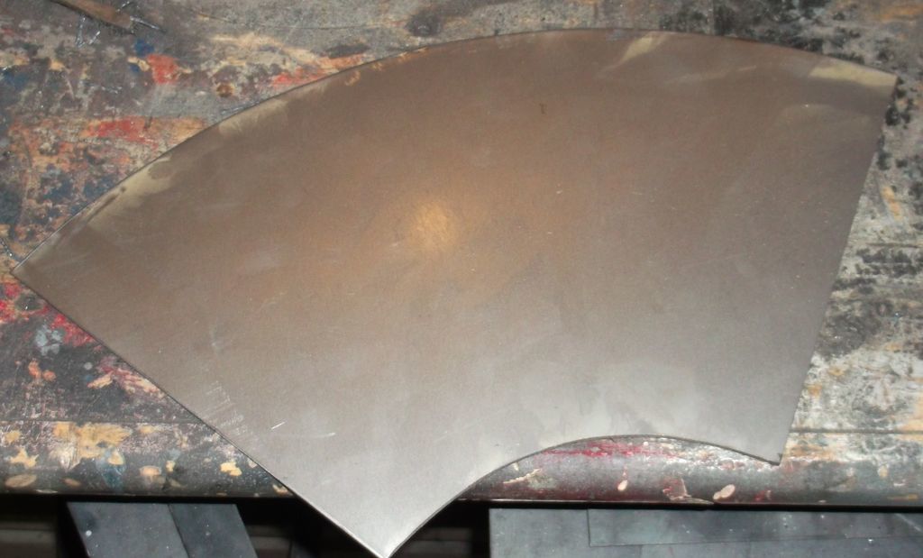

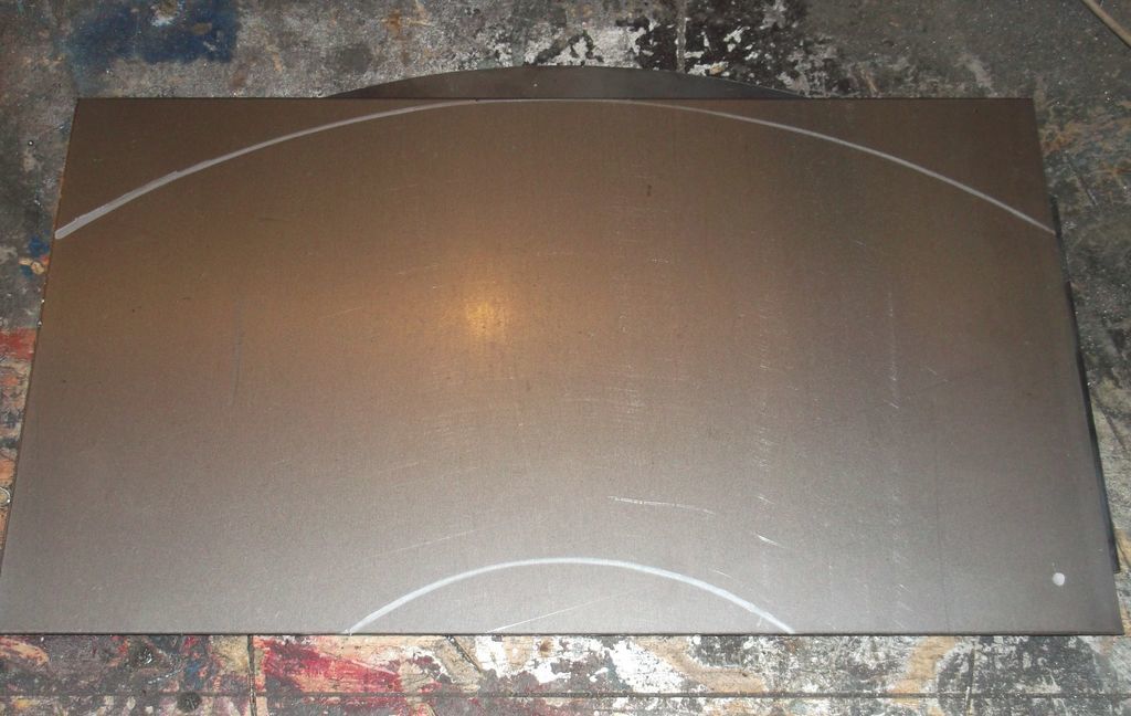

Rolling is easy, you just feed in your steel and roll it. Its as simple as that. You will need to do it many times untill its completely rolled. You will need to turn in the adjusters a few turns each time you roll. Rolling a cone is something I cant tell you how to do. You will need to just try and roll one. One thing I can tell you is you need a good lay out and your piece needs to be cut to that lay out. That is half the battle. Cones are something you have to get a feel for. It took me about 6 cones untill I could start rolling perfect cones. Its sort of like welding you have to do it to learn it.
Oh hey Pepe, Yeah the grate rotates. It works very well too. In mho rotating is the way to go. I just need to bump it to free it up in there.

Hi Matt, Nice job on the slip roller. I’ve seen something similiar on youtube but didn’t mark it. Will keep looking, it might have a couple of different views that might help. Grate rotates, thanks.
