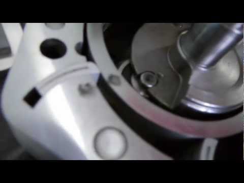

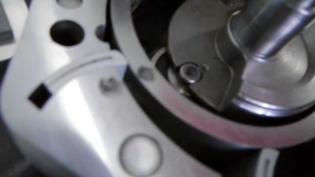

At 4:12 in the compressed air engine video there shows a multibladed fan blowing across the scooter? engine. Shows heat absorption fins stacks around the motor housing. He is using ambient air heat to keep his engine from frosting up.
