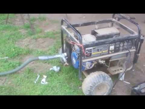

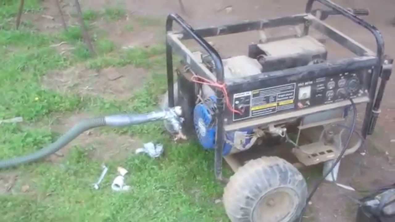

Hello Dave .
I have run a hose that is about 50 foot long. I don’t remember where the hose come from but I think it is a vacuum cleaner hose and possible a pool vacuum hose. Seems to do pretty good and holds up well. I took it on our coast to coast tour back in 2008 to put on demos with the generator and it is still holding up well .
Below couple of videos using it.

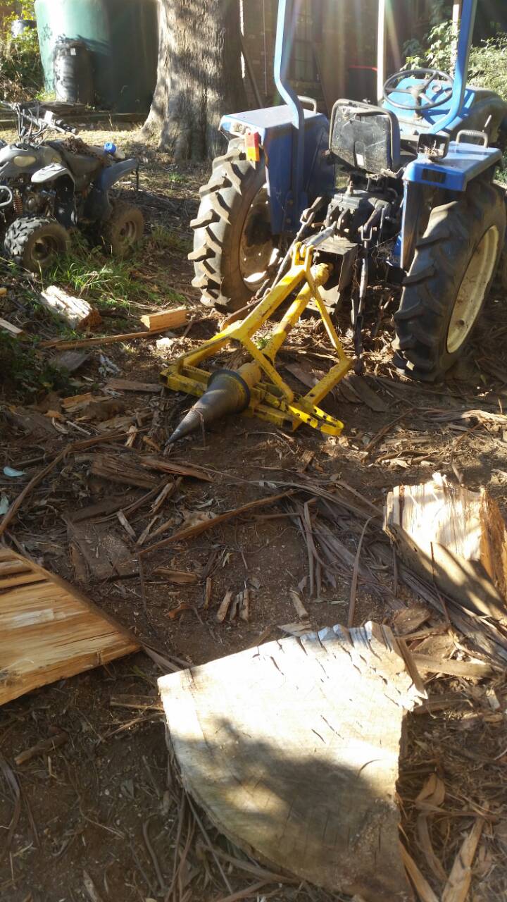

My property is up in the hills and with a garden that has a slope of 30 degs its real hard moving big heavy rounds around , but i do have a splitter cone on the back of the tractor that can pick them up and carry them close to the splitter before breaking them into smaller more lift able sizes
