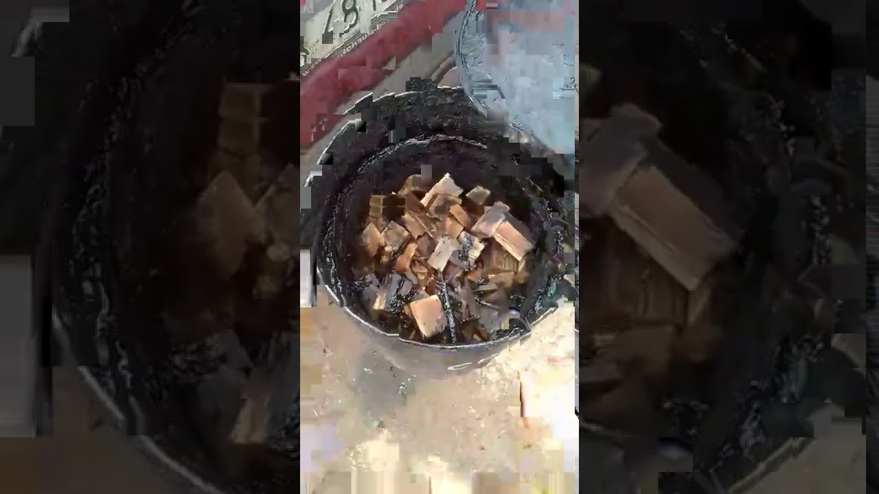

How long does it take to start up your installation with a wood fired gas generator?Recently, I have been thinking a lot whether it is possible to reduce the start-up time of the gas generator and, accordingly, the engine on the obtained gas. This is how it works for me.
Today I finished work on my tenth system, although tests are still ahead. The main goal of building this system was to achieve the fastest possible start-up and get good gas. Apparently, it should start at the same speed as the coal gas generator.

How I start my gasifiers will depend on how big a hurry I am in. If in big hurry I will light the gasifier and drive on gasoline until the gasifier is producing good gas . I would expect to drive a couple of minutes from first light to be running on wood gas.
When not in hurry I will start up like this video and expect start to be 2-3 min.
Thanks for your participation
Wayne
Hi Joni, I take it, that on quick start ups you are taking about no gasoline in involved. Right?
My WK gasifer uses the engine to preheat the air going into the gasifer. So I can just start up the truck on gas. Turn on my suction/blower. Open the hopper check the condition of my char bed with my prob bar. As long as I had a good charcoal bed when it was shut down, I can light it up in the borehole I made in the middle. Cave in the torified wood on top and add wood. Reverse the blower flow back and forth a few times. Fill the hopper with wood gas shut the blower off close the hopper lid. Start up the suction blower again. And gas is on its way the to engine. The reason is the 2 wood gas valve to the engine when closed are never completely seal off. So if I close my air supply to my engine a little it will start a vacuum draw on the gasifer to the engine. Mean while the engine is preheating the air to the gasifer.
With in a few minutes it is ready to go.
I can also just drive away in the truck on gasoline and woodgas as the gasifer gets up to temperature no sense wasting gasoline sitting there. And switch it over to wood gas as I drive down the road.
If I am doing this with out gasoline at all, it will take longer to get the big gasifer unit up to temperature. I also will check my gas by flaring it or just looking at the smoke haze. It is a little different when operating a WK Gasifier than the Imbert style gasifer.
