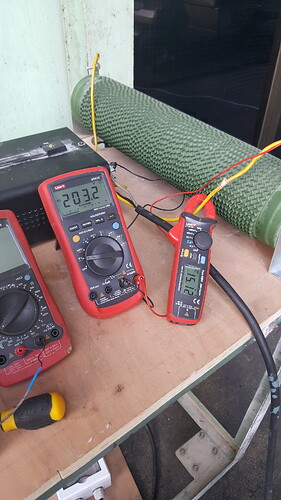

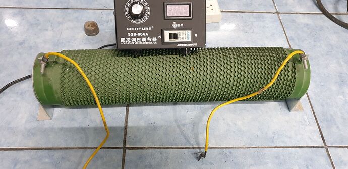

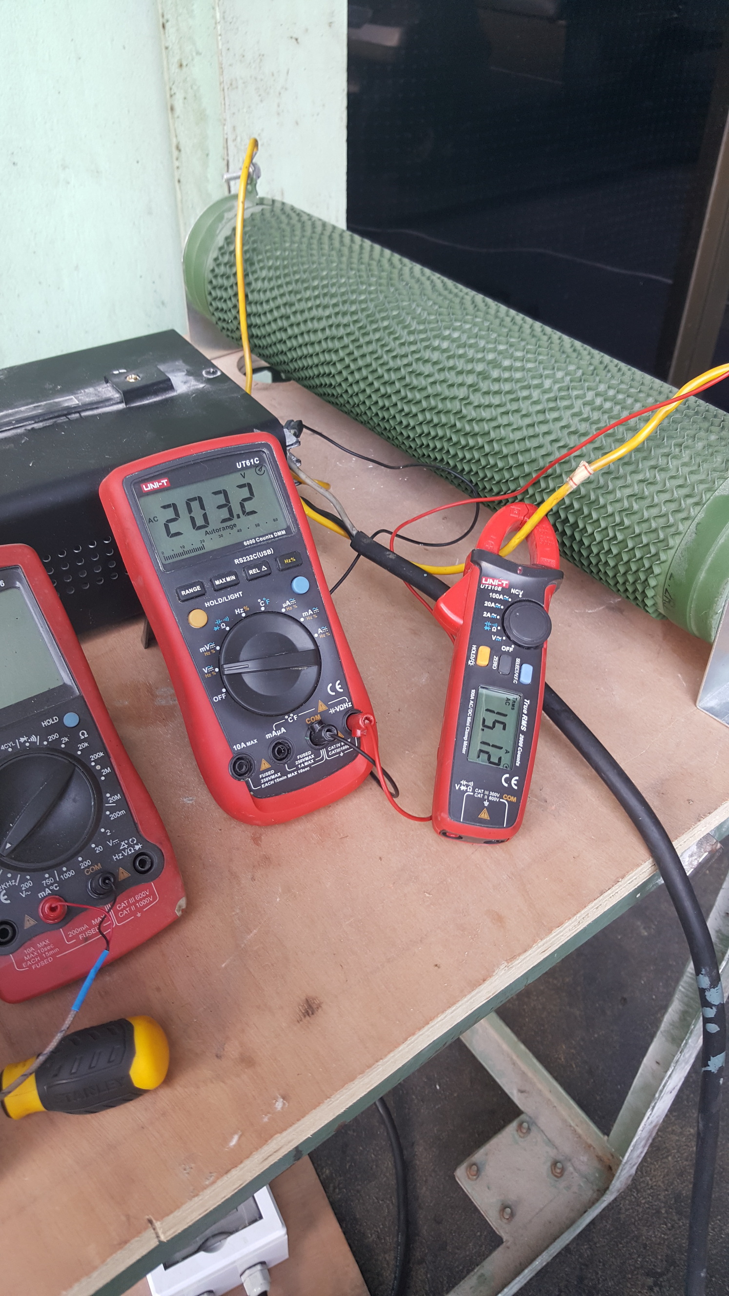

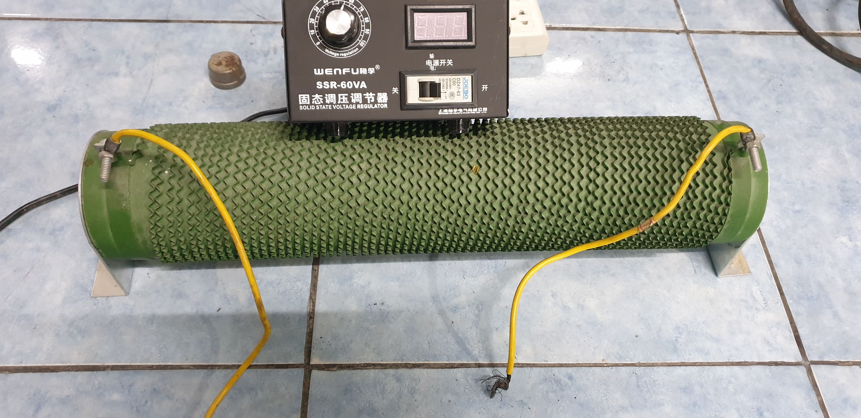

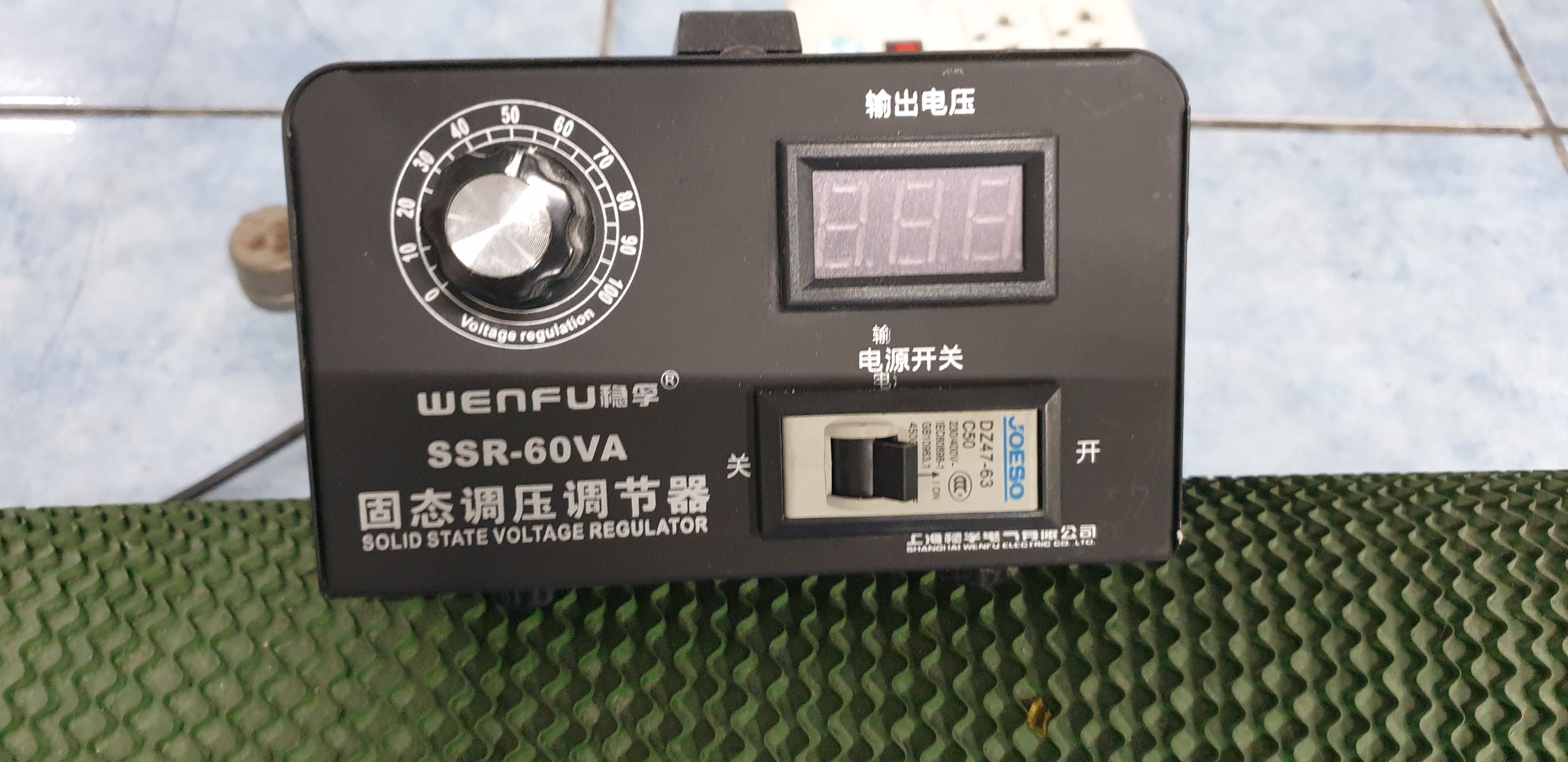

If I understand your scheme, you have a high-powered fixed resistor (looks like nichrome wire}, and a solid-state relay that is acting like a light dimmer to control the voltage and thus current into that resistor. The voltmeter measures the voltage and the clamp-on ammeter measures the current. Multiplying current times voltage gives you the power in watts.
Is my interpretation correct? I guess I need to find out more about the solid state relay (SSR).
