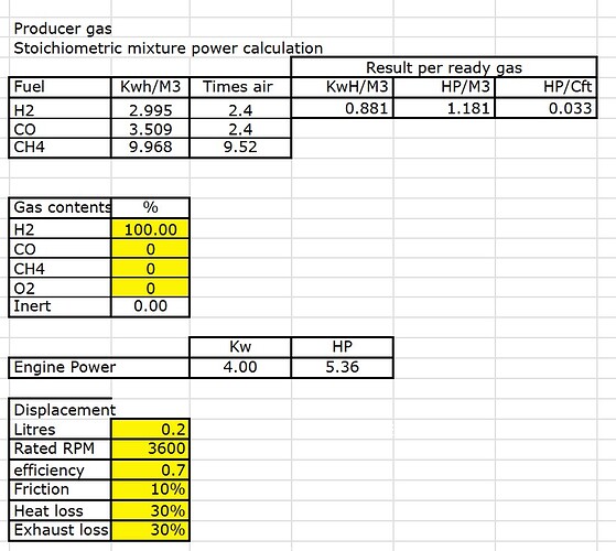

anyways, posting these next picture gives an indication why i don’t go that route yet.

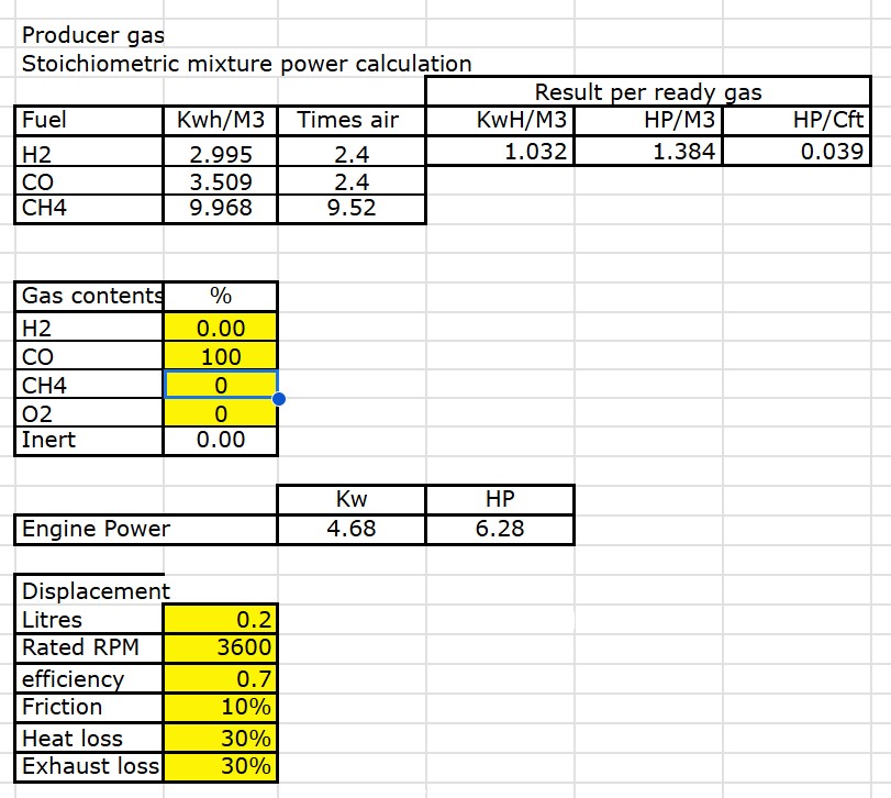

Notice the power from the same previous engine, the energy content per volume of mixed gas ( with air )
Co2 is twice the size of H2 and steam is massively larger pre shift. Its not just the added the hydrogen here. Any decrease of Co2 is a massive thing here it litterally makes the added H2 plus other volitals much more potent.

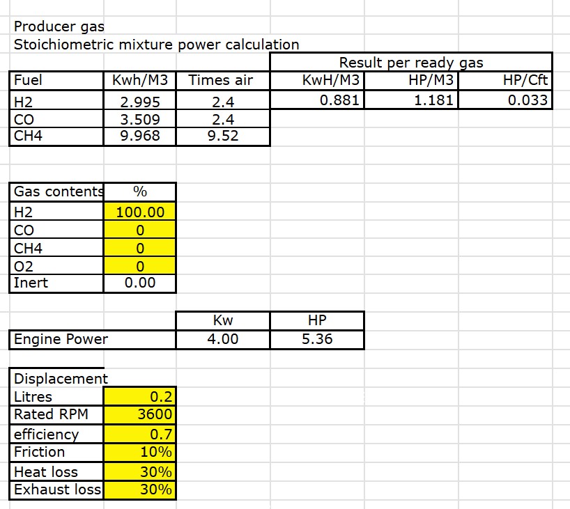

Excellent data sets Koen.
Now lets translate it back into real world usages.
