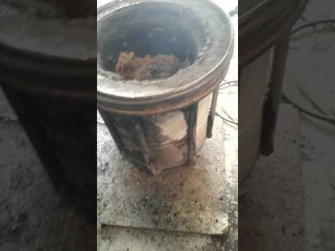

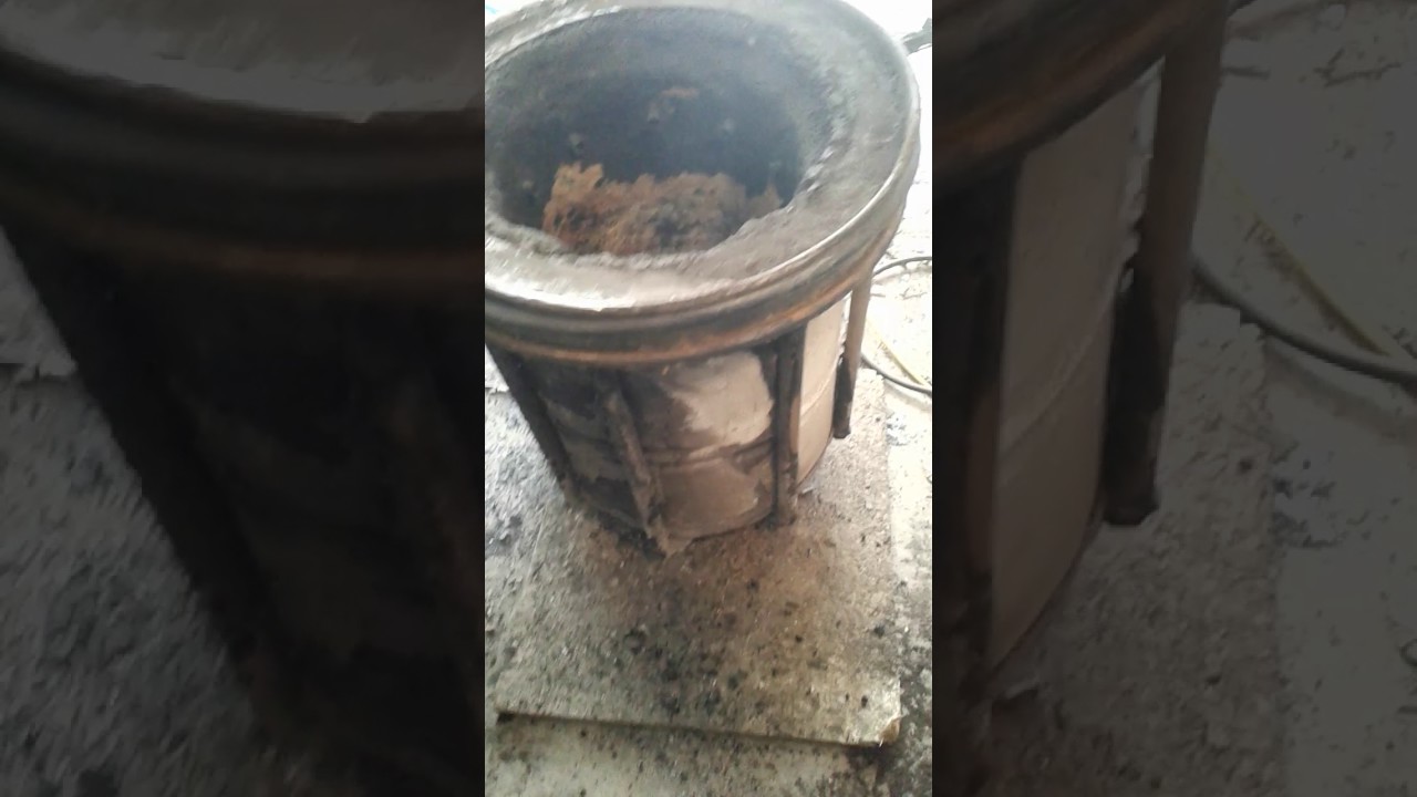

That was one big leak my friend, i am serprized that the leak never even waisted your light burn tube.
we all need to find some of the 55 gallon stainless drums at a good price I keep watching nothing around here . I just keep adding paint knowing the end is near :

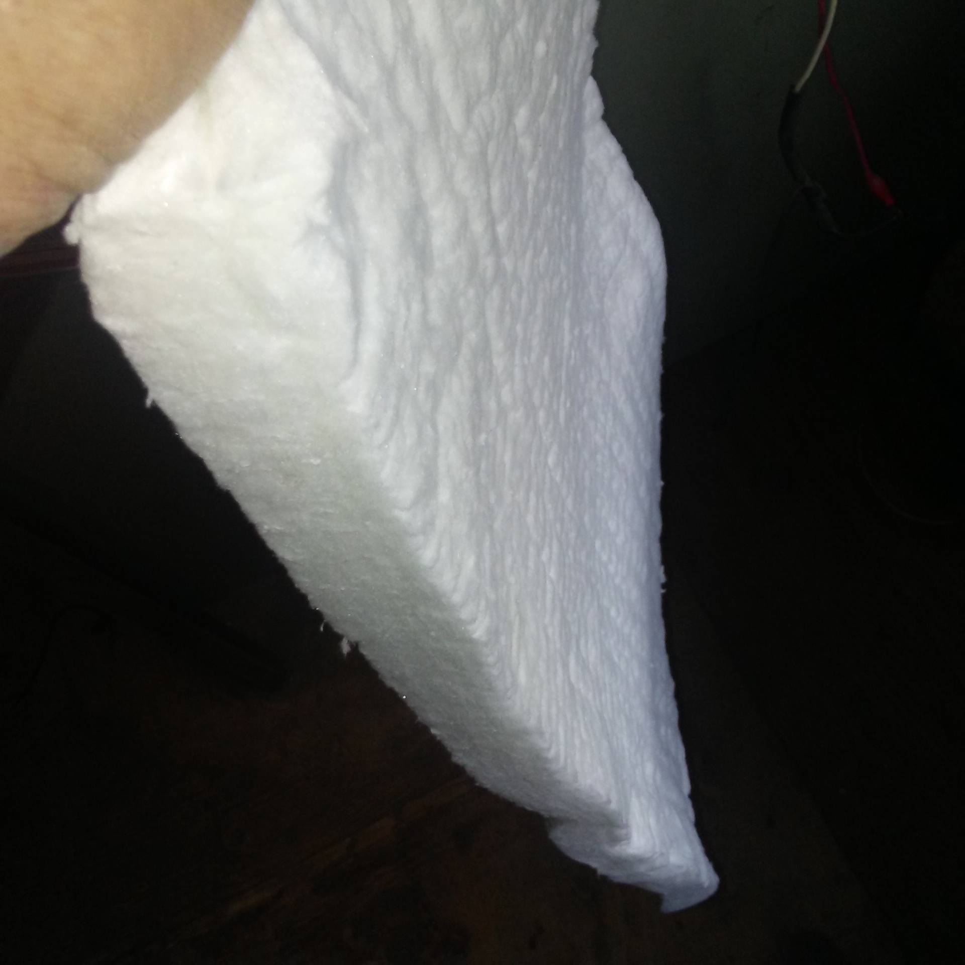

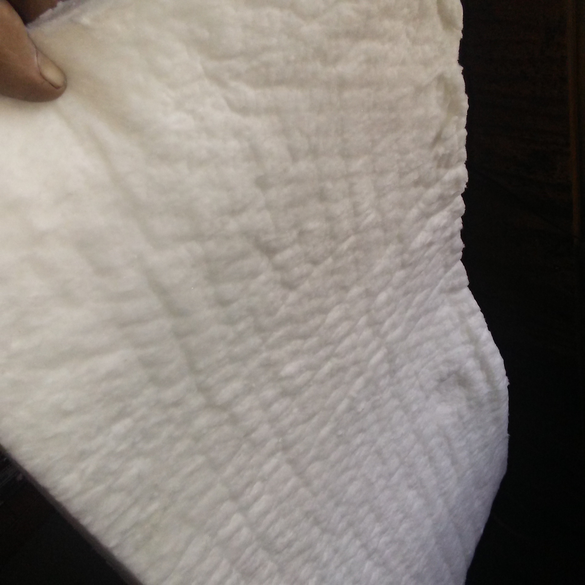

Bought some 8 pound per cube foot one inch thick and it sire is nice and dence, i see why it will stand up fairly well till wood rosin baked.
bought some small peices so makeing 2" thick about same price if bought 1" thick after over laping joints. North star is the last photo.
I would just watch handling the blanket mine came with all sorts of safety precautions (gloves-resperator-) its supposed to be some bad stuff to get on you once in place and burnt there shouldn’t be any problems.
What Paul said , it has micro fine partials that can do damage to your respiratory system , we have come into a large amount of the Kwool here from a very large industrial oven , and by chance the people that made the oven many years ago saw it in the yard and told us all about how they installed the insulation when they built the oven , lucky for because they told me they wetted the blanket to mould it to the shape they needed , so me being me grabbed a few handfuls and soaked it in water and placed small amounts all over the outside the lid of a small bbq I have , once dry and cooked its hard and helps keep the heat inside the bbq for when I make pizza;s .
I allways knew insulate was bad for you lunges, Thanks for the extra warning i am going too research now for sure.
