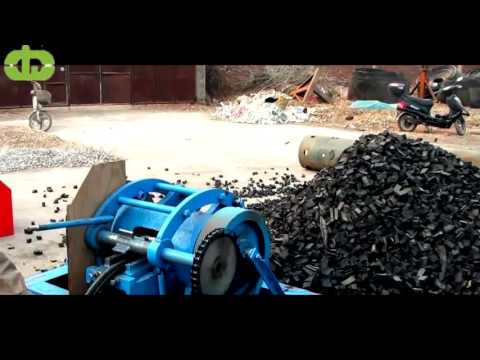

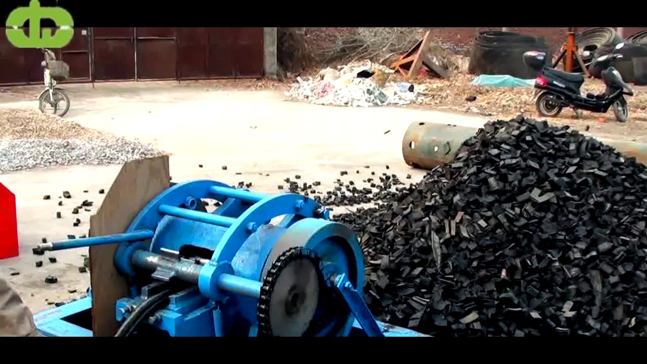

This is the kind of equipment needed for the rubber processing.
