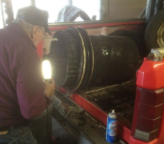

Found some time to disassemble the gasifier on the F-250 this weekend.
The gutter on hopper needed cleaning. We may add the double gutter setup while it is apart.
Unscrewing the pipes in the heat exchanger and gasifier seemd to be about as easy as the day they were put together. Awesome easy, thx Wayne.
On our Wayne Keith replica attempt, unscrewing the pipe threads was impossible, we ended up cutting.
Do you do anything special to the threads, or do you think we just get our gasifier that much too hot and welded the threads together?
