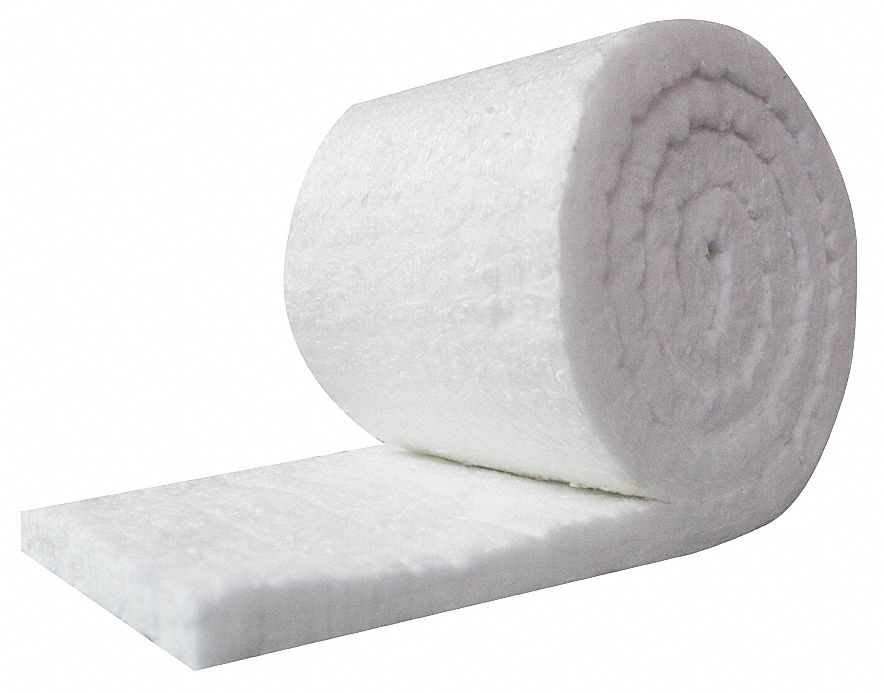

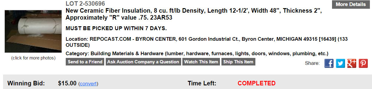

I couldn’t resist bidding on this today after seeing that hardly anybody else was interested.
Granger wants $200 for it, so I guess I did OK. It is good for 2300 F.

Nice insulation there…

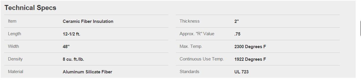

Hi Don,
I can’t decipher that R value number. What is the R value?

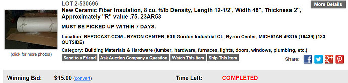

Hid bid info says he got this for $15.00 usd. Good score DonM.
That R value is by the inch thickness. So double it for the 2" uncompressed as supplied. 4X to 6X that for what you’d expect to see in a wall.
AND I think the R rating is at the expected temperature differential in use too. They are expecting you to be using this at very high versus ambient temps. It’s all good. In fact it is great.

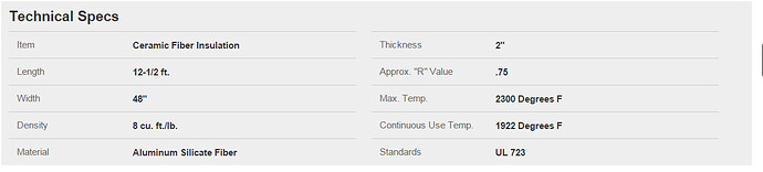

Yes, it’s per inch. See the 1" batt here, same value:
Here’s the datasheet:
http://www.grainger.com/ec/pdf/UNITHERM-Ceramic-Insulation-48inWx12.5ft-Specs.pdf
I think they’re giving you metric units, based on the thermal conductivity of 0.09 (752F) / 0.18(1472F). Mineral wool is similar but not quite as good… http://www.engineeringtoolbox.com/mineral-wool-insulation-k-values-d_815.html
The imperial R-value is 5.68 times bigger than the metric version.
So you’re looking at about R 8.5 insulation… at 2,000 degrees!!

Hi don and chris ,are you thinking this type is a little better than Rock Wool.I will keep my eyes open for deals, THANKS
I only got this because it was a good deal. I would not go out and buy it full price because Rock Wool works almost as good and is a lot cheaper
That would be expensive weight reduction over rock wool,space saver tech.
Hi Don, this is a magnificent material, personally we use it on our ceramic ovens (my wife is a ceramist -potter-) y we burn at about 1.180 degrees centigrade (oC). We have home made ovens with this material that are about 30 years old and the material is intact, it´s almost undistructable. Use it, an at that price, don´t even think about it. Soon I´ll be posting some fotos of our proyects, the idea is to use woodgas for the ceramic ovens.
