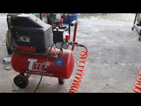

I have compressed my charcoal gas
YAY! I finally compressed charcoal gas into an old style propane tank. I pumped out as much of the air that might have been in it first and pumped in charcoal gas from my gasifier. Then I used the stored gas to run a burner. This opens up a whole new level for my charcoal gas experiments. Maybe run a vehicle in the future. https://www.youtube.com/watch?v=UeS7IJzXkiU

Also be careful of the compressor. Some compressors aren’t made to handle volatile gases. leak spark and boom comes to mind like a spark from the motor or the piston heating up in the compressor. Some of the gases will destablize at higher pressures, but I doubt you are getting that much pressure.
If you are trying to run a pressurized system, your best bet is probably a bag, and you can fill it with a spark proof exhaust motor. And if you are going that far, you probably should put in a drop of mercaptan so you can smell a leak.
