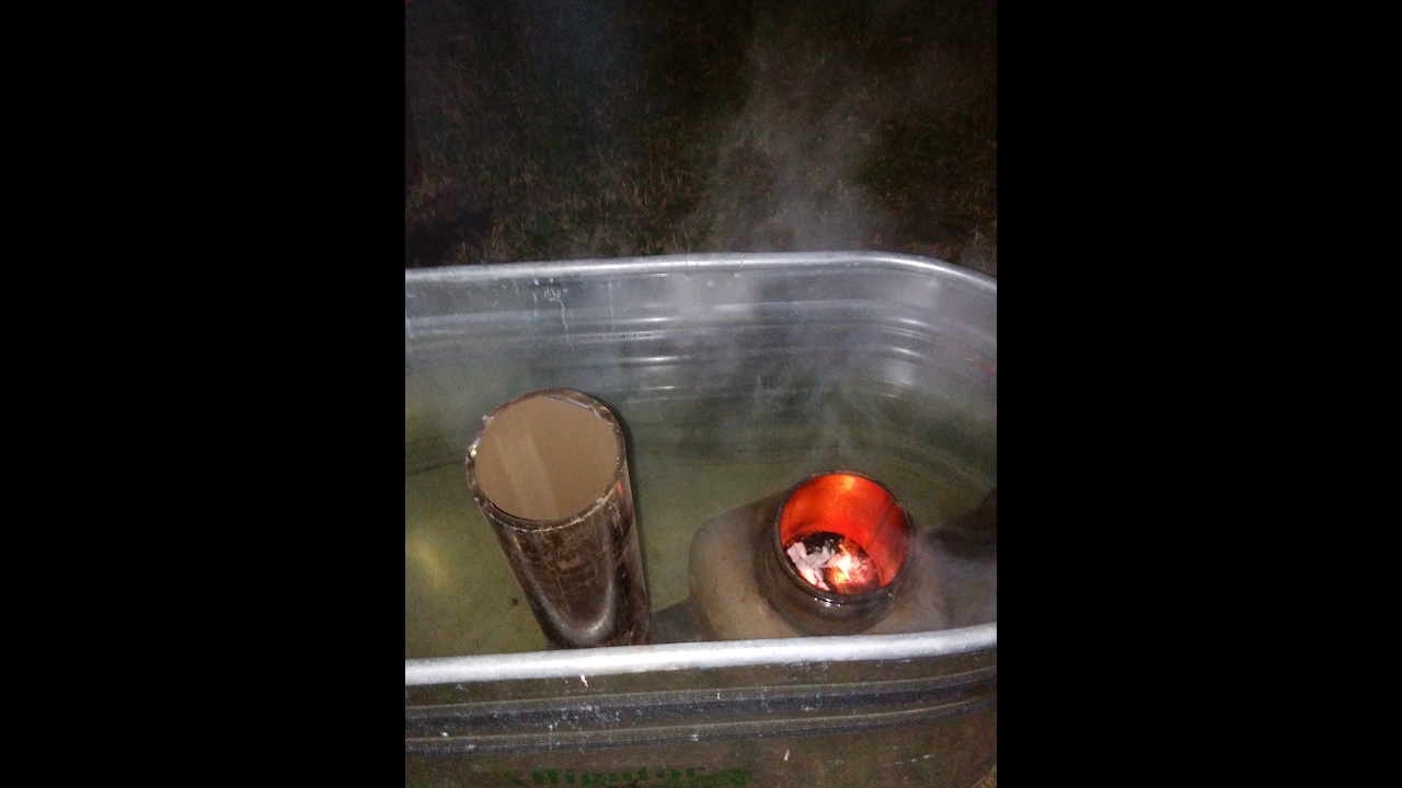

Interesting I don’t have time to watch the entire video right now. How easy is it to start? The problem I had with my Tarm wood gasification boiler was that it was a bear to start if the temp was below 140F the water jacket would just pull too much heat out of the fire box.
It was not bad to start, his design is very good needs hooks or feet so it does not tip over but I imagine running this on pine needles it would burn like crazy.

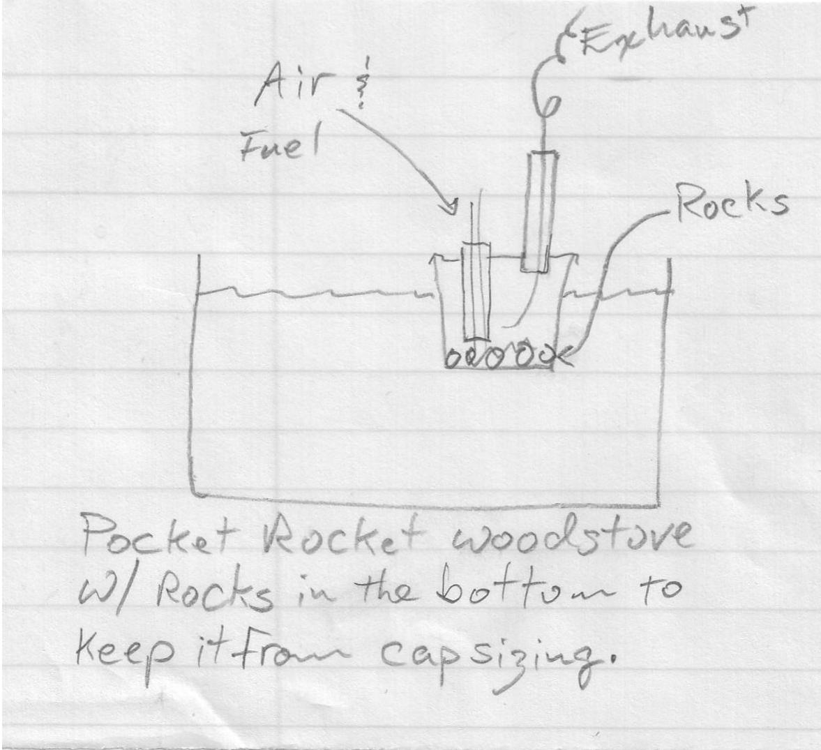

I wonder if a 'Pocket Rocket could be made out of a five gallon paint can, rocks put in the bottom for balast, and floated in a water tank.

The reason that this heats up the water so fast is how much surface area is touching the water I do believe, also at play is how much volume of air is in the main chamber. What totally baffles me is why does this stove does not smoke more than it does as shown on the video.

I was also considering that one could use something with far less thick metal as he showed in the video ( as you mentioned a paint can with thin metal ) as it does not have to stand up to much heat, all heat in theory would be taken away by the water.
Perhaps a stainless steel pot… with rock / sand in the bottom of it.
Looking at your paint bucket idea, It has me thinking, why not use a 100 gal propane tank and lay it side ways and put it in the water with legs on each side welded on. Then cut two holes for vents at the top for both the chimney and the wood feed, with rocks in the bottom to hold it down in the water.
