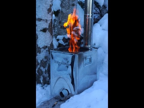

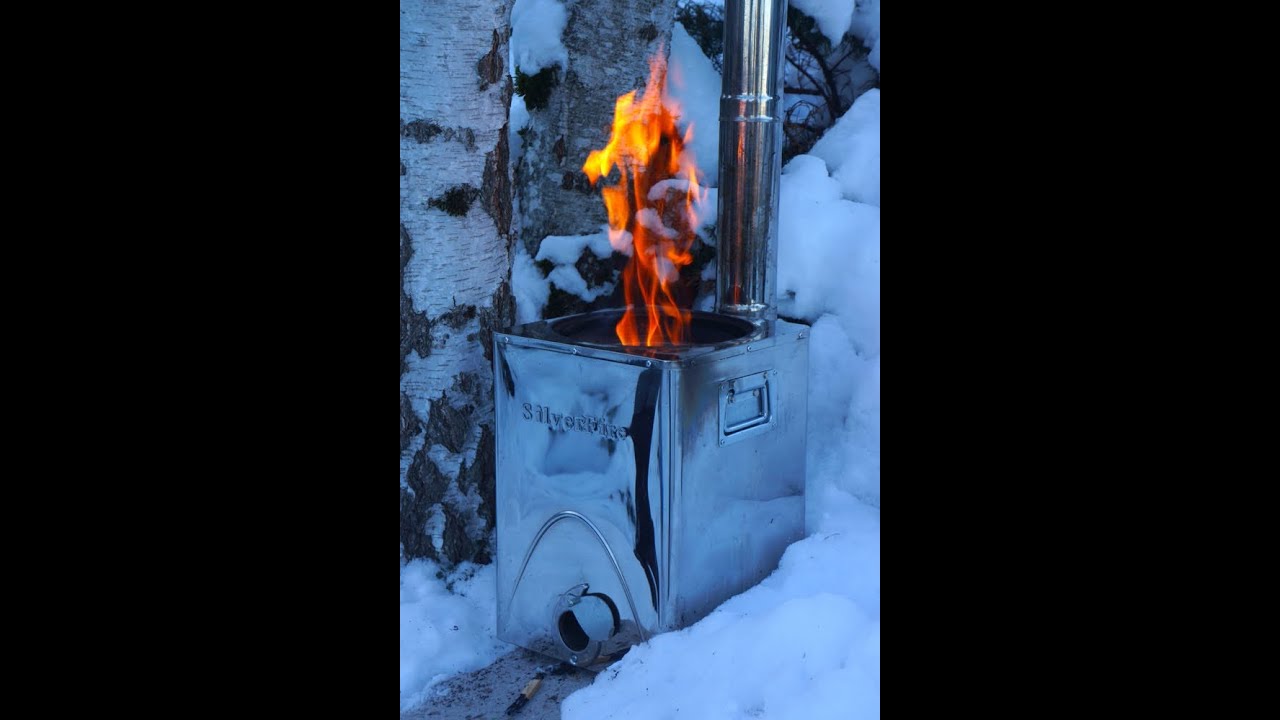

So I came across a video from Engineer 775 on you tube. He was testing out an ‘Indoor Gasifier’ called SILVERFIRE HUNTER. It’s an updraft system. What I don’t care about it is, that he didn’t show if it has a sealable top for it. But I like the concept and it seemed to make sense. I want it to be safe indoors. I don’t think this model is that.

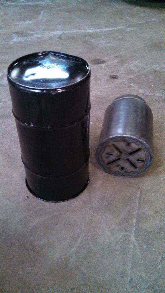

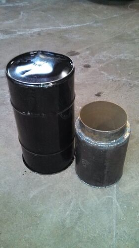

So here’s my interpretation. I think this may be a safer version. I used stuff I had laying around the shop. It will be a small version to proof it. I used a 10" tube 16" tall for the fire box. I drilled 8- 1/8" holes 1" off the bottom of the tube around the perimeter. 10" above the bottom, I drilled 8 more holes for the secondary air. This tube is only 1/8" thick. I have a 12" diameter plate welded to the bottom 1/4" thick. I cut slots in it for the ash to fall through. I then welded a 12" tube about 13" tall to the 1/4" plate to produce a sleeve around the 10" tube. I welded a ring around the top to seal it up.
I plan to weld a ring in the bottom of a 16 gallon drum I plan to place the fire tube on 8" off the bottom. I will weld an ash door under the ring. A 1" pipe will penetrate through the 16 gallon drum into the 12" sleeve to feed the air. Atop the 16 gallon drum I will weld a 1/4" plate with a 10" hole through the top to place the wood. I have a 10" removable plate to seal up the unit. A stove pipe will exit out the back of the unit.
Here’s a picture of the fire tube with sleeve and grate welded on. Also the 16 gallon drum it will sit in.

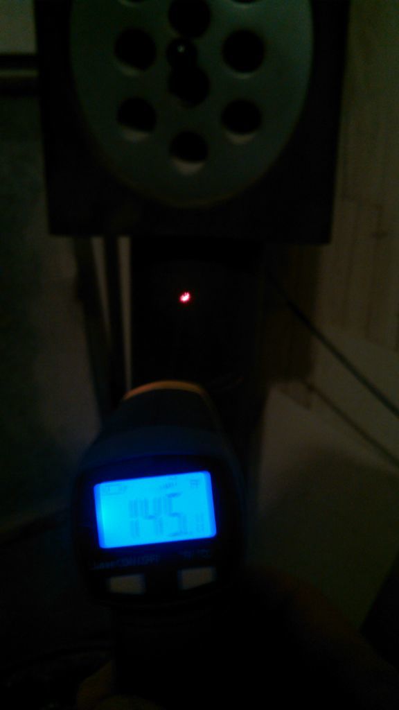

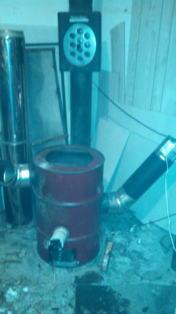

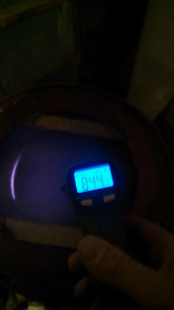

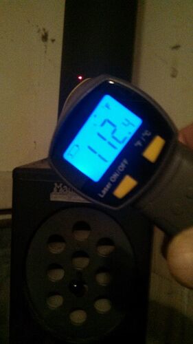

The first photo is the temp of the stove pipe after the magic heat. The second is before the magic heat. The third picture is the lid of the fire tube. the last is the whole unit.
I set a 30 gallon oil can over the top of the 16 gallon can. The white pipe is the air inlet and the fan assembly. I have a booster fan coming in from the right side and exiting the left. My theory is to strip the heat off the 16 gallon can before it exits to the stove pipe.
By the temps can I assume It is running efficiently and just need to figure out the top air inlets?
