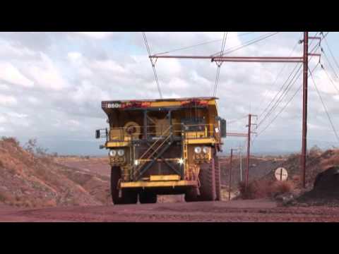

Those trucks are -huge-, someone had an electric version of those about 15 years ago, but it had onboard diesel generation with the main advantage being the torque. In Chile they put in solar and wind farms for their mining operations. They didn’t have a grid to extend into those regions and hauling in fuel was more expensive. They started converting when oil was super high the last time. They use a hybrid system, so they are still hauling fuel, just not as much.
Stuff like these.
Its not new.
Its very cost effective where you have electricity and the right people to up keep the trucks.
This is 1010 Kiruna.
I worked on this particular unit when it was new ( and it aint looking good from this 2011 photo, it must be scrapped by now )
Under the cab was two stack of batteries for when it was not on trolley power.
These are not elegant looking systems, but they do work.

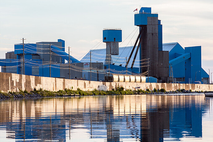

Very few people are aware of it but there are huge salt mines that Start not far from the river in Detroit and run many miles west. When I was an Ironworker out of Detroit I got a job once repairing the elevator that they used to carry equipment down into the mine. Those big machines were completely disassembled so they would fit on the hoist platform and then reassembled down in the mine. Pretty amazing to see.
That extends well into Canada.
Part of the reason we all have high blood pressure and our cars desolve up here is our proximity to that giant underground salt deposit
