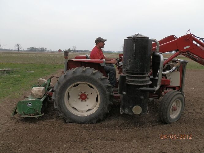

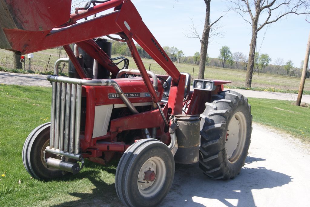

Last fall I began converting a 1978 International 574 a utility size tractor, to woodgas and finally finished!! It has really good power (201 cid engine) I ran a 4ft tiller and didnt have any problem and runs down the road at a pretty good clip. I have a 40kw pto generator ill hook up and see what kind of power output I has.I used my version of the 1981 MEN gfasifier which I have have good success on the truck conversion I did 2 years ago. This was a lot easier than the truck i brought the wg in on top of the carb and it is easy to control.

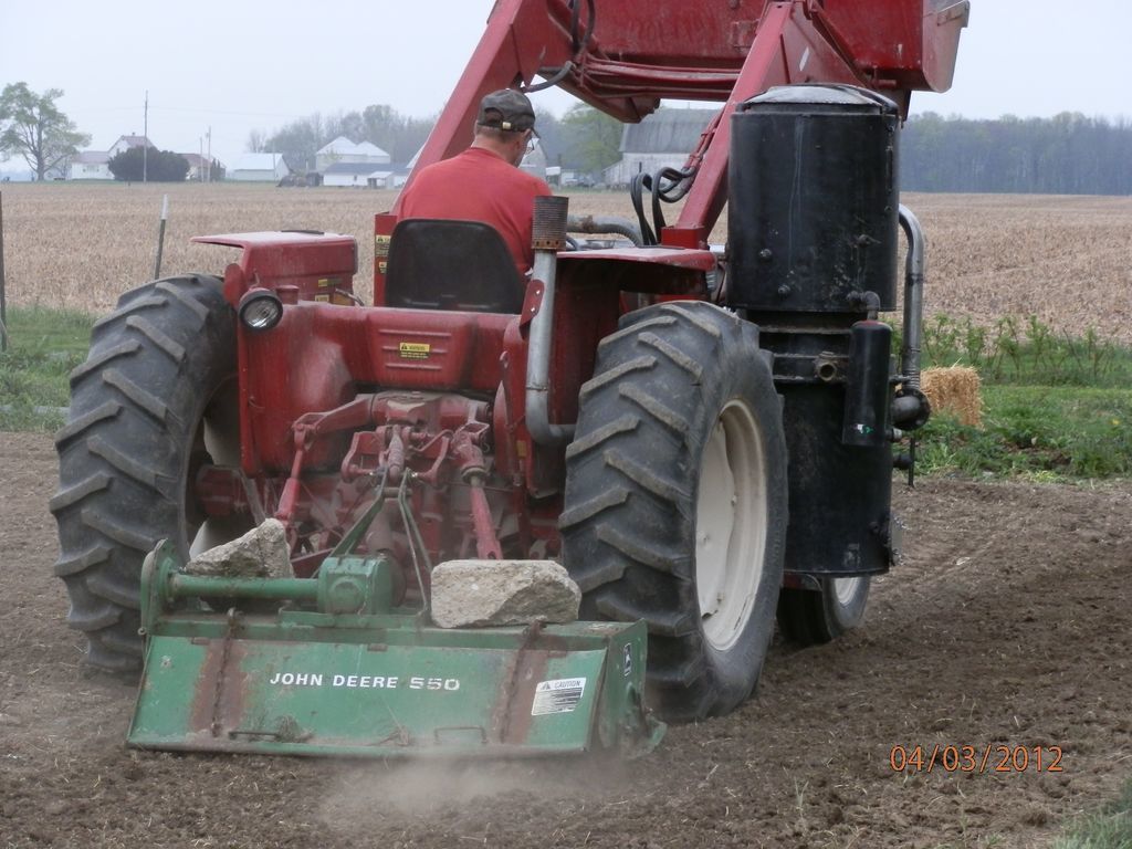

Nice job Ron! I have a 550 tiller just like that. You got quite an angle on that pto shaft!

Thanks for the compliments; you are right there is quite an angle on the pto, the tiller came with the tractor and is only 48" wide and I have to push it over to cover one set of tracks to keep the soil from being too compacted by the tires. The tires are fluid filled so it is pretty heavy but has excellant traction.
The fuel hopper holds about 80 lbs, and I have run two tanks of wood so far. I would like to hook up to a pto generator put a load on it and see how long and what kind of load it will pull over time.

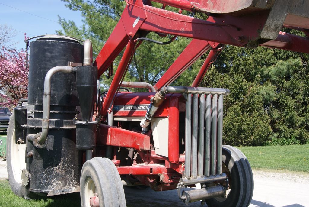

Looks great Ron, whatcha got in your filter?

Hi Terry; For the filter I am using fiberglass batting, I have used this for about 10,000 miles on my truck and have had good success cleaning the gas.When it starts to get full it will burn in the stove, also it is a hot filter that way you doesnt get the moisture for the soot to stick to plug it up. I put 3 layers of fine expanded metal on the bottom to work as a spark arrerster and havnt seen any burn spots in the fiberglass and one piece on top to keep the vacuum from sucking the fiberglass into the intake.
I havnt touched the timing yet and it still has fairly good power. I am thinking about putting a lever near the column to adjust the timing back and forth gas- woodgas. I set the throttle at 1800 rpms and the governor holds it well even when shifting it wont let it overrev.

I have been thinking about your comment above about the filter batt - “When it starts to get full it will burn in the stove,” My question is full of what? I can envision both tiny char pieces and or tar burning. I hope not tar! You said that the hot filter won’t plug with soot because it is dry, and soot doesn’t burn anyway. Where does your moisture go? What size fuel chunks do you use? Do you start and stop with gasoline? You did a nice job of running lines and tucking everything in close.

Ron, I just took a closer look and saw the condensate tank under the radiator. Thats where the moisture goes.
Don M
Hi Don, the filter fills with soot and there is probably some tars from start ups, the flairing smoke comes in and out the bottom of the filter , but the fiberglass does burn.Yes the condensate goes in under the cooler but it sofar doesnt get much in it.

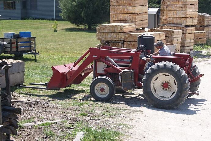

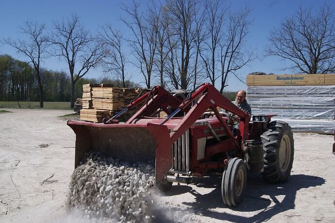

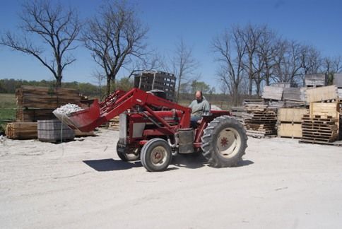

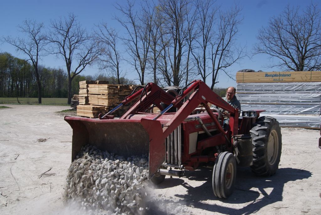

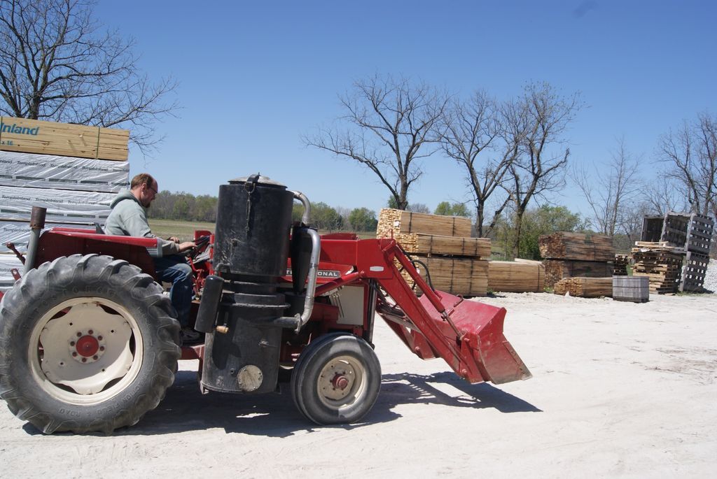

Hi; Thanks for the honor of being featured this month. I have been really busy with work. I am posting a few pictures out of my tractor album. When I get time I will post some new ones. I had a pair of forks made for the front of the bucket. It will be interesting to see what I can pick up with them.
I have made some changes to the unit. When I built the unit the filter was to be a dry hot filter but, the gas was too cool. I found the gas was too slow and the cyclone was not working so I took out the cyclone and several feet of piping. It seems to have solved the moisture problem. I was concerned when I put the filter in front of the radiator that it would cause the tractor to run bot. It is working really well like it is.

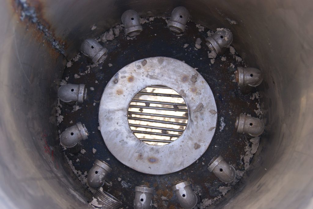

Hi Matt. the nozzle ring is 9" and it make good gas for the motor, but overall it is a bit large I could cut the fuel hopper in half and it would still be plenty large. I have been having a problem with the fuel bridging above the nozzles.

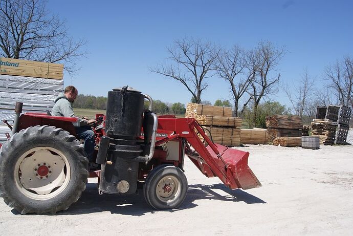

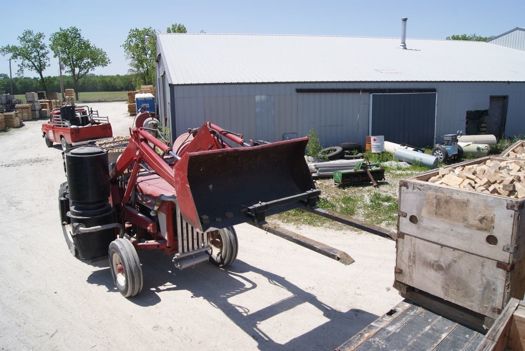

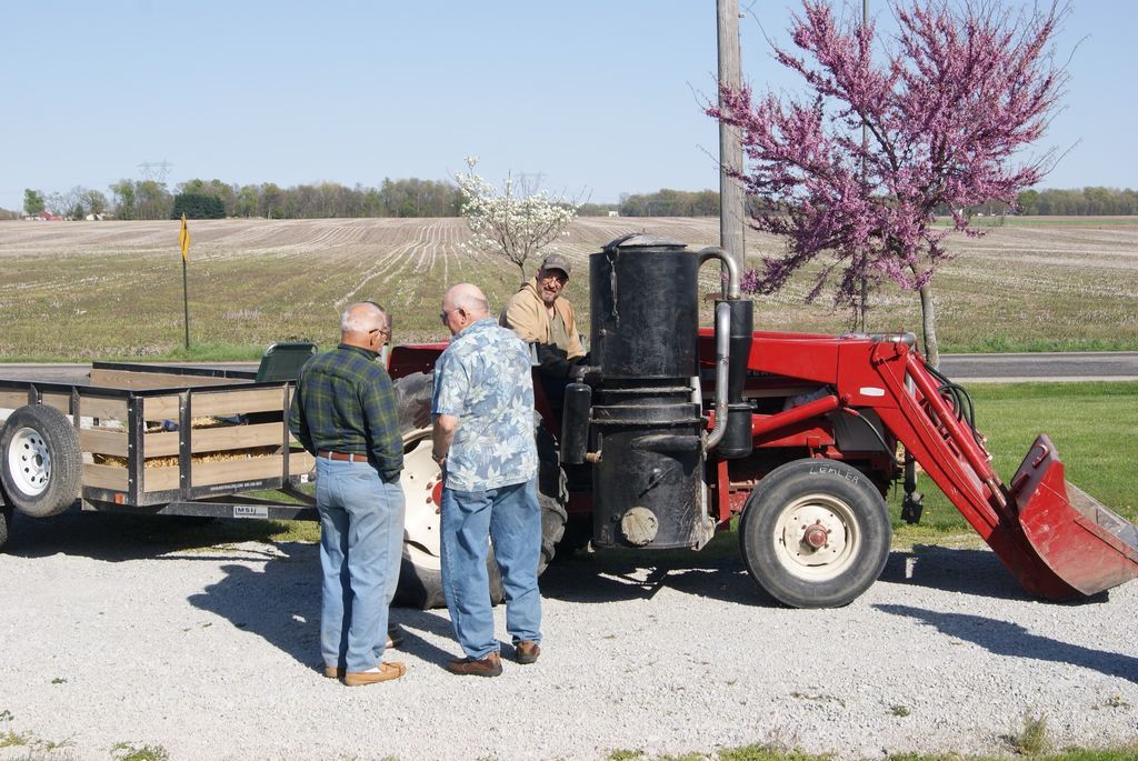

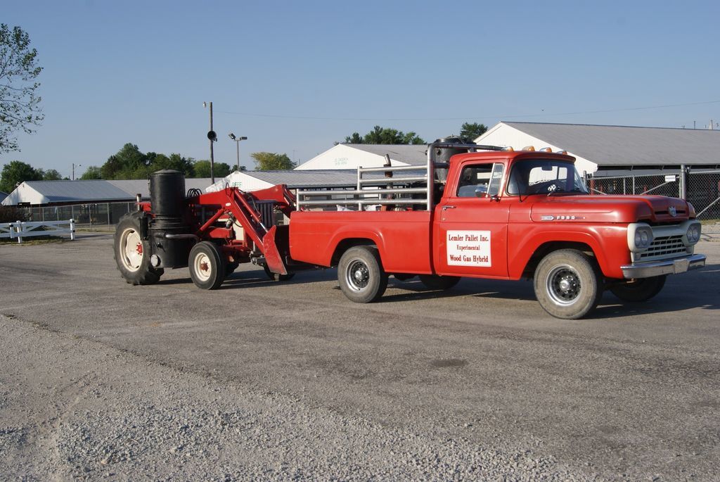

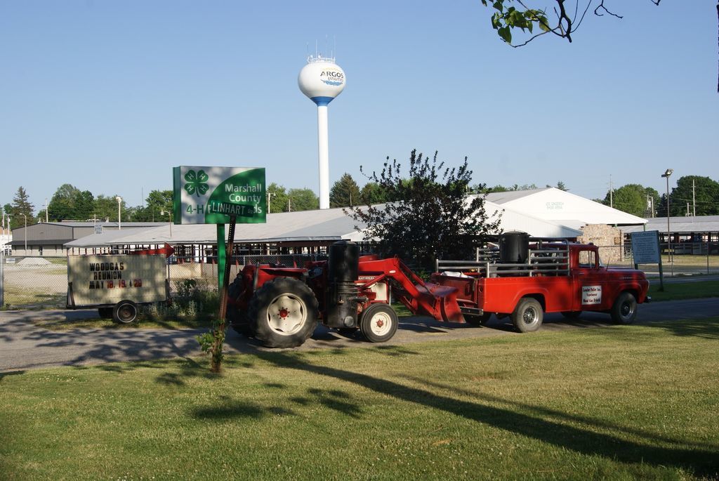

We have the truck loaded , hauled the tractor to the fairgroundsand ready for the meeting tomorrow.
Towed the tractor about 20mi on wood it pulled pretty easy only went 35mph but we made it.

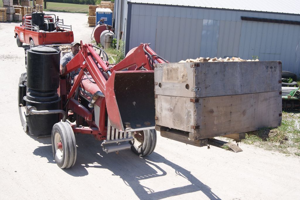

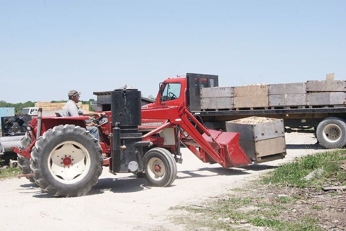

Put some forks on the tractor and used it to load the woodgas fuel they worked good but couldnt see the end of the forks not east to pick up Tomorrow is the big day looking forward to it

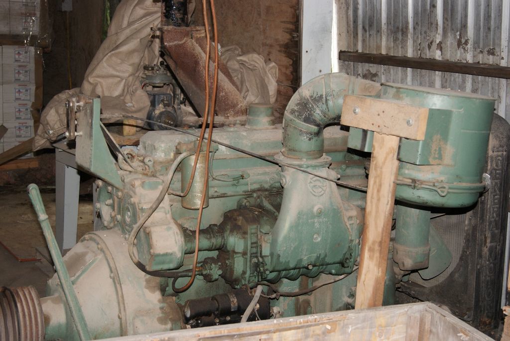

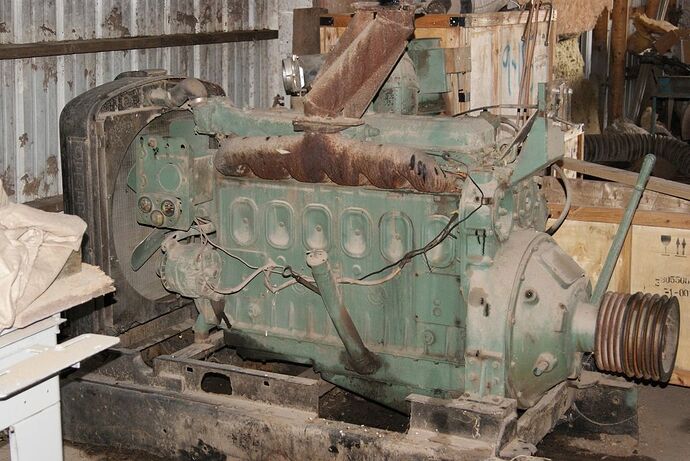

I had a detroit 6-71 hooked to a 44" scragg mill and it did ok i only sawed a dozen logs but the gasifier was way undersized and I knew it.

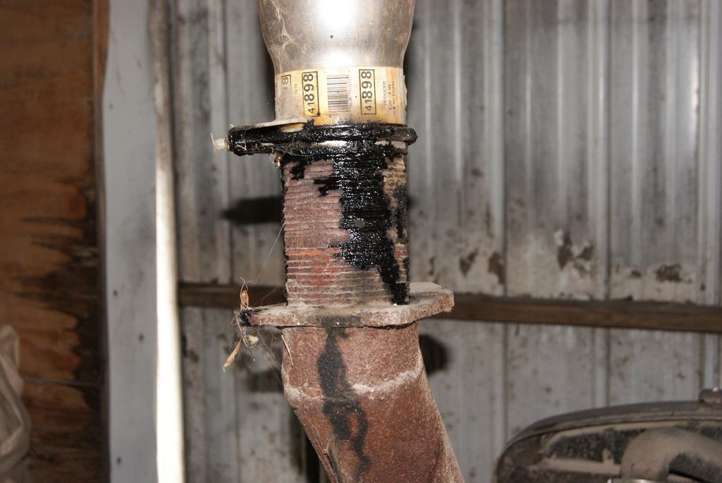

It did work though I just started it on diesel set it to idle and added woodgas through a dust collection gate before the oil bath filter this is a 2-cycle motor also.. here are a couple of pick on the first you can see the dust gate this set the pto speed.. on the one you can see the tar i was suprised it didnt hurt the engine these ar very resilient diesels. My main concern is soot building up on the turbo and making it out of balance thie old diesel has a roots type blower and didnt seem affected by it but I only ran it for 4 hours
Hey Ron, If ya get a chance could ya post or email me a few pics of your fork hookup to your bucket…I am looking to do that on my JD. Thanks
