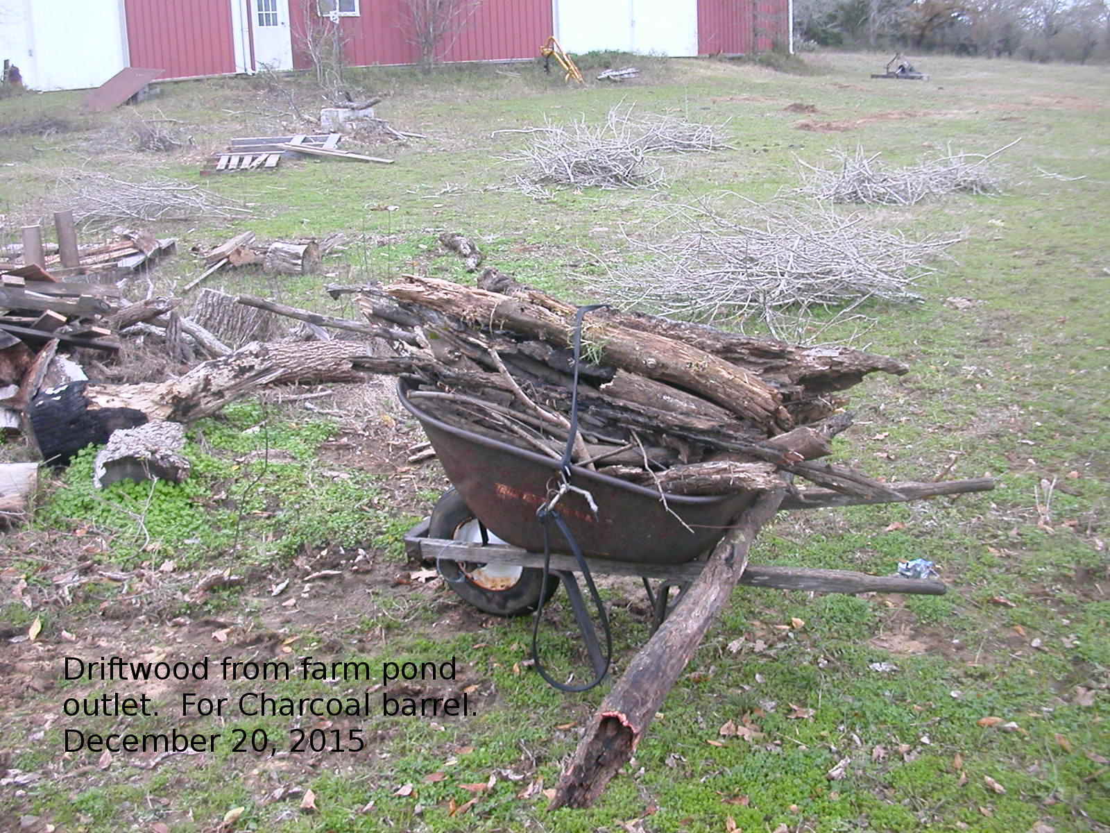

I seem to be always hunting for wood. Yesterday I gathered a wheelbarrow full of deadwood (maybe I should call it “driftwood”) from the overflow areas of my two farm ponds. Behind the wheelbarrow in the photo are the small branches from a tree my neighbor cut down.

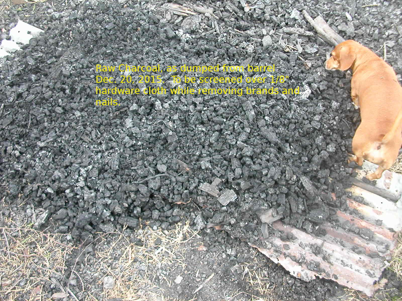

After I make charcoal using Gilmore’s two barrel method, I get a pile of charcoal like this.

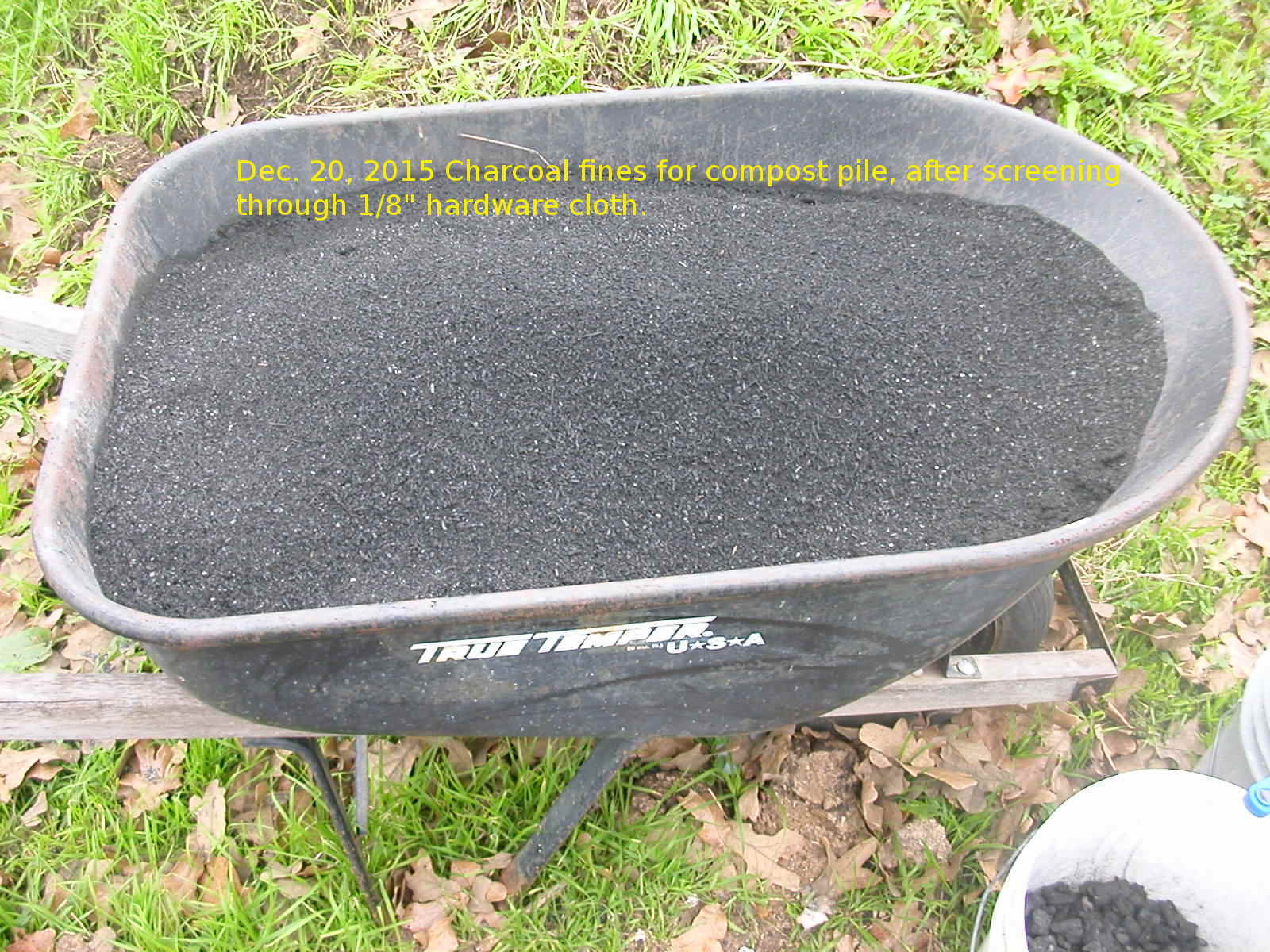

Then, I use a large scoop shovel to load it onto a frame covered with 1/8" hardware cloth where I pick out any nails, stones, brands, or any little pieces that didn’t get converted to good charcoal. (The good charcoal larger than 1/8" is stored for future use.) The next photo shows a wheelbarrow of these fines which then get mixed with my compost piles. I turn this compost with a front-end loader until it is “done”, and then it goes into raised beds in my garden, or under freshly planted trees, etc.

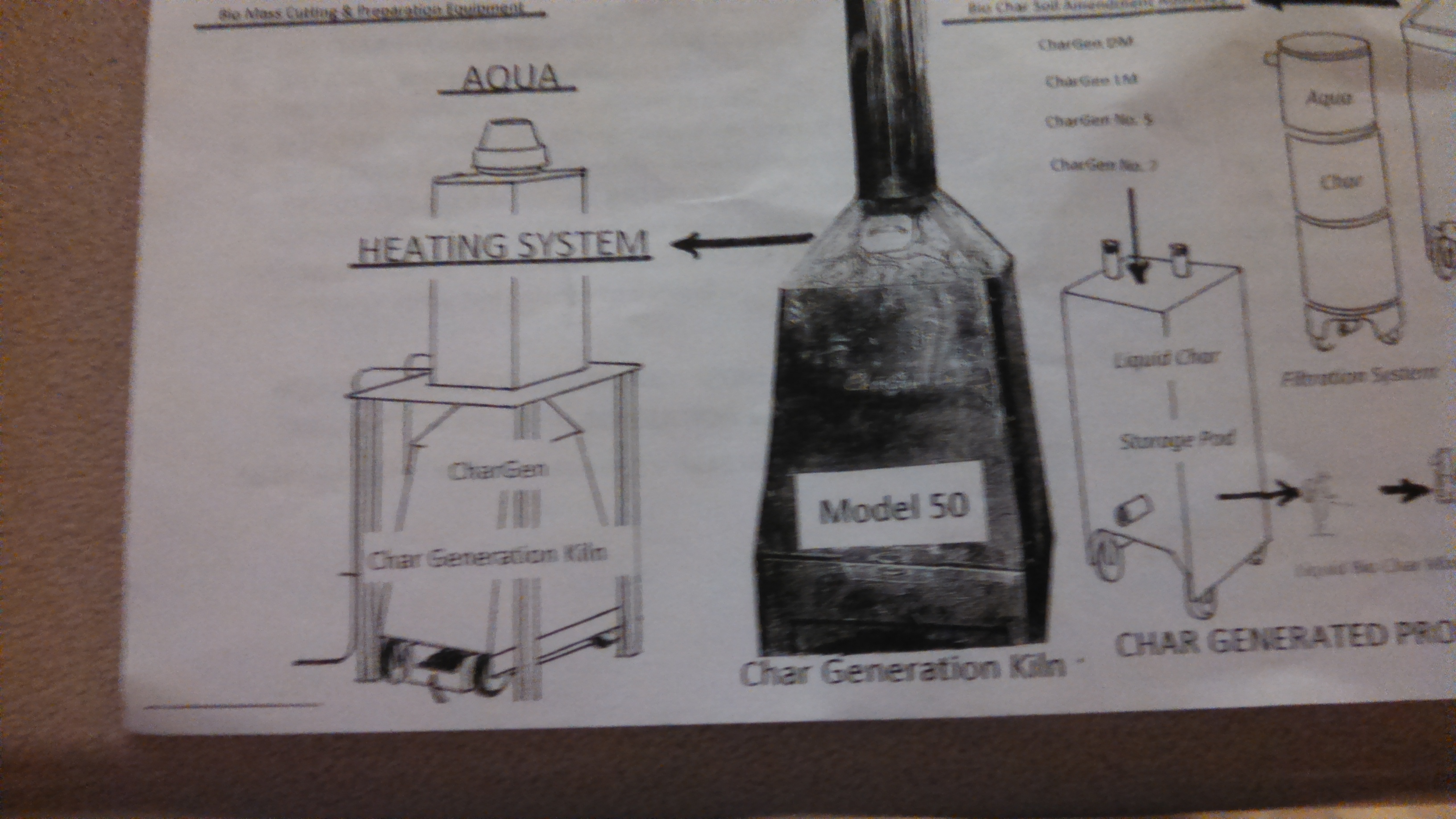

This is a partial pic of the flyer

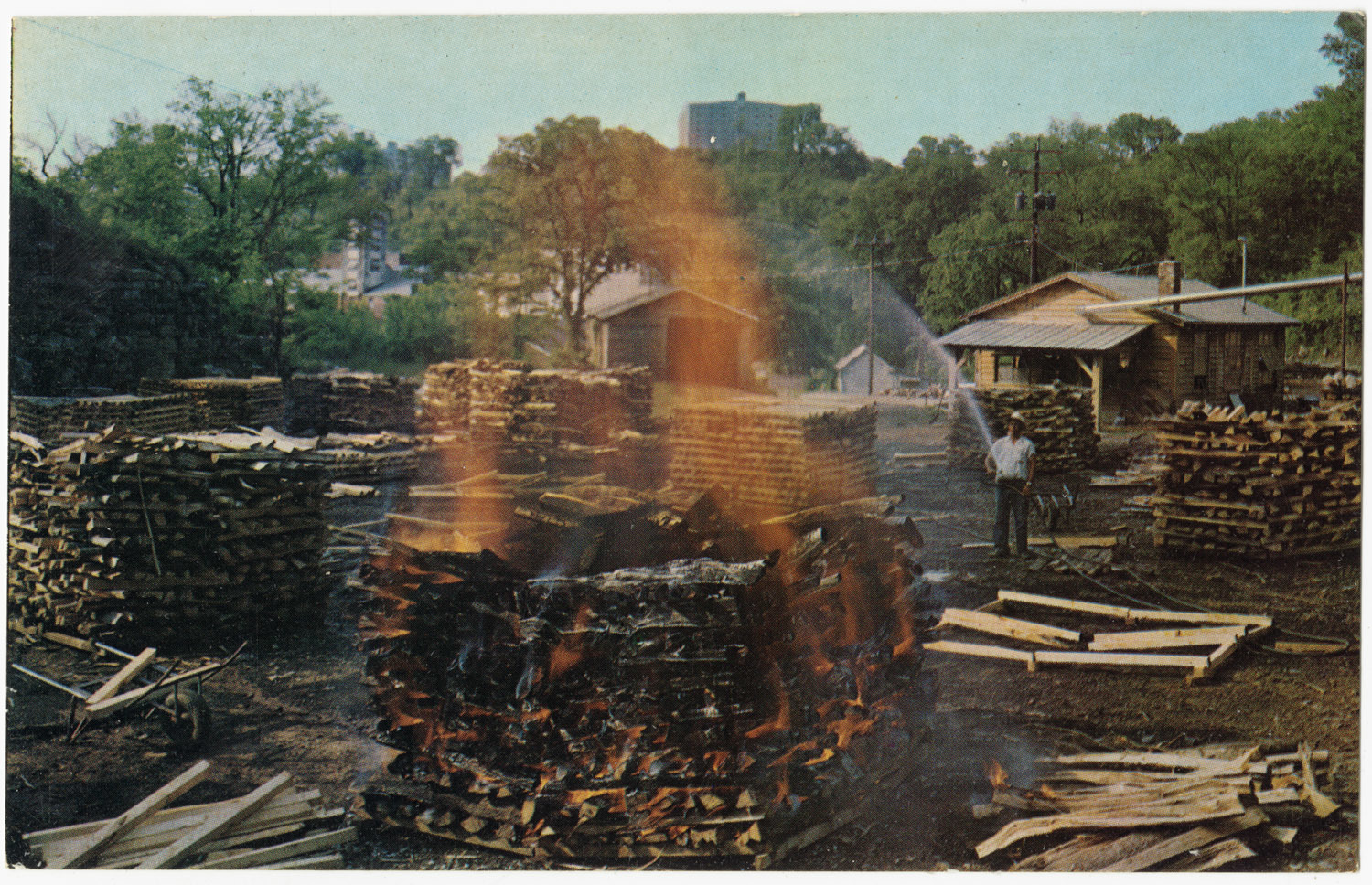

Might check out the Jack Daniels charcoal making process. They stack the boards in criss-crossed layers and light them off. see photo.
I imagine it would take a large amount of water to prevent the charcoal from burning to ash.
That Jack Daniels picture is about what I was describing. Those stickers will work great in a big pile like that. The pile burns down to 1/3 of the volume of the original pile and then as you “work” the pile and it gets down to just hot coals, it is a little smaller. That JD pile will work down to where you can put it into a 55 gal drum and slap a lid on it and in a day or so your ready to go. Work the pile with a rake until all the “sticks” are broken down into chunks of char. If you are out in the clear where you can burn, cut the 12 ft bundles into and use 6x6x6 stacks.( that was the size that zoning allowed me to burn and don’t worry about smoke if it is coming from a cabinet shop. It will burn hot and clear after the first few minutes.TomC
