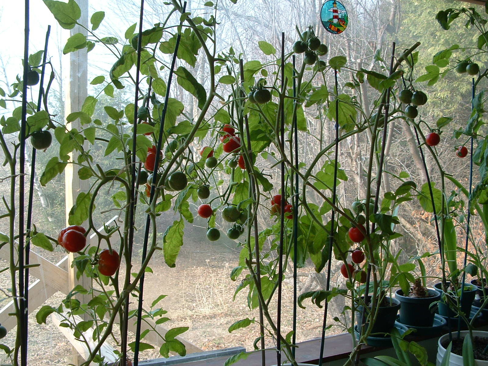

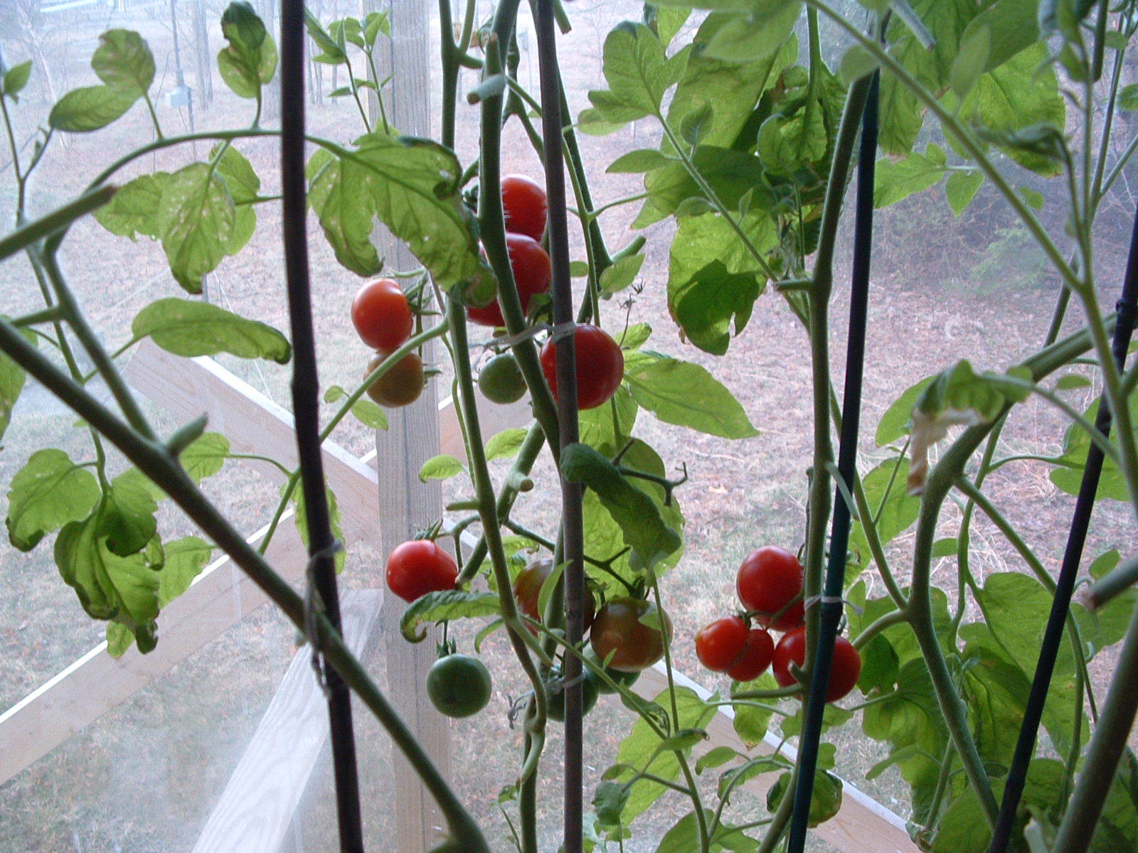

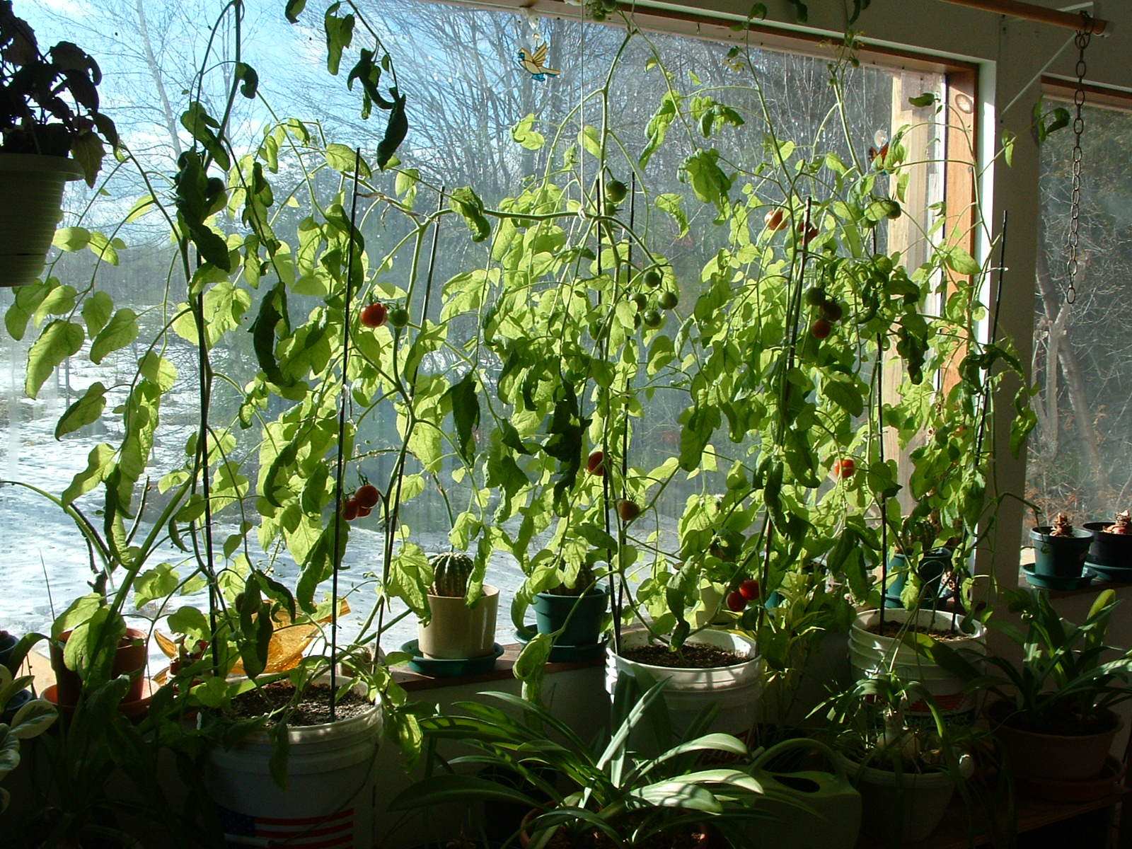

I share your desire to grow stuff in the off season. I had big plans for a greenhouse attached to the south side of my home. That’s still a dream. Building a greenhouse involves a lot of prior planning to get the max efficiency from your investment. I do however have 2 side by side 54"x 96" thermopane windows in my LR on the south side of my house. I have quite successfully grown tomatoes all winter without artificial light. Production may take a little longer, but they will ripen. Tomatoes have to be hand pollinated indoors. This is simple. Take an artist’s brush and “tickle” every flower tip center every day to pollinate or the flowers will just drop without forming fruit. These are a small (2-3") variety called Bloody Butcher. I haven’t tried any larger varieties, but these sure beat the totally tasteless, hard as a rock, store bought crap. Yes there are pics from 2 winters.
These made it through the winter. This is mid April and the production has been like this since the beginning of Feb. Once these plants start fruiting, it is continuous. They are indeterminate, so you constantly prune for new stems, thus new flowers/fruit. Watch early on where the flower stems emerge so you don’t prune those stems off.
