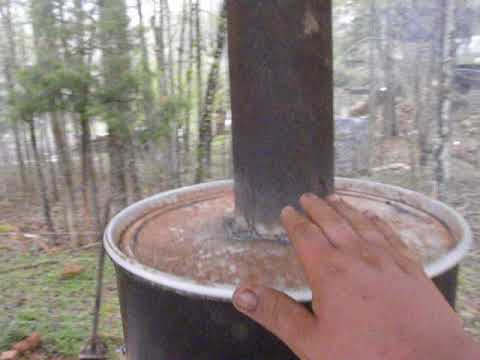

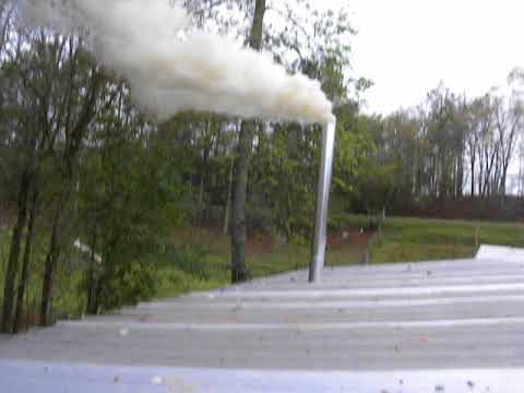

The first batch only pyrolyzed about 80%. All of the smaller chunks were perfect. Some of the centers of the bigger stuff were not quite done. Also a few pieces around the outside of the barrel. We are thinking about adding a skirt around the barrel to hold the heat in better and help cook the wood on the outside.
The second batch cooked for 50 minutes and burned down farther. It was left to cool over night.

After a couple of runs you will get to know how long to cook it etc. I found that if you see smoke and f!ames, your charcoal is not ready to be cooled and needs to be cooked
Until no smoke andI yellow flames show.

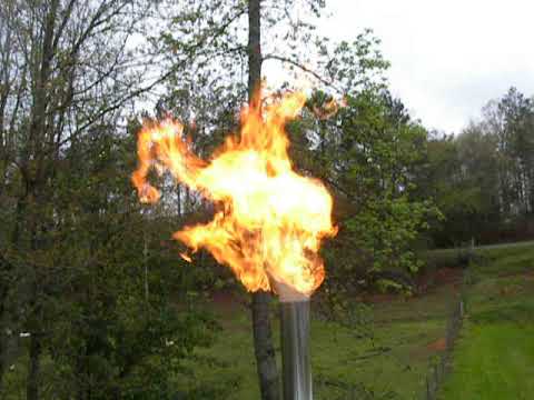

The grinder is working quite well. He loaded the gasifier and tried to start the tractor today, but ran into some problems with the tractor that he’s fixing. Wiring, etc. But he made really good gas and had a beautiful flare. His water drip worked very well—atleast with the blower.

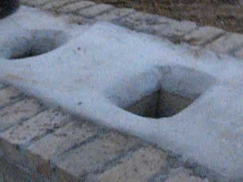

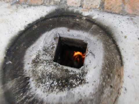

Hi Jakob , A question about your drum of wood that you are turning to charcoal .
you are sitting that 55gal drum over your rocket stove bench ( fantastic idea btw )
so i guess the bottom of the drum must have a hole that lines up with the rocket stove furnace , if so that means you are burning straight up into the barrel and burning the wood inside from the bottom i guess ?
Yes, There is a hole in the bottom of the barrel about 12" dia. Then I tack welded a piece of expanded metal over the hole to keep the wood and char from falling out. I am making several barrels like this so they can be rotated through the process. A 9 year old boy up the road wants to learn how to weld, and he bought himself a little wire feed at Harbor Freight, so I am teaching him how to weld and letting him build my barrels at night after he gets home from school.
okay, that is pretty sweet. It reminds me of the costa rica biochar groups Hornito, but youtube blocked the video I think because of the background music. It isn’t exactly the same but the 3 holes and the continuous batch process you are planning is pretty similar.
You might think about insulation on the outside of the barrel.
The grinder is awesome.
We are considering a secondary burn up top to help with the flare. And also, a possible clam shell shroud for the 3 barrels. That would help keep heat on the outter wood in the barrel and also the barrels could share heat. Speed up cook time.
