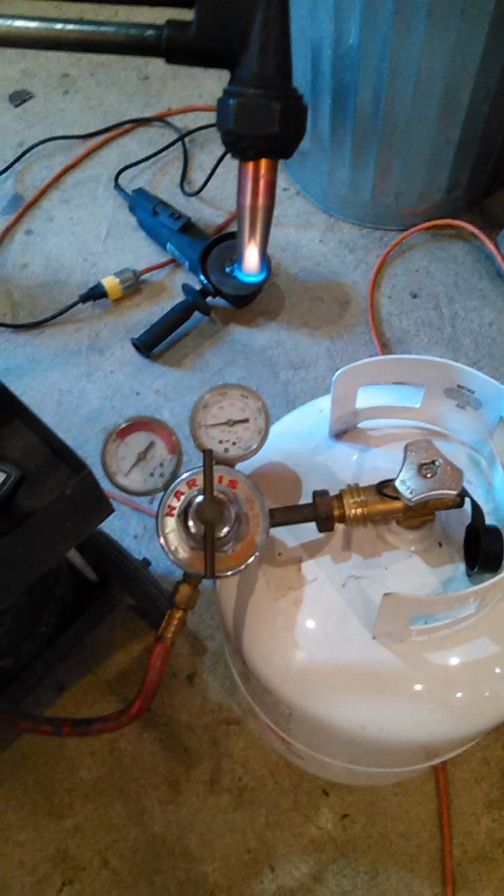

Acet is dead, long live propane. I think propane works better.

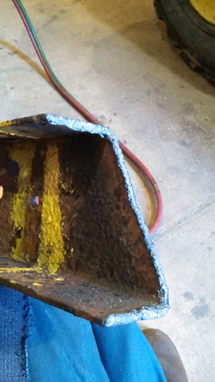

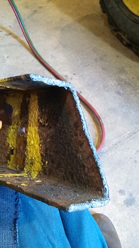

And with time I’ll get better at it. The propane nozzle works nice. Not much of any sparks and no trash on the floor. Must really burn the metal.

It’s been a long time ago that I used propane in a torch. As I remember though, it was much harder for me to get a nice neat cut. I could at that time make an almost machine smooth cut with acetylene but blubbery with propane. It seemed like the heat spread wider (Less focused) with propane.

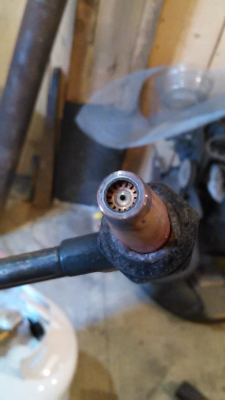

Oddly I’m able to cut as well or better than with acet. Maybe the new nozzle. This 000 makes a narrow slit. It took a few chops to get the feel and I need more practice.
I have used propane for 40+ yrs. ran a 4 head pattern torch on liquid oxy. and propane cut smooth as glass even on 3’’ thick plate. The most important things are to preheat(especially thicker stuff), and to match tip size to work.
