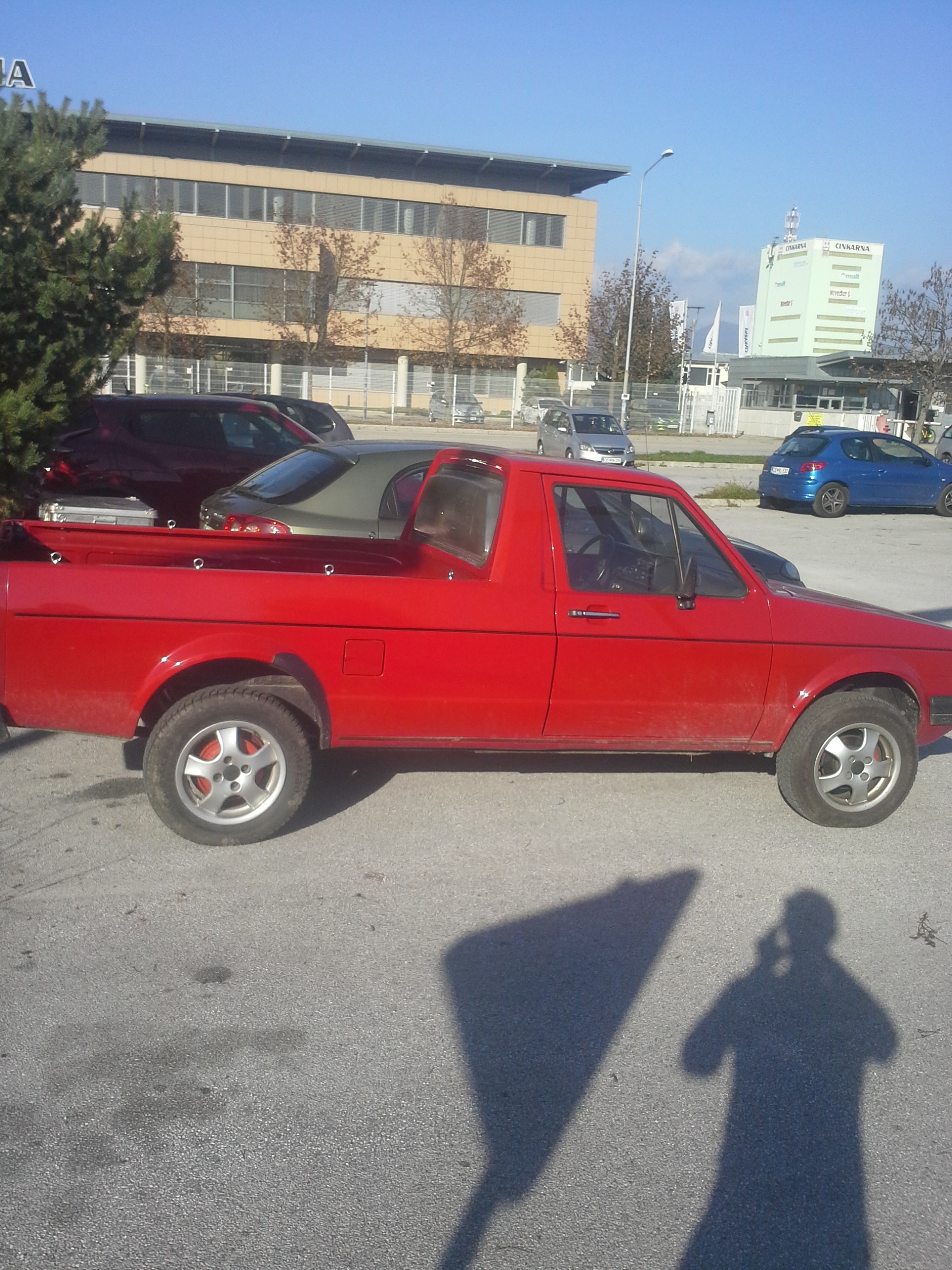

Look, a rabbit parked next to me this morning! It was in spotless condition! If it had at least one more seat l wuld buy it imidiatly!
Aaah, what a beauty!
Agree on the seats. If I ever find time to woodgas another vehicle I think it’ll be a Sunday sedan.
I forgot to ask… Is your rabbit German or Yugoslavian?
I can’t tell for sure but from what I’ve read only Jugoslavia continued production of MK1 into the 90s and then someone bombed the Sarajevo plant in 92. Mine is 1990.
Does it have a plate TAS anywhere? This stands for Tovarna avtomobilov Sarajevo; meaning its Yugoslavian.
This one on the picture has it. They say the Germans have better corrosion resistance.

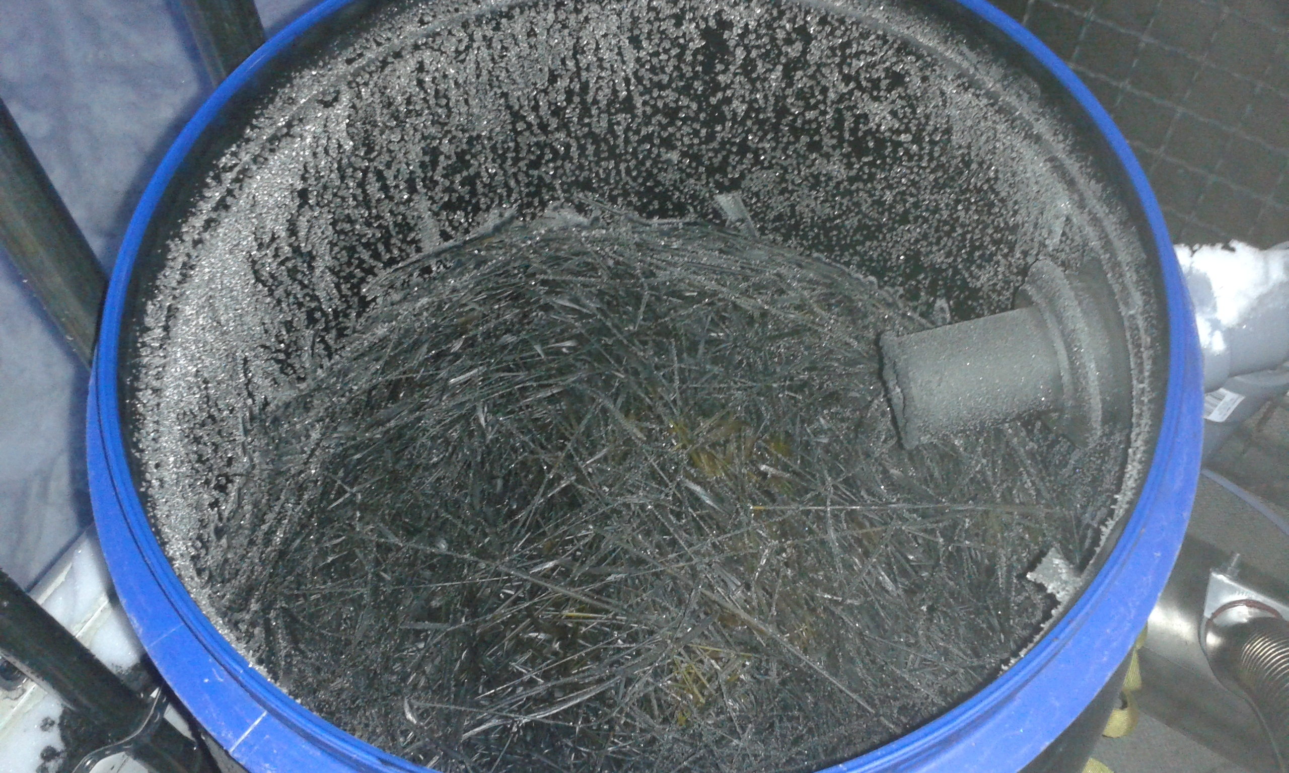

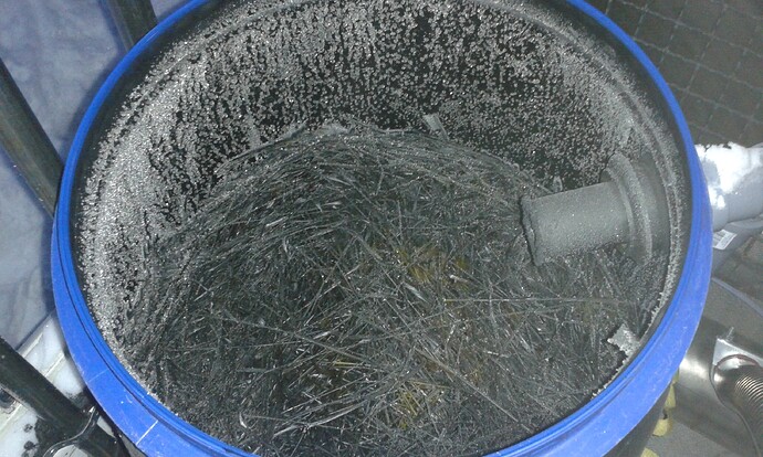

Did some maintenace when I got home, incl a wash down of the hayfilter. Picture below. Shows condensation freezing towards the barrel walls.
Dark caught me when lighting the intake. When rappidly opening the plates I could see glowing in there. Good to know. No ruff running though. I hope it burned clean.
