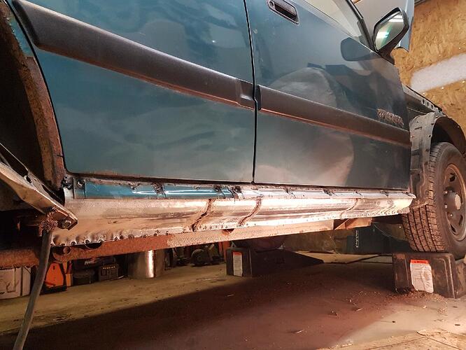

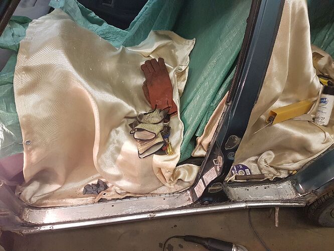

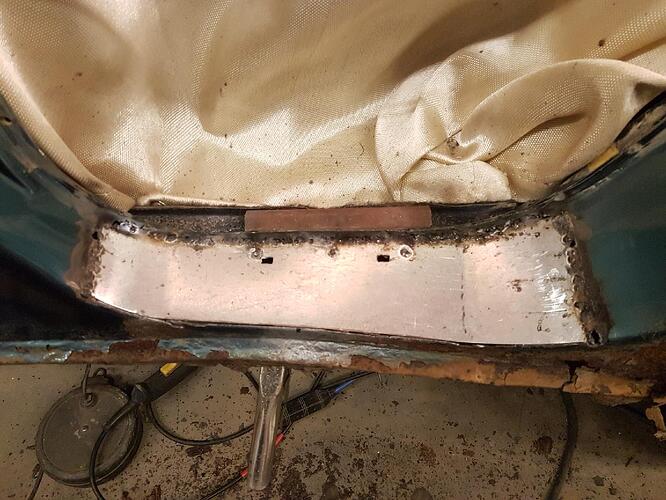

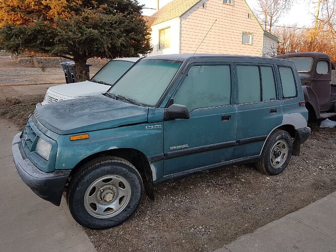

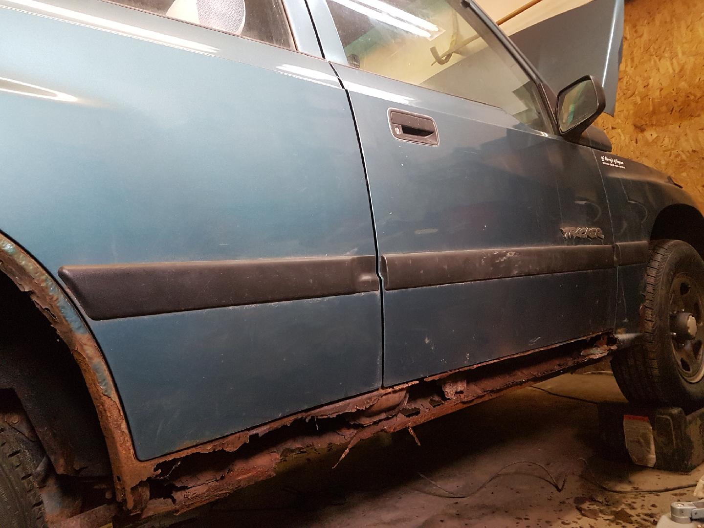

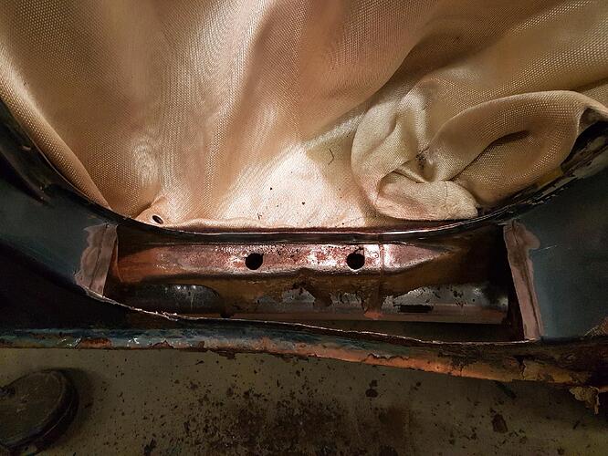

That’s a time consuming job. The main challenge is to cut back to weldable metal, as the body panels were thin to begin with and the rusted metal is only part of that, plus the rust will oxidize the weld material. I used 18ga galvanized steel, paper patterns, a pneumatic lapping tool, and a spot welder. A lot of work. At least you only have single door thresholds, and short rocker panels. And probably simpler design rocker panels.
Wow Garry, that’s a lot of rust on that Tracker. Nice work.

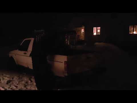

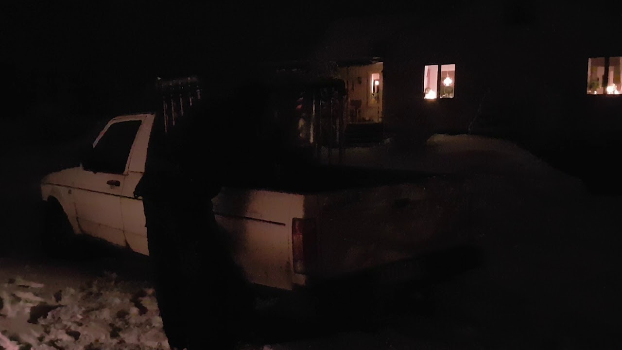

Well, I went for the no:2 dicision. The Rabbit gasifier, piping, valves, cables and everything is mounted back on. I´ll be running for another month and will attend to the Mazda in the meantime.
A short DOW just to see that everything is OK for going to work tomorrow.
That’s the trouble with rust, by the time it starts to perforate, there will be large areas that are just behind it. Fortunately the floor pan was intact. Rocker panels, and any mud traps, are the problem areas. Drivers side floor pan, salty snow coming off winter boots.
