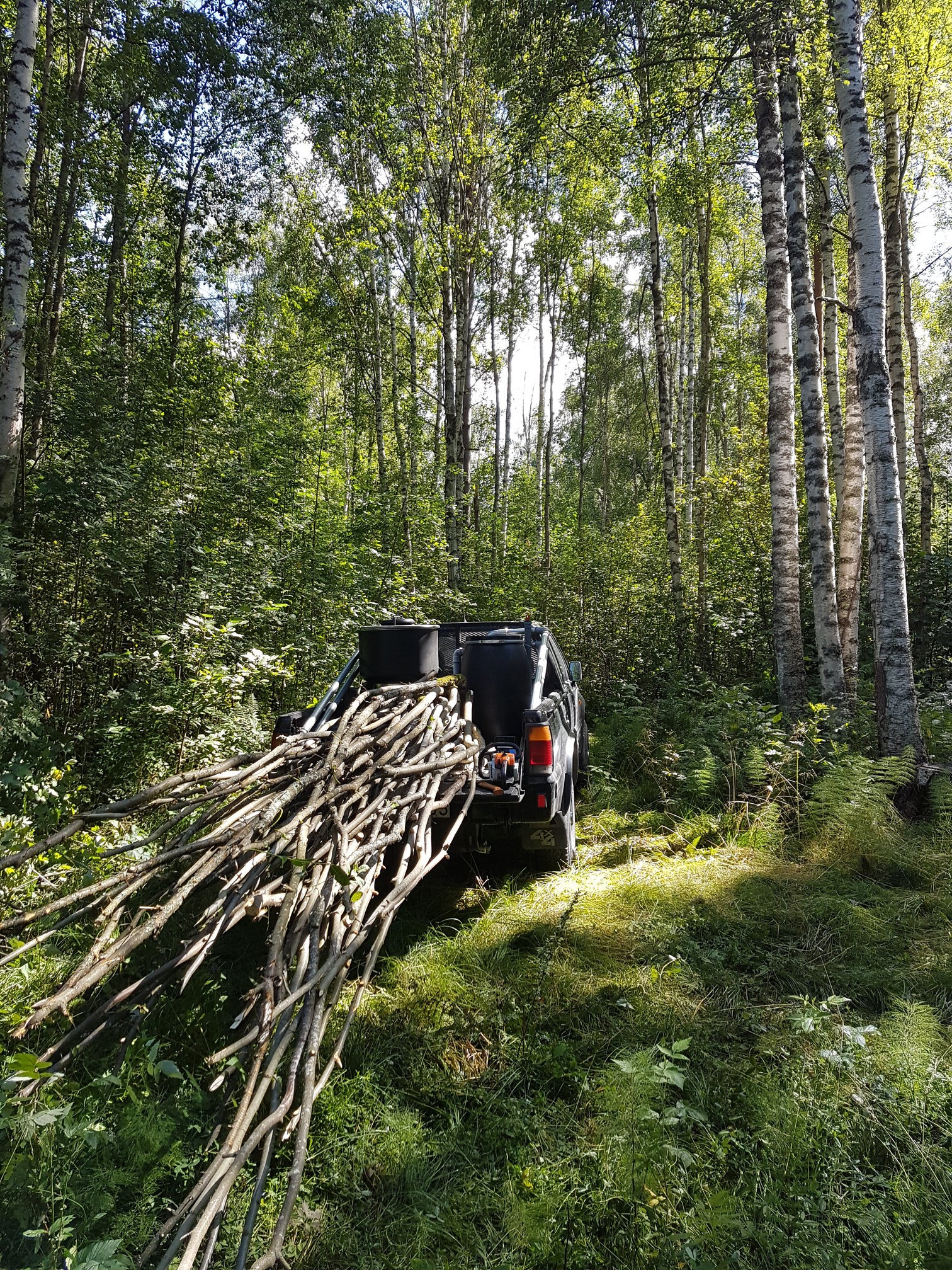

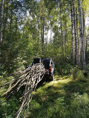

Today is Sunday. Hatchet and I spent an hour in the church of our own.
Later on wife and grandson sneaked up at me by the chunker.
I love the Creator’s sanctuary you have there. It’s the best place to be on a Beautiful Sunday. You really can’t call it work can you, when you are there in that kind of place.
I agree, you can’t call it work. Sometimes you feel the need to be alone for a while. Something has to be seriously wrong but this is the most relaxing activity I can think of.
And all the time I thought something was wrong with me because I enjoyed splitting and chunking wood :joy:
