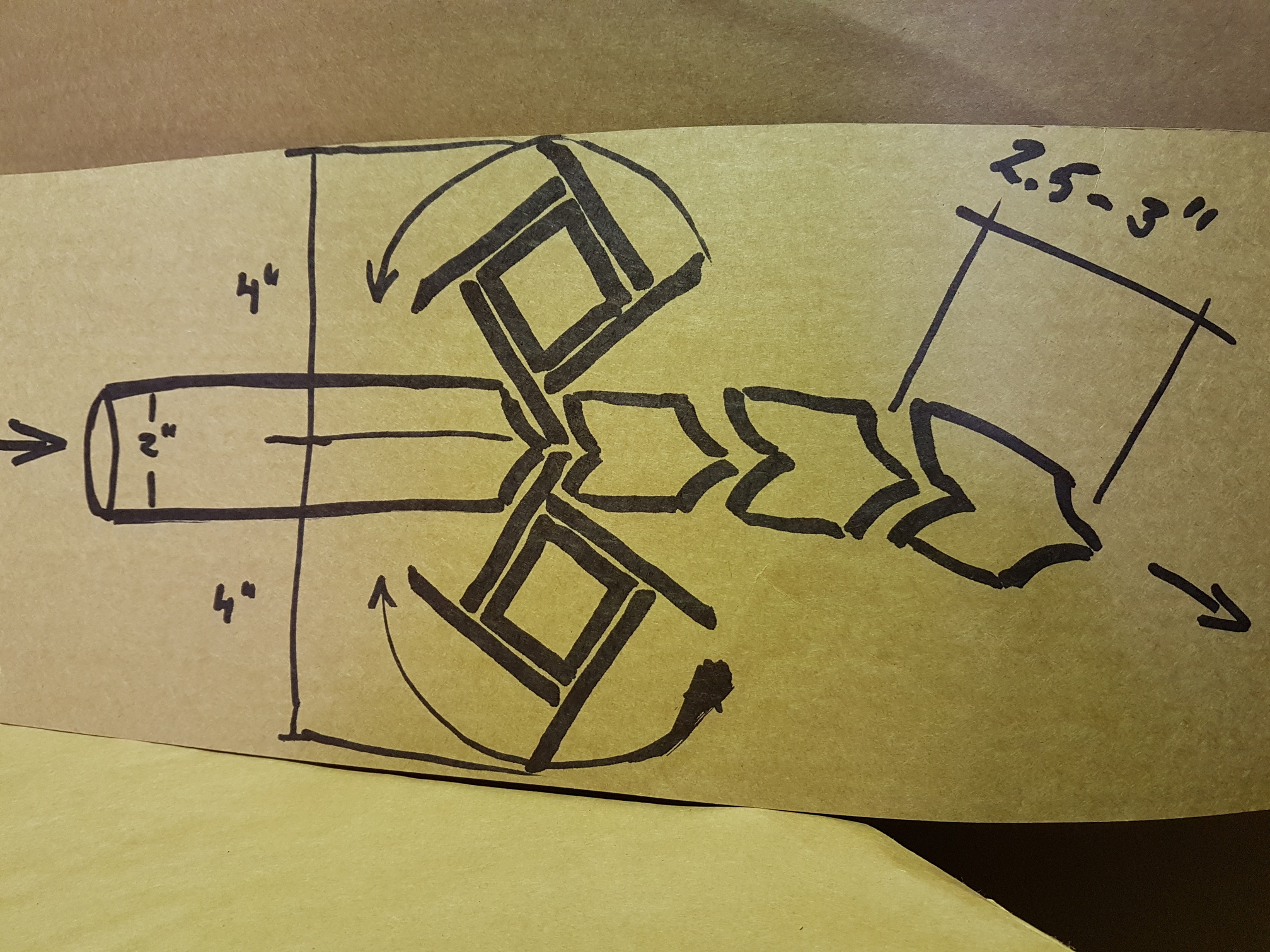

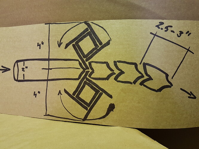

JO Sorry for stepping on your thread. To keep it honest, I will ask the question that came to mind while watching your chunker video. I had forgotten you had a single bladed shaft, in designing your rebak how did you get it to, or know if it would make those about perfect egg size chunks. Sorry for the intrusion
With 4" diameter gears the perimeter/4 = 3" chunks. With sturdy limbs the chunks get a little shorter.
Looks something like this.
Thank you for the answer and drawing. In the video, I thought it looked like you only had one cutting shaft, so I went back you you first posts in this thread, and low and behold, about the 7th posting I found I had asked and you had answered the same question. I apologize for the duplication. It is happening more often that I see pictures in a post and think, “Gee, I hadn’t seen this thread before” I go back to the beginning and read through the posting and come across some by a TomC. I think, “how did I make such a sensible statement?” TomC Sorry again for the duplication.

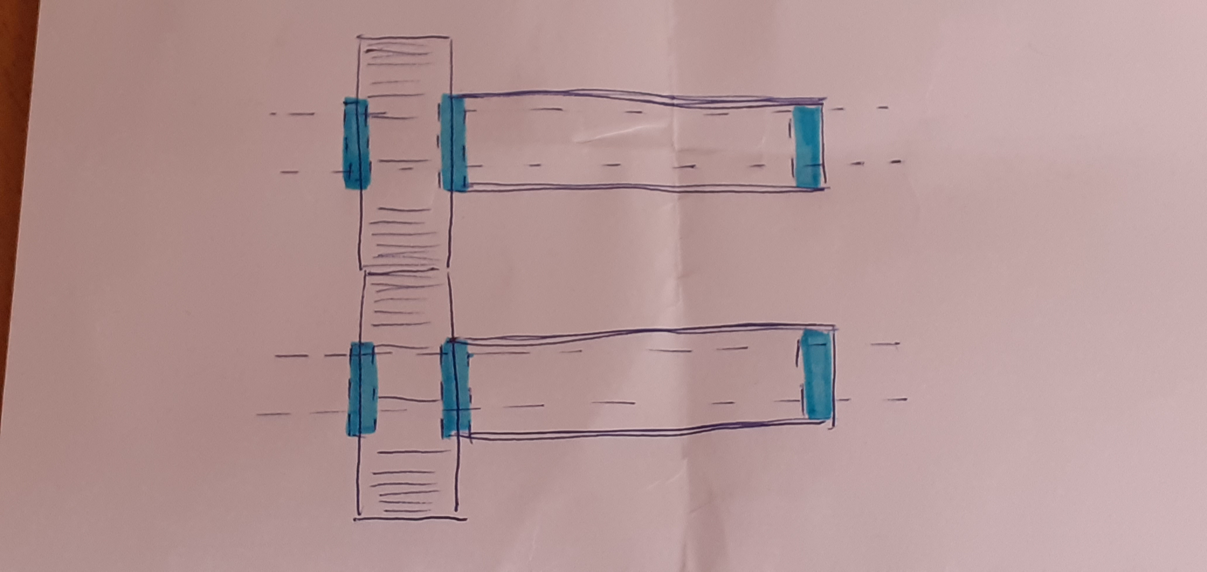

Good evening Jo from sweedon, thanks for posting all the info on rebak chunker building details, On second thought that chunker size is actualy optimal, as any bigger branck’s and i would end up digging through the pile looking for all the chunks that need the hatchet too be correct size. i was woundering what diameter your square tube shafts are, too end up with those size chunks, And could you draw me a pic of the bearing too tube shaft design, i dident get that you said about pressed bearing on the square tube shafts? Thanks again Jo that chunker is a real time saver too get right size chunks.

About the bearings. The only reason I went with them inside the square tubing was my gears happened to come machined for bearings to fit inside them. That determined the size tubing I had to use. I think they are 60 mm (2 3/8 ?).
