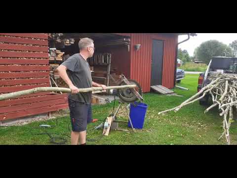

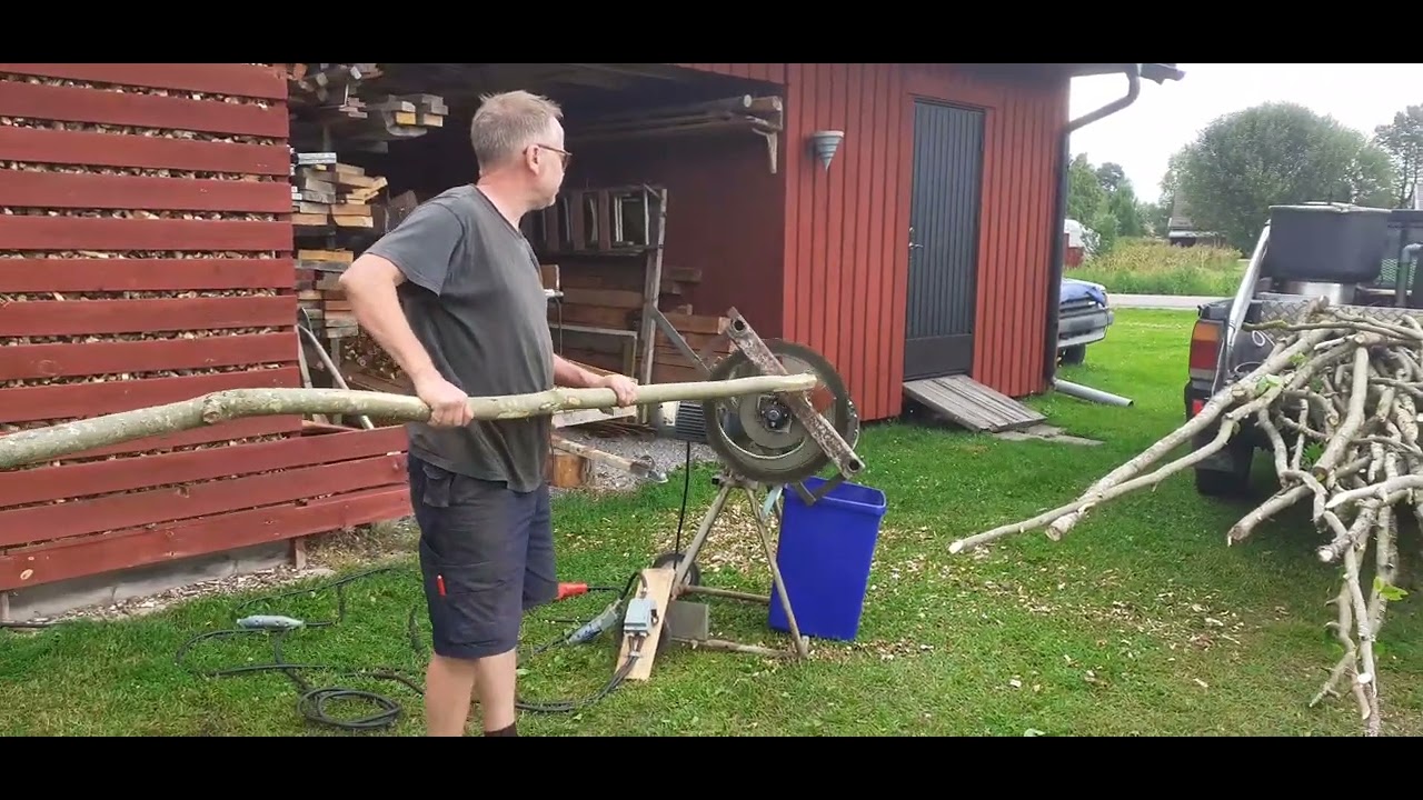

What does your long haired photographer say about keeping bearings in your underwear drawers at 4:10 in the first video? :grinning:
Downright genius, JO.
JO, l like this wery much! But now the queations!

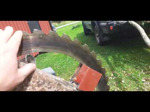

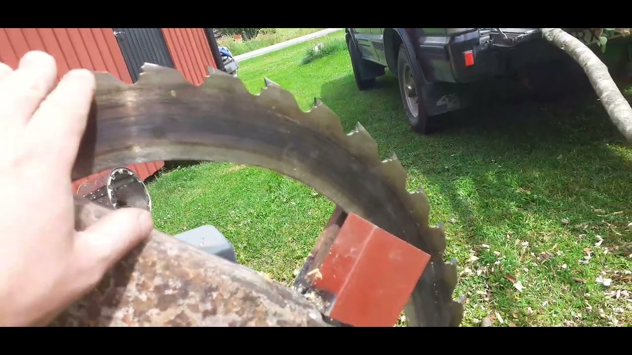

Are both sides sharpened?
Seems to have more thain enaugh torq for these hefty limbs.
How thick is the blade?
The chunks are crackes perfectly. Just what you want for fast drying and fast gasification.
“You are such a clever boy.” Sounds like a vote of confidence to me.
Don, I think probably she lost hope already 30+ years ago :smile:
Not really Cody, but thank you.
Good questions Kristijan. The blade is 3.9mm thick. As for now it is sharpened on one side only. For some reason I actually sharpened the wrong side. It pushes the wood back towards me, instead of pushing the chunk out the other side.
The chunker stalled several times after the camera was shut down and it seems I will have to experiment with the position of the anvils to get more of an angle to the cut. Worst case I will have to resharpen the blade and move the support bearings to the front.
And some safety envil to not cut your fingers. I would have the same itch, cut the limp to the very end. Be carefull not to cut your own limps.
Nice JO, mine works quite a lot better if I have a bit of an angle on the pieces, don’t know if this one does that.
There is plenty of wood in the world. No reason to risk anything. If it won’t chunk it will surely warm the house. Everything the folks here create just tickles me no end. How bankers and lawyers and a myriad of paper pushers got to be considered in anyway superior to makers and crafters baffles me.
Plus some ridicule. That’s what she would say to the dogs :smile:
Very true. Last piece into the firewood pile.
Very true too.
One more quote. I couldn’t agree more.
That worked really great J-O, perfect crushing of the fibres for a fast dry as well. A job well done :smiley:
Hey J.O. you are actually quite brilliant.
