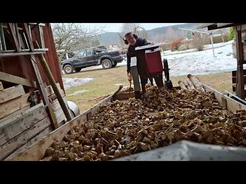

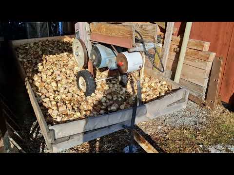

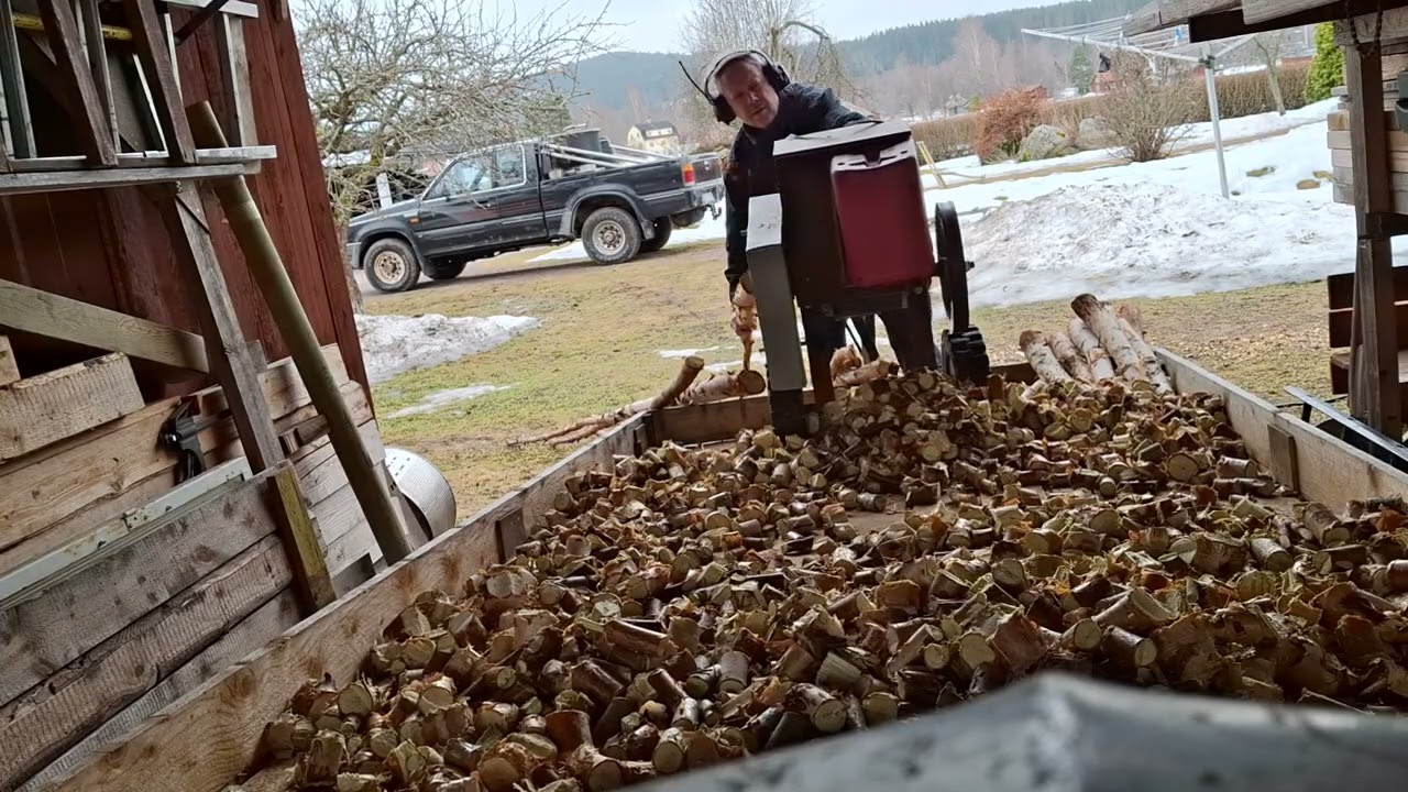

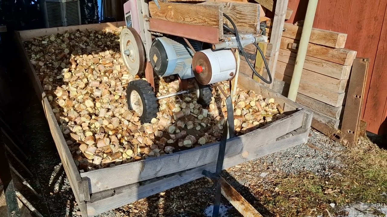

Since we are already talking about rebak chunking - here is a video of today.
Bagged the above and made a second batch today. I will be consuming chunks during summer, but a slight surplus will build my stockpile for next winter.
