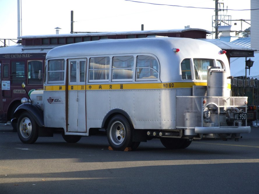

Caption said bus is in Finland .

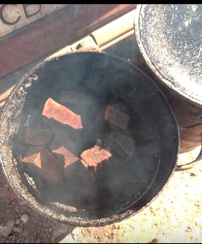

Тhis is what my car fuel looks like when I’m very lazy​:face_with_symbols_on_mouth::joy:
That is impressive, the wood looks like the size we put in the WK gasifers, may be even larger.
And if you look up KCK co. On the side of the bus, It come up with Kansas City Kansas transposition. Lol
In the WWII everyone was into gasification. No oil do it another way.

So Joni. The wood size is definitely to large for most Imbert gasifers. Your 30 cm fire tube with no inverted cone shows this. Only a 8 cm opening for everything to go through to the grate.
I think it is the larger fire tube that you have is helping the larger wood to get down to the tuyeres to be process. And with your long tuyeres sticking out at the top of the fire tube, it holds back the bigger pieces until they are small enough to Pass by the tuyeres and head on down to the reduction zone and grate .
The little bit of vacuum you pulling at the top of the hopper pulls the excessive amounts of moisture out of the hopper and out to the end of the exhaust pipe. This also causes the hot heat to move above the tuyeres for better pyrolysisation of the larger wood. This is following the K. I. S. S. Keep It Silly Simple plan.
The other thing I have noticed is your grate is fixed with turned up edges. Are you using stainless steel for the grate?
Steve mentioned that with the gasifer mounted on the hitch, 3 point connection would give the proper vibration to the grate by just driving it down the road.
The Japanese gasifier had a port where you could see red glow from inside gasifier but it seemed that it was inside double wall and a pipe on outside of gasifier lead to this port . A pipe on lid let out smoke . Manufacturer had big inscribed plate dedicating gasifier unit . Fuel seemed to be cut ceder boards slightly smaller then deck of cards .

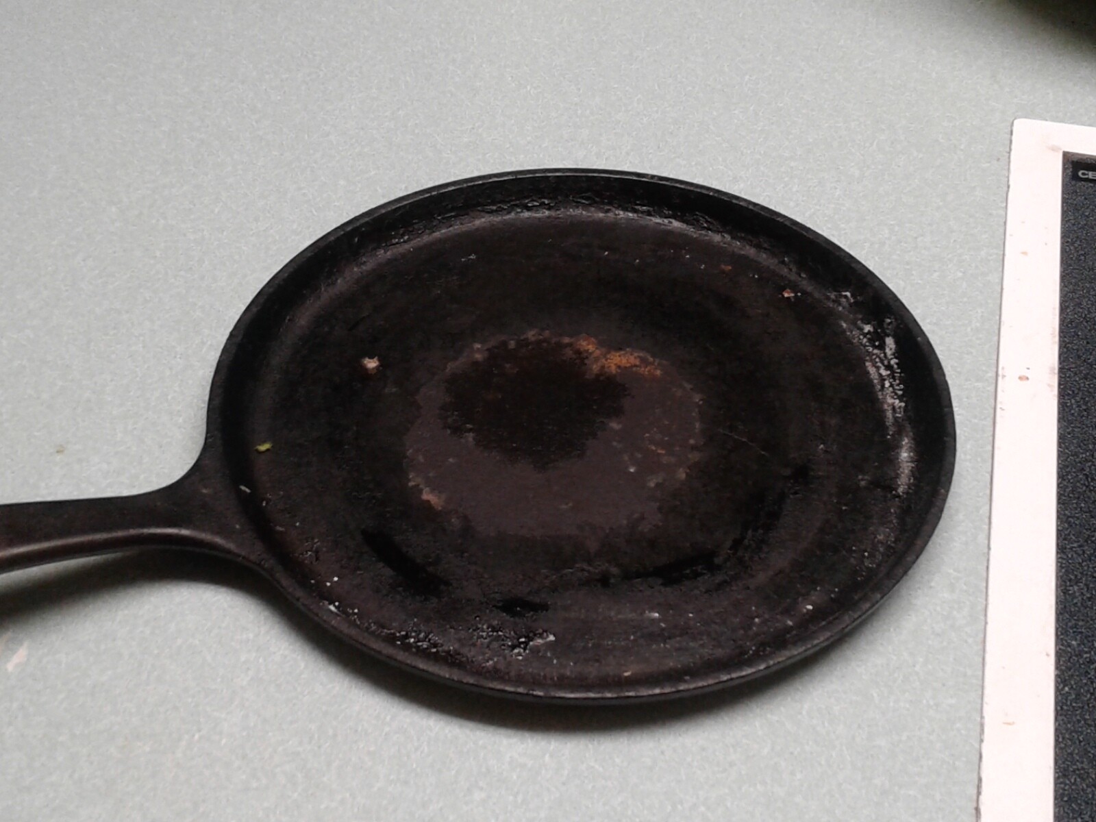

the grate of this gas generator was made from an old cast iron skillet that I stole from my wife’s kitchen and cut off a little …:joy::shushing_face::woozy_face:
Joni, did it last the life of the gasifer before retiring it. Or are you still using it.
Bobmac,
yes, that frying pan turned out to be quite tenacious, I still use it on version (GJ- 9.0):grin:
Joni, that is good to know.

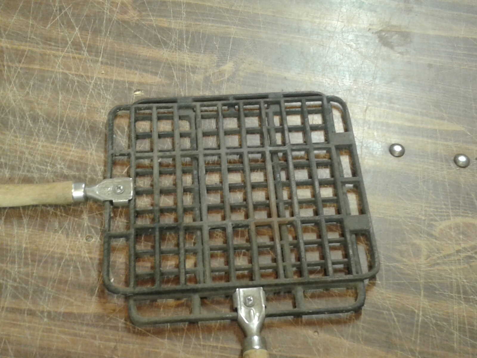

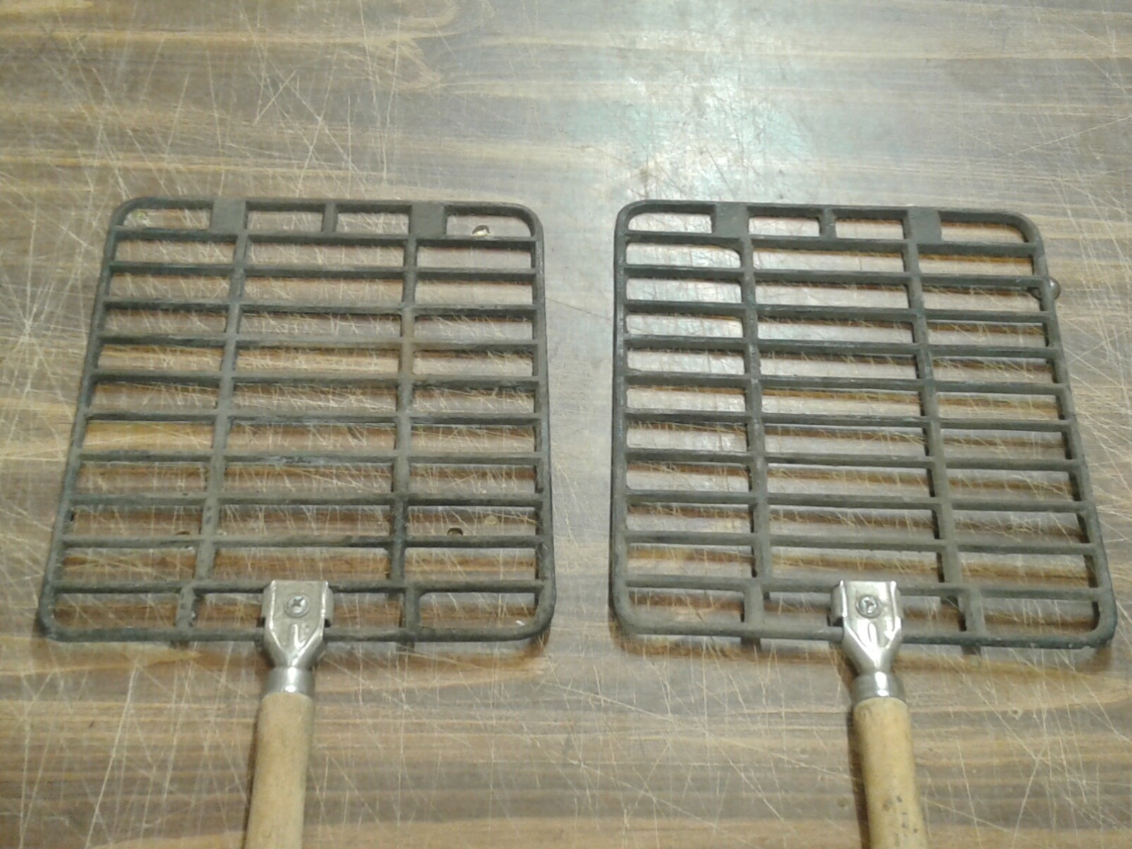

Here are some Japanese hibachi grills these are light weight ones. But on a bigger hibachi they are made more heavy duty. If you cross them 90 degrees you have a nice grate.
Free grate made of cast iron.
I wonder if my Dana would mind if I used this.
Bobmac,
I like your frying pan! :grin::+1:
I use cast iron pans and lids too. Stainless is hard to come by as scrap and the cast iron is free and seems to last. Also it’s much easier to drill a hundred holes into.

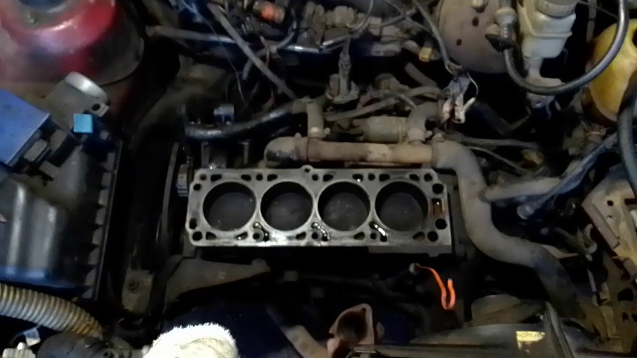

I like your channel Joni. You showed disassemble engine pictures. Hurrah!
