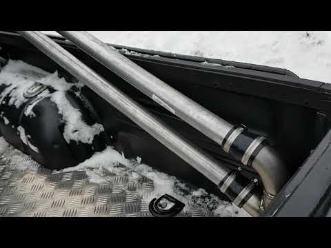

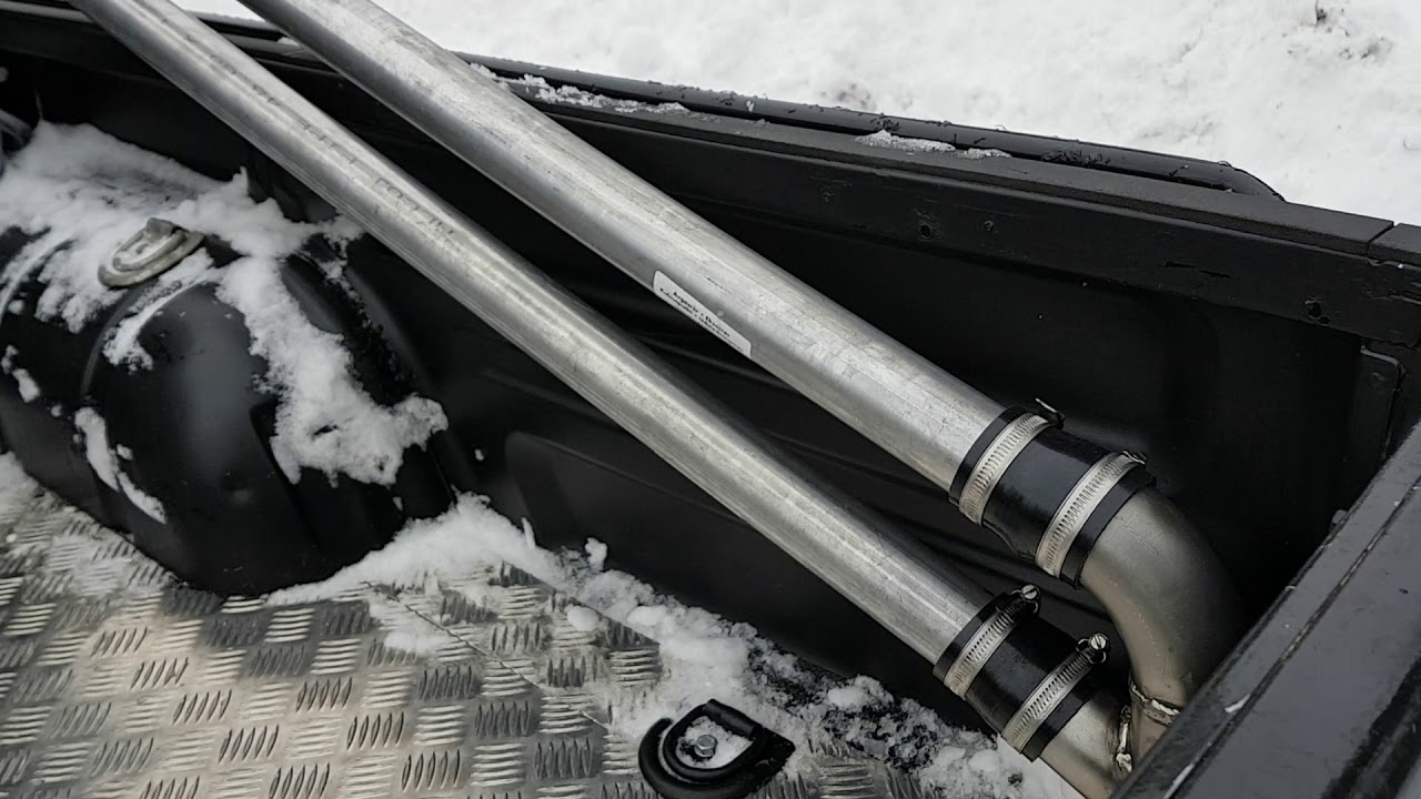

Went for a Sunday trip and stopped for a walkaround.
I haven’t done anything to the syphoning problem yet, but I’m at 250 DOW miles and I’ve wasted only about a gallon, so I’m not too worried.
At the end of the video I talk about the level of char in the hopper juice can. Of course I meant to say tar ![]()
Thanks for the video JO . You did a very nice job !!
Very well done Jo. You are a true Craftsman. No when are you going to finish mine?
Very nice Jan!
How cold does it get there in the Winter? I ask because it seems to be cold enough to run the wood gas to the condensate first so it’s easy to drain. I’m a bit confused about draining the hay filter. One can’t get enough heat from the wood gas to keep that liquid warm yet you have a small outlet to drain the hay filter. Is there just not enough liquid from the hay filter to worry about in Winter months because the dew point is already low enough at that point? Is there a space at the bottom of the hay filter to allow for frozen liquids so it doesn’t freeze the hay in there?
Thank you all for your kind comments.
@rustyold36 Jim, I’ve never owned a V8 and wouldn’t know which engine to connect.
@BillSchiller Temps vary a lot here with the Gulf stream whisking its tail at us. We usually get a couple of weeks in Jan-Feb with negative 25-30 C. Colder than that is rare unless you live further north. Also a week of thaw now and then during wintertime is normal. This winter is special because we haven’t had s single day of thaw since before Christmas. Also more snow than usual and temps around minus 10-15 C most of the time.
You’re right, in wintertime I could probably run for several months with a lump of ice in the hayfilter bottom without doing any harm. The amount collected is small.
Gas enters in an upside down plastic bucket with holes drilled in it. The barrel could hold several gallons before reaching the inlet. However I try to empty and wash down the hay as soon as temp allows.
The reason for the small valve is I was afraid a bigger one would crack more easily. Also I suspected a small one would get plugged with soot. More than 10,000 miles past and none of it happened
I actually never thought about how frosty hay affects the filtering. No signs of plugging though.
