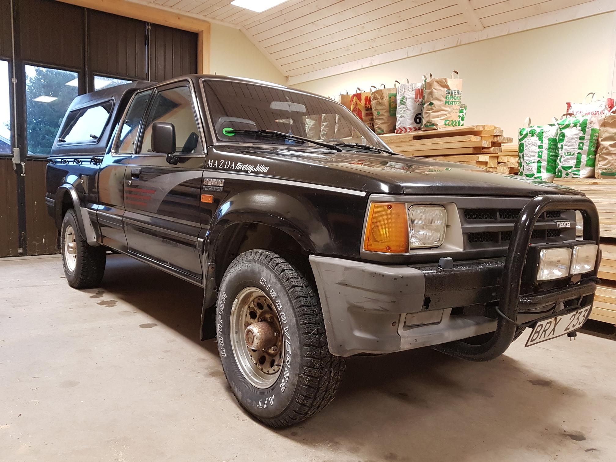

Look what followed me home. Someone claimed this was a worn out expression the other day. To me it isn’t ![]()
Consider this a full winter projekt. I’m not as fast as Wayne or Kristijan ![]()
These pickups are usually rust buckets around here. The few that are still left. This one has a very solid frame and is not rusted through anywhere as far as I can see. Only a few minor paint bubbles.
There is one error. When starting cold it has to be left in idle until out of enrichment mode, or it will stall. When running ok it still smells. My guess is a faulty MAF sensor. I think it’s running way too rich. It doesn’t have a lambda.
We’ll see. Either way, I payed only $1000, so it’s worth a try.

The high stance mean this is power to the front wheels also?

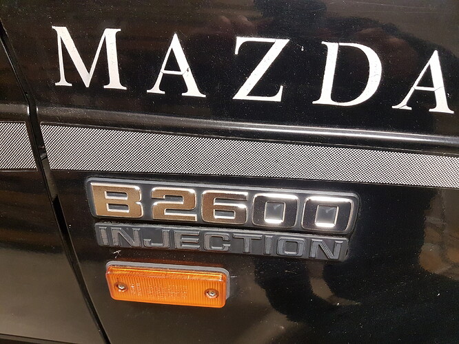

Is the 2600cc engine the internal oil-wet chain driven counter balance shafts unit? Or the later, the later external cogged belt driven type?

Congratulations on a new project. What exactly did you have in your back pocket that cause this to follow you home. None of the others have confessed up to what they had. I have to say-- you don’t mind taking on the odd project. No one has gasified a VW until you, and now you are taking on the Mazda. I have been afraid to even look a a Mazda because of the reputation they had with that rotary engine. I am looking forward to pictures as you start this build. You will be done before I get mine back together at the rate I’m going. I have given up on making many of the changes I had planned am just trying to fix what was broken== but that alone is going slow. TomC

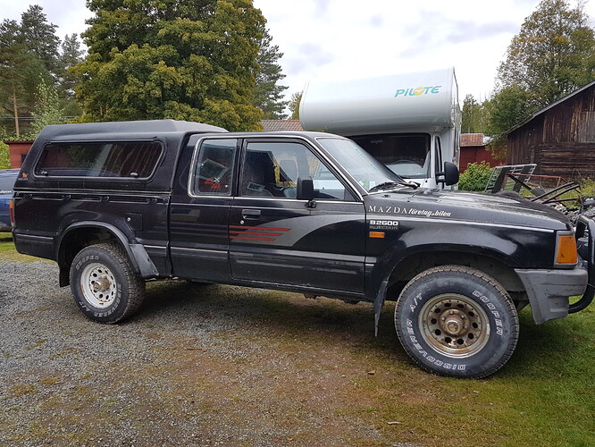

Yes, this is a 5-speed stick shift with a second stick for optional 4WD + 4WD low gear with diff look. A bit heavy, I know, but the front profile is rather slim so I expect to do ok on level ground. It ways 1700 kg and legal loading capacity is 1180 kg. In total 2880 kg (6,250 pounds).
You’re not to far off about the engine. The earlier models had the carbed Mitsubishi engine, but this is Mazda’s own mpfi, 3 valve, long stroke, slow turning, work horse. Wet chain, yes. MAF and CAT but no lambda. Turnable dist with Hall sensor.
Up until 92 heavy pickups have no emission requirements here. This means I will probably be able to legally register this one into the “gengas vehicle” category. This is not confirmed 100% yet, but I just couldn’t let it go. If not, I’ll stick to stealth mode.

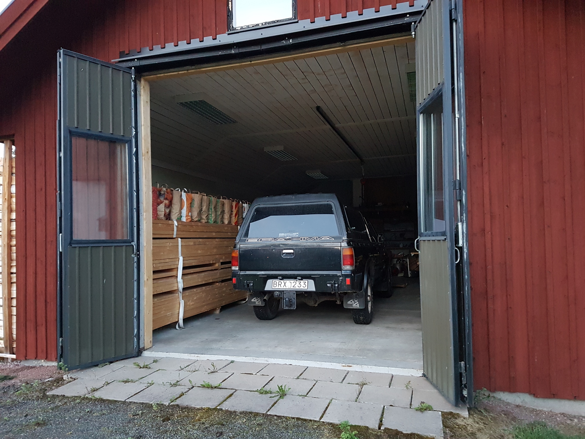

I agree Jeff on a nice place he has there. I had never seen the inside of the garage== could be used for my living room – what elso would I expect from JO> TomC

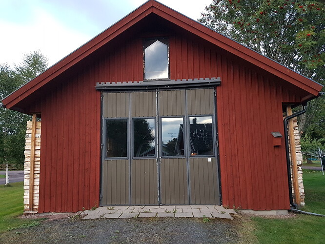

That is an interesting garage door. Are those bi-folding? That utilizes the whole ceiling height vs an overhead door. Can you open just one section for a man door?
Hi Don,
Bi-folding sounds right. They open two sections each way. I have a separate man door on the long side.
I managed to get them from an abandoned fire departement 12 years ago. Hight is 11 foot.
I built the whole garage to fit the doors
Raised A-beams on the trusses for example.
I could use a set of those doors for one of my barns… I love it.

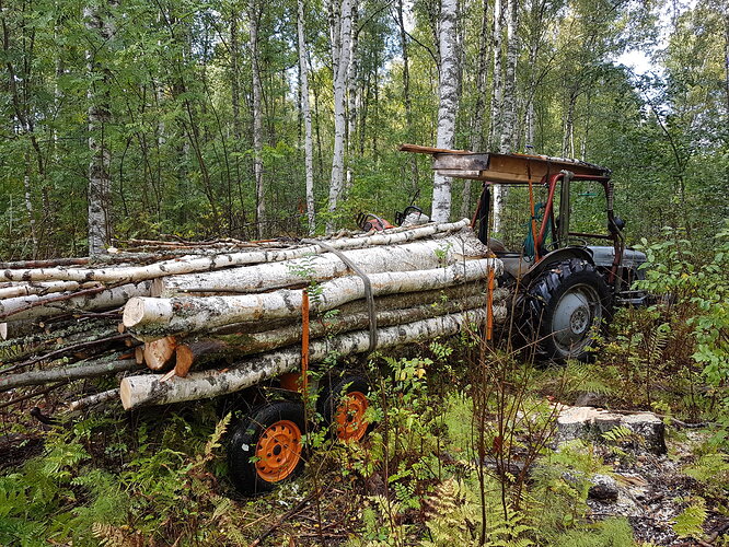

There will be a while before I will have time for the Mazda. There is so much else I have to do before snow. Today was Sunday and I know many of you across the pond don’t work on Sundays. But he didn’t mention workout, did he? This was my Sunday workout.
Edit: …and that’s birch
Well being a farmer I never got to take Sunday off. I spent the day mowing hay hoping I get it in before the storms make it all the way up here next week. By the looks of what is going on down south I think this will be my last chance to get any hay I can feed this winter so what i get will determine how many head of galloway I can add.
Dan, I don’t envy you that stressfull hay business. This firewood is for next winter or winters to come, so there’s no real hurry. But I still like to have it done before snow.
When the spring comes I’m too fat to run around in the woods. I can stay in the back yard splitting
Now I see why my Icelandic friend called poplar birch!
Jo, nice prehauler (moderns call them forwarder) you have there. I don’t see any thing on the trailer to parbuckle the logs on. And I do not see an arch on the back or winch to arch them on. Maybe a separate loader to load your prehauler?
