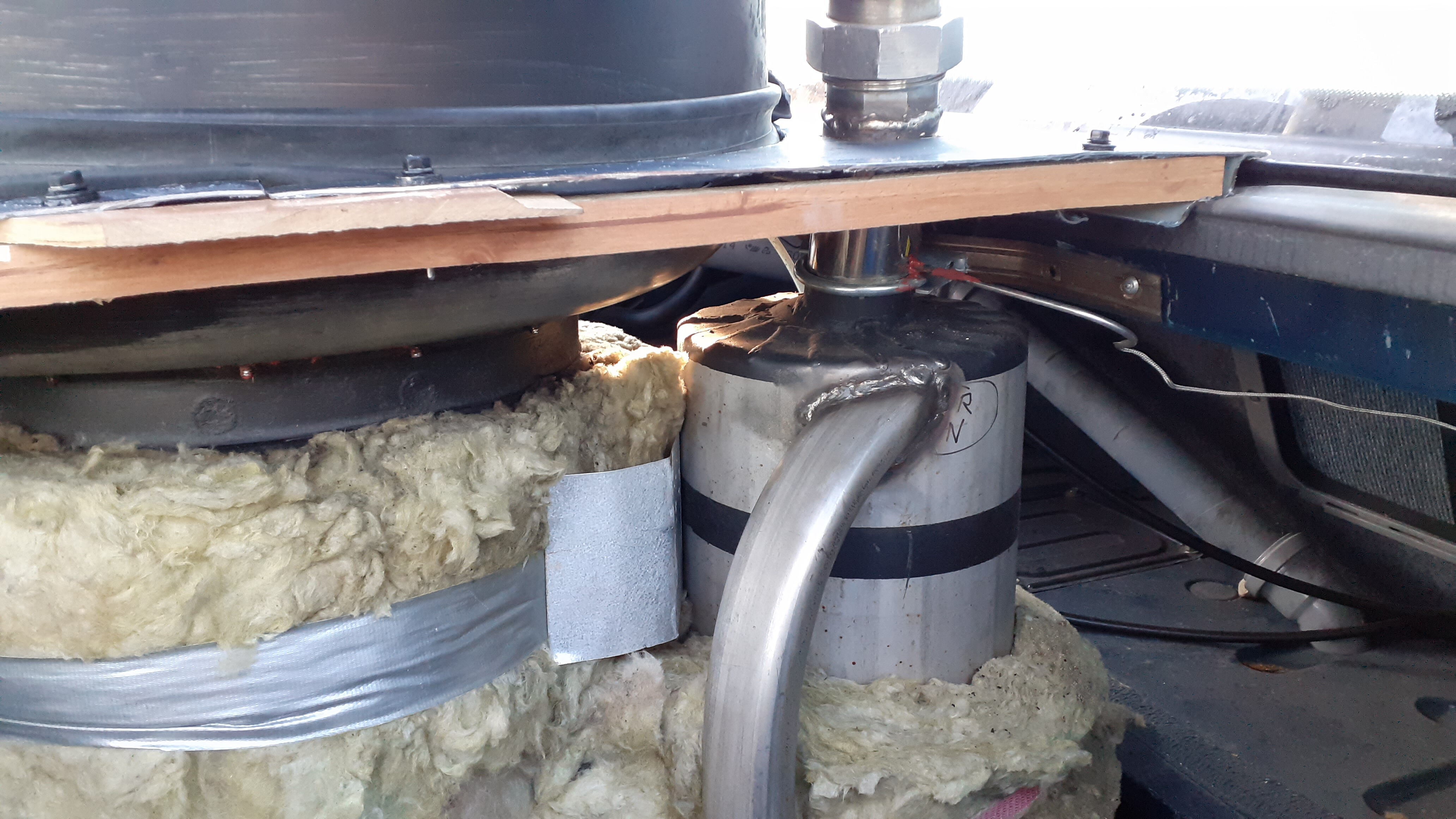

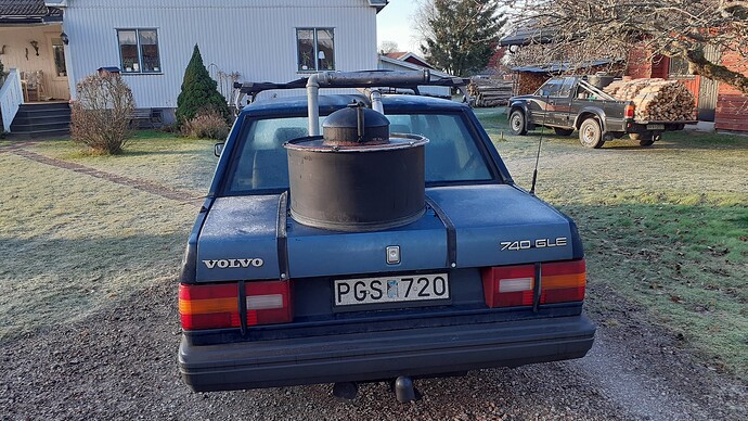

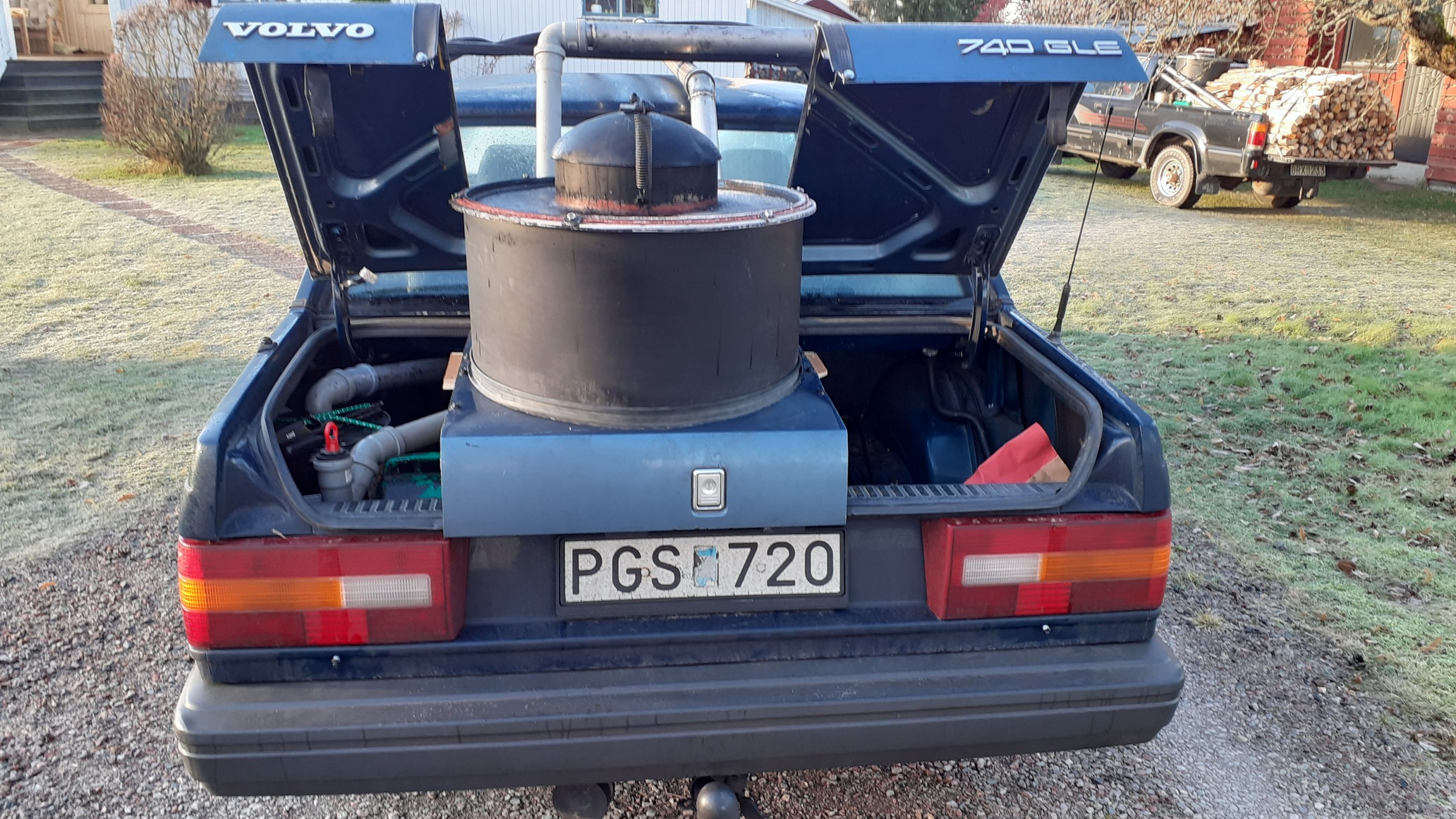

Mounted the new trunk lid the other day and then
wife and I went for a 100 mile roundtrip yesterday. 50 miles one way is perfect for this hopper size.
We did one extra stop though - but only to check the cleanout rubber cap. Reason? The temp leaving the heatex climbed above 250C, but I found no obvious extra heat or leak down there.
So it seems the only reason is - with the trunk lid mounted, the temp-probe is no longer out in the open. I was surprised to discover the true reading is almost 100C higher than what I’m used to. Last pic shows the probe’s position.
Also, I will have to add to the insulation around the gasifier, because the hayfilter bucket picks up some radiation. It gets armpit warm on that side but still cold to the touch on the opposite side.
Nice job JO, turned out very well with the tailgate.
