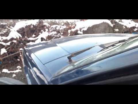

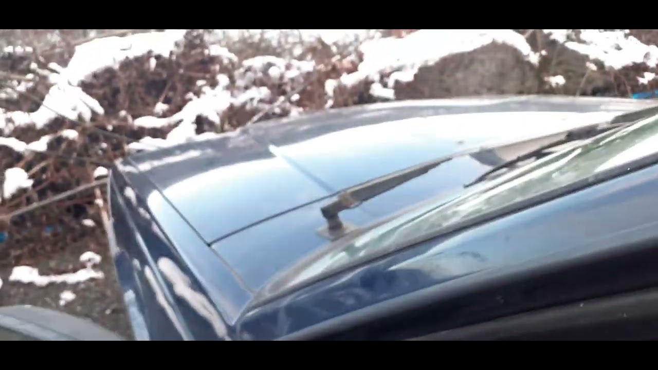

So far I have only put together some stuff laying around, taking up space on my shelves.

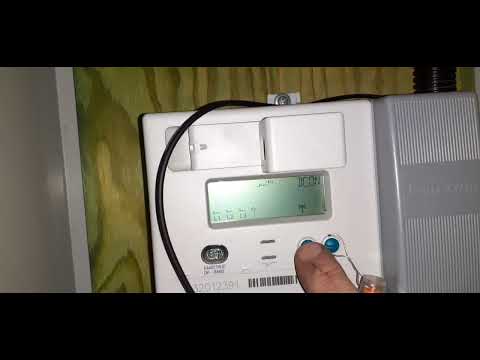

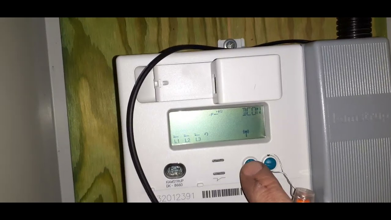

As you can see in the video I produced 10-11A (the only belt I had that fitted is old and cracked and I didn’t want to push it). Anyway, these amps should equal about 7kW (~10hp).
I didn’t know exactly where to start, but I reved the Volvo up to about 2200 rpm and hit the switch. The electric motor slowed the Volvo down to 1800 rpm.
My meter display doesn’t show negative power, but my solar app showed ~4kW. It should mean the 3kW missing is reactive power. Time to look for capasitors.
JO, if you downloaded the document, you can see on page 9 the data for your motor, which has 6 kvar inductive power, but in generator mode it is a bit smaller, because the rotor itself rotates faster and does not need as much excitation, well, however, it would could add capacitors for at least 5 kvar power, for this 3x33 microfarads correspond, which you can find in the next link on page 9.
Let me add some math, voltage 240V x current 11A = 2.64 kW per phase, you multiply this by 3 and you get a total power of 7.92 kW, so already here we can see that there is almost 4 kW of reactive power, if the solar meter shows correctly.

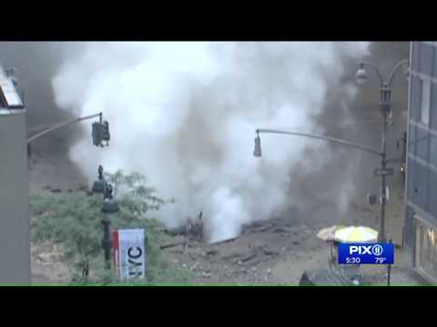

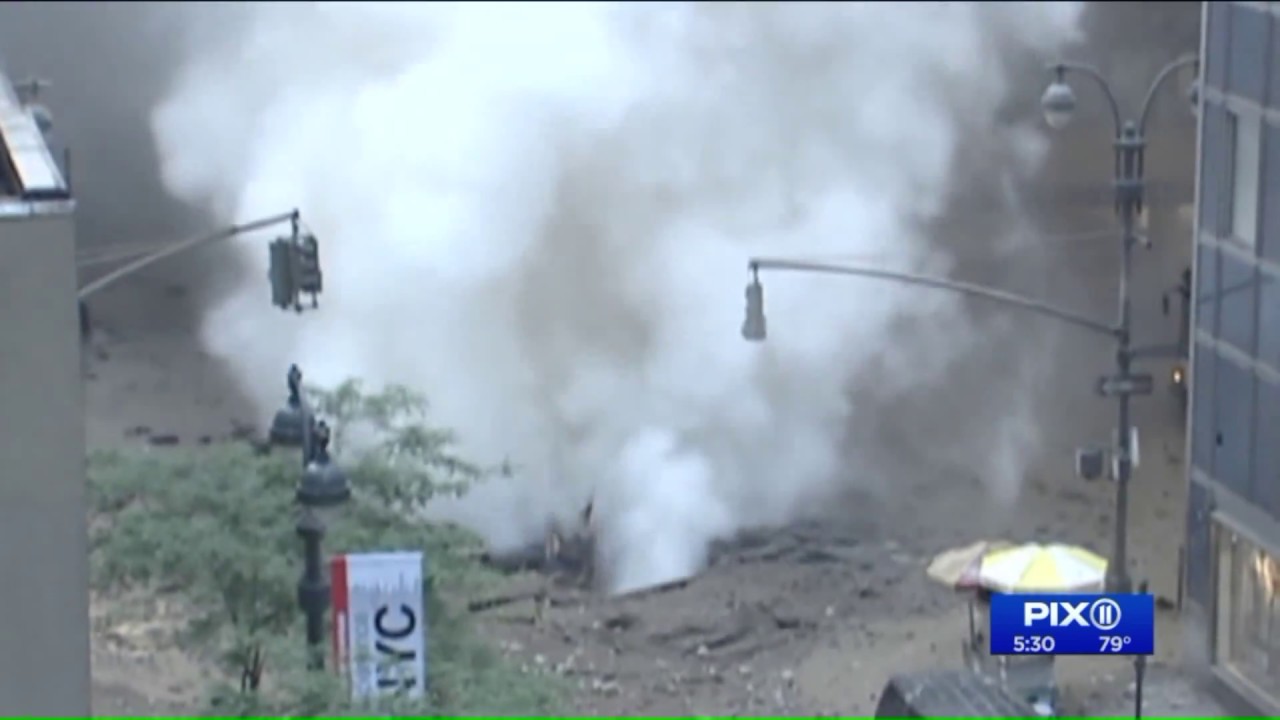

This is my destination in 75% of my DOWing. I don’t blame you if you don’t want to hop in and follow me to work.
Sorry for the shaky camera.
You be careful there JO. In your old job maybe you get a bad paper cut. This job a little more risky :face_with_head_bandage:
That’s true Tom. Superheated 40 bar=580 psi steam will instantly set fire to your pants if only a tiny leak and the steam is completly invisible. We’re told to always carry a folding wodden ruler to use as blind cane. If the ruler catches fire or suddenly is shortened you’d better back off :smile:
My pea brain can’t wrap itself around the kind of infrastructure it takes to steam heat many of those buildings in a place like NY let alone a town of 50K.
 Lies are responsible for most of the pants fires here.
