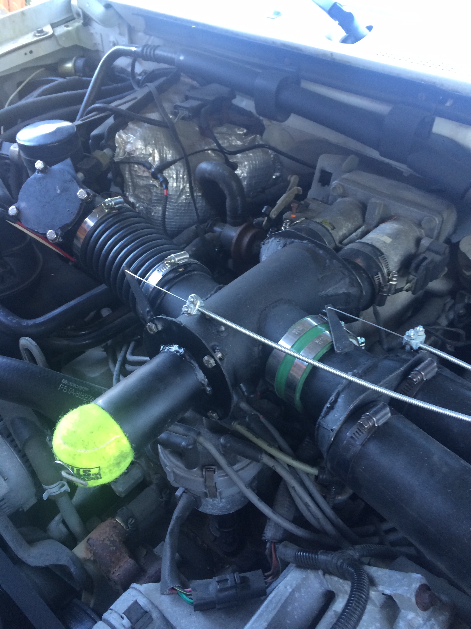

It was the same with my Mercedes. However l seem to remember backfires were worse when the mix was too lean.
Here is good thing about your Volvo, it should never have heavy carbon build up like on your truck. The back fires will keep it cleared up. Lol. Are your back fires really loud or they like a fart or woosh?
I only have them if I have my foot all the way down on the gas pedel clumbing a hill pushing 4000 rpms plus. As I let off the gas pedel I will get a hopper puff, sometimes or a intake puff. The two tennis ball valves under the hood handle it.

Maybe idling for a while and then a sudden acceleration throws the mix off a little. Also this motor has a separate iac, by-passing the tb with pure air straight from the breather. I did block it with an old style tap valve, but I will have to check if it seals properly.
Pretty loud actually. Sounds like I hit somthing. Even with a puffer valve on the mixer and one more on the slingshot, I bent the new homemade metal butterflies.

but it sounds like you have opposite problems. Running hard at 3,000 rpm doesn’t cause my backfires, nor does letting the pedal up. Returning to light throttle after idle position does. You heard my first ever pop, didn’t you? Sharp bend to the left at idle, and then a light throttle to start moving into the parking lot - POP!

Here is what l think hapened to me and you now.
When the pedal is relaxed, there is only a small amount of gas drawn trugh the supply pipes. Vacuum in the manifold is high. When suddenly you want power and step on it fast, all that vacuum is released but since the gas has a lot of inertia in supply pipe and cooler, there is momentairly mostly air drawn in trugh the air valve as it has almost no inertia. The engine sucks this lean slow burning mix, wich still burns when the intake valve opens. In the meantime, the inertia of gas was overtaken and good mix is pouring in. The fire and the rich gas mix meet and off goes the filter lid (in my Mercedes case
If my theory is true, there is a way to fix this even if timing advance is limited. One just need to make the gas supply line lenght and volume mach the air supply line lenght and volume. This way the inertia of the gas and air will be the same.
That, or build the valves super strong (ball valves, all welded) and accelerate like a sissy like l did on the mb
I was just thinking maybe this is why Wayne’s v10 so rarely pops is the engine is having to draw a distance of pipe to get fresh air through a fairly restrictive paper style air cleaner slowing down the inertia of air movement making more engine vacuum pull through the gas lines…this may change my air mixer setup, I was planning for high flow filters maybe 5" off the mixer body
Marcus, usualy with enaugh timing advance there is no problem. You wount even notice the thing. But both JOs Volvo and my Mercedes only had a 6deg window of advance, too litle for what we need.

I have 3” steel lines with poorly fitting butterfly valves for air and gas to the stock throttle body.

This might be one of the reasons why Wayne ran two 2" wood gas pipes up the the engine compartment to the mixing box with lots of mass flow with both valve open. Air valves only partly close down. Also lot of back up reserve gas in the lower gasifer, drop box, condensation tank, hayfilter, cooling rails, and other piping.
