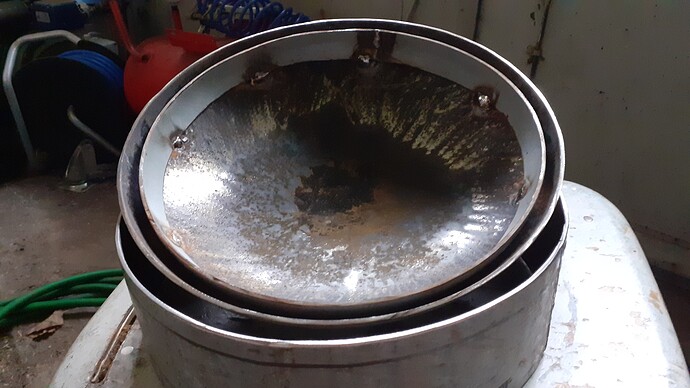

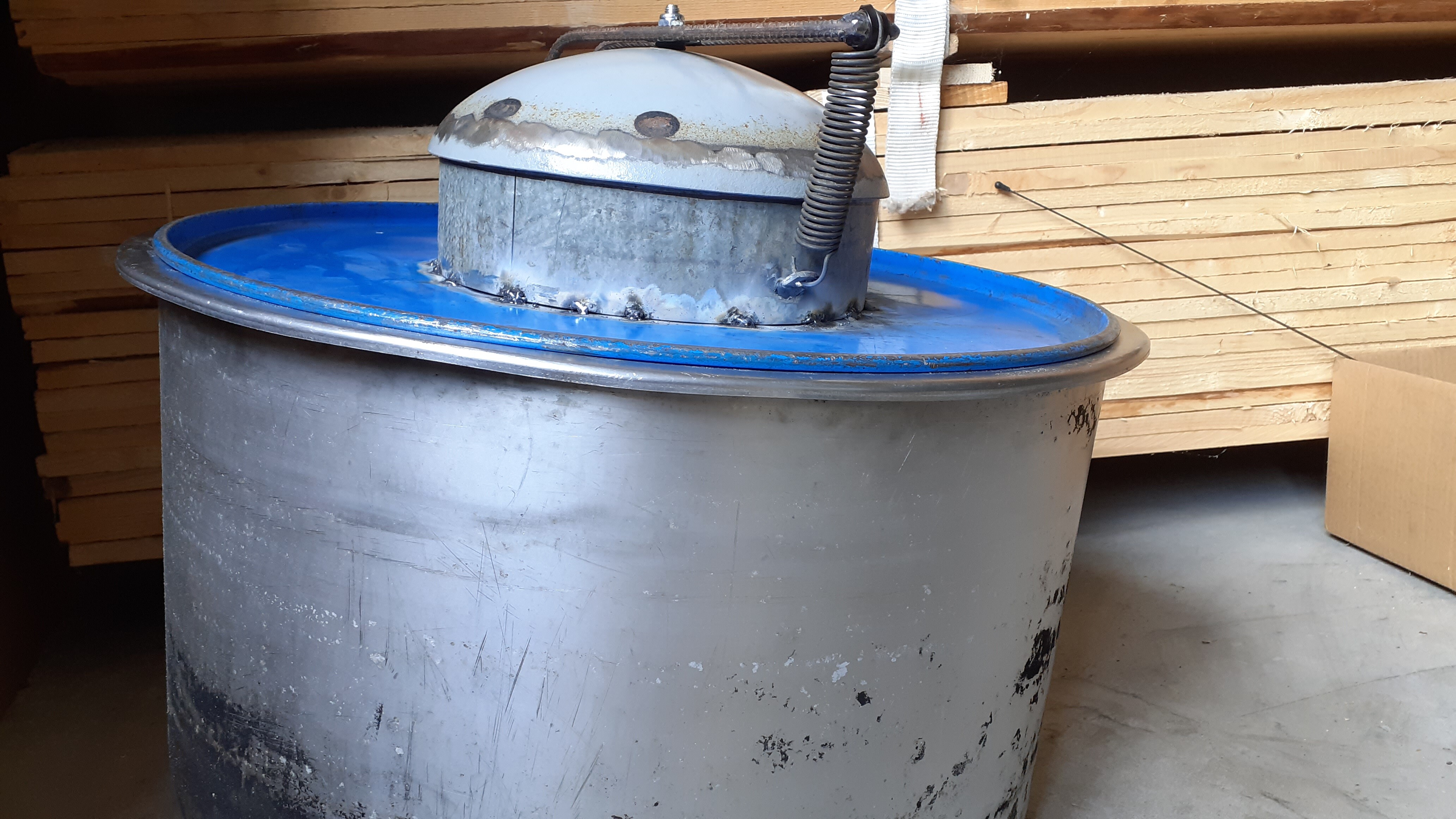

JO how did you seal your hopper lid on this one?
Started out with just stove rope in a grove, but after first lightup I noticed the rope wasn’t thick enough to avoid metal-to-metal contact with the dome lid. I added some silicone to the rope. It sat with a closed lid and plastic wrapping over night.
I have a fascination for homemade lids and your lid is a dandy! Nice job.
Thanks Jeff. Not too much trouble though, with the premade dome.
What did that dome come off from?
I’ll guess his favorite building material, propane tank! Looks just like the end of our forklift tanks at work
Right! What was left when cutting the firetube

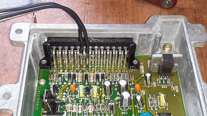

As suggested on Volvo racing forums I grounded two pins on the ignition module to get 6 degrees advanced timing.
Crawling upside down with your head stuck under the pedals isn’t my favorite working position. Especially when everything closer than 5 feet is blurry nowdays. To be able to solder on those two wires I needed two pairs of reading glasses. I could have used three of them but my nose isn’t tall enough.
I don’t have a timing light and listening to the motor when switching grounding on and off, I couldn’t tell any difference.
