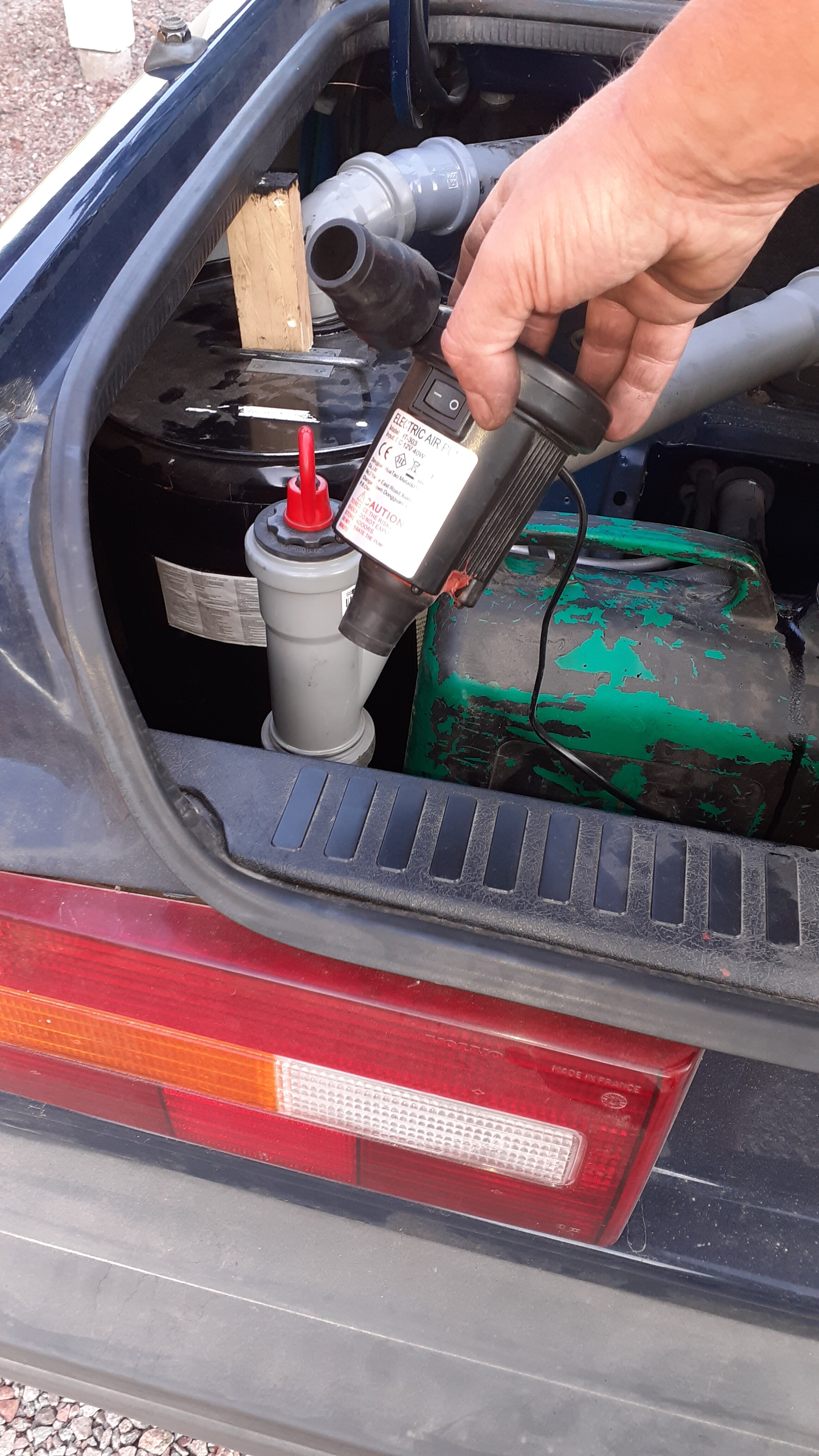

Still using the 12V mattress blower. I attach it to the pvc before the gas enters tank and filter. Pic later.

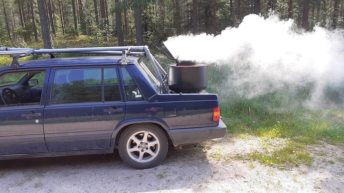

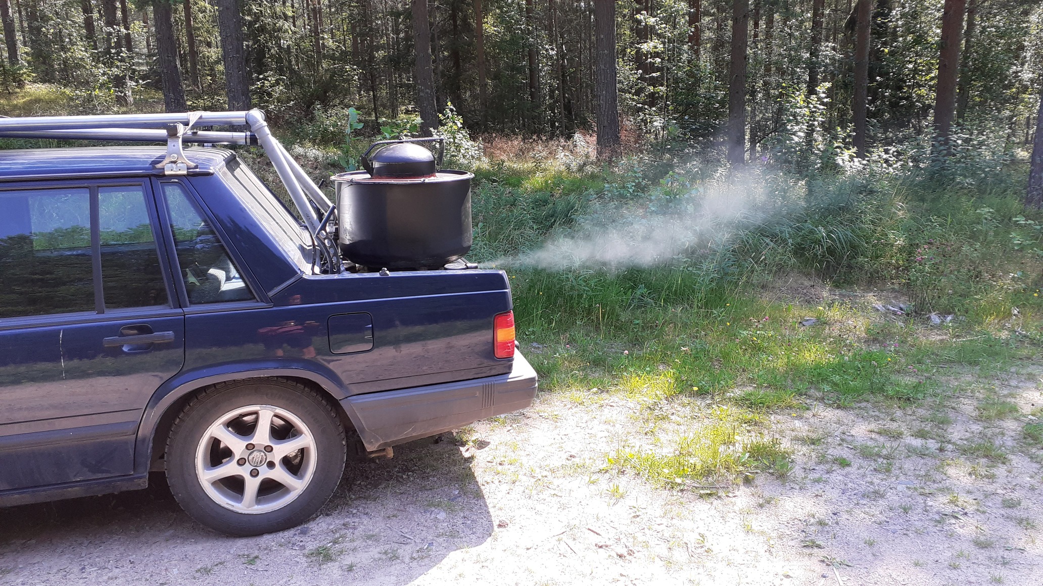

These are startup pics from the other day. Video later.

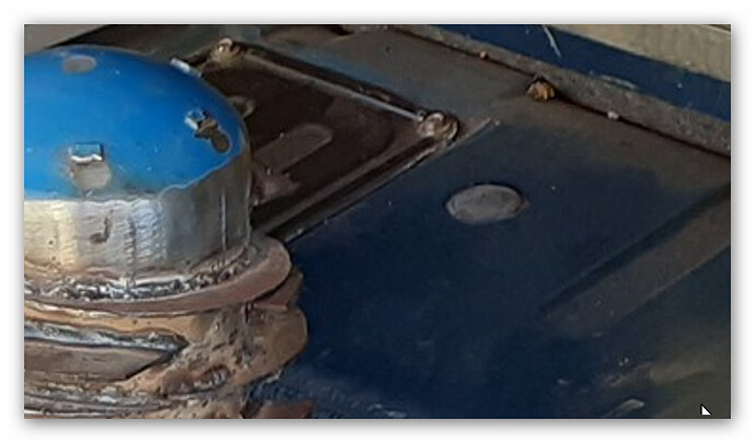

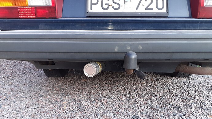

Ash cleanout under the rear bumper. Tips: Pineapple cans are made for a snug fit around 3" ss tubing ![]()
The air mattress pump replaces the red rubber compression plug at lightup. I just turn the pump around for reverse mode.

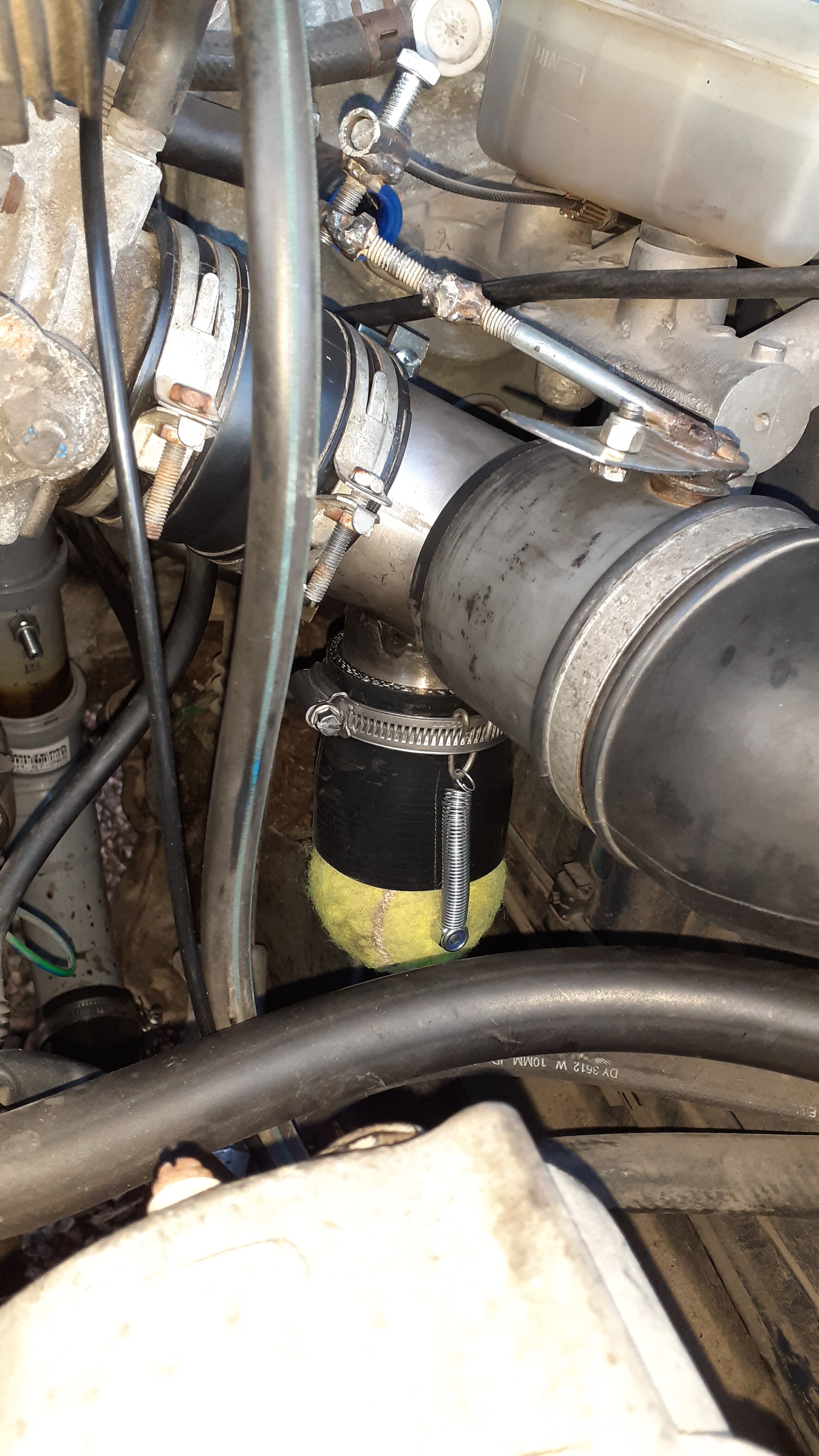

Welded a 4th outlet on the gas-mixing-T today. There was just enough room for a tennisball puffer valve pointing down. Springs on the outside.
Edit: Btw, I found all four halfs of the plastic butterflies in the slingshot department ![]()
Wow, better there than in the intake or by a valve intake. Any further down could mean damage to the engine.
This is a good thing to learn on the butterfly valves we make. My next on is a 3" throttle body valve off a 350 cu. in. Engine. Just by pass the servo motor by pulling one gear out. Lots off these types off throttle body valves in the junk yard.

I plan to just partially scrape ashes out. I made a tool so that I can reach all the way under the heatexchanger. Only when flushing the heatex I may park in slope and let the most part flow out.
