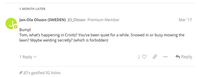

Tom, what’s happening in Crivitz? You’ve been quiet for a while. Snowed in or busy mowing the lawn? Maybe welding secretly? (which is forbidden)
