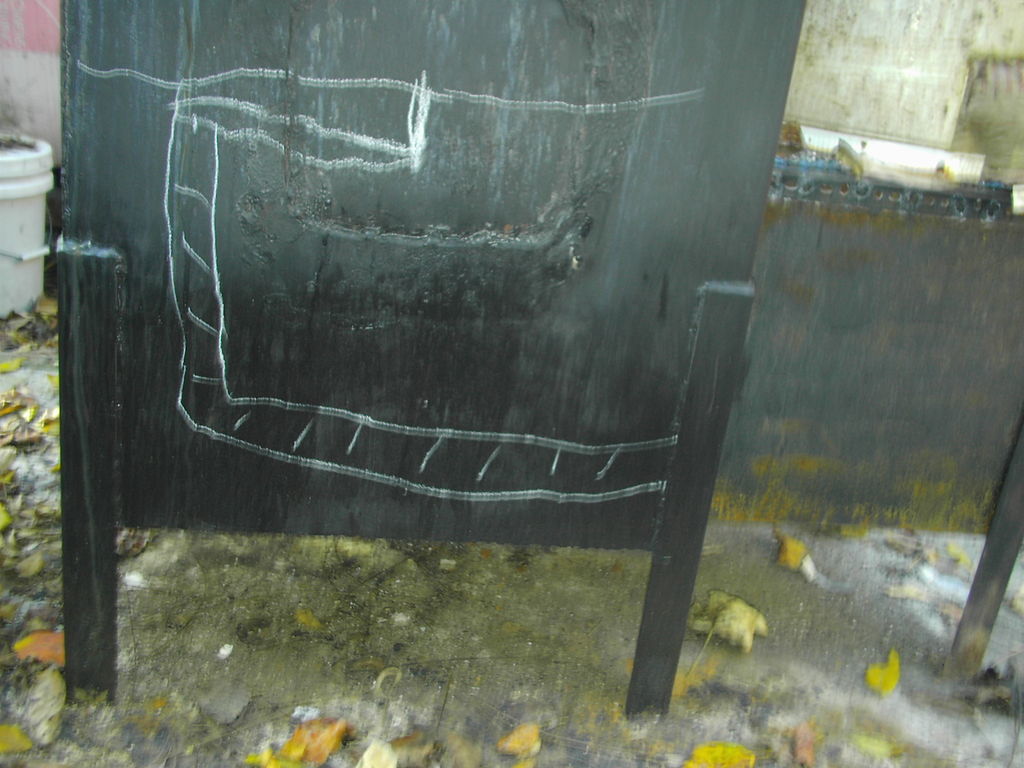

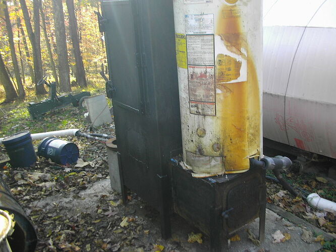

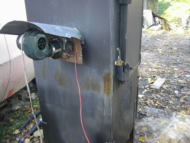

I’ll post some pics of my stove
Tom
here’s another pic my computer is mad at me

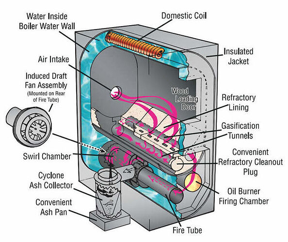

Matthew - Here is a diagram of a gasification boiler.
Thomas - Looks decent. Sounds like it does a great job of heating water.
I just finished my boiler and will do a leak down test tonight. See how much psi it can hold. I also have a monotube flash boiler I am going to implement in my design. It was off my pressure washer and I was able to turn10 gpm of water to steam if I turn the temp above 1/4 dial. The coil is 100’ long.

That’s what they call a wood gun i think pretty nice but i was afraid if it cracked you would have to cut it apart
Mine works good but looks like crap and is probably not very effiechent
