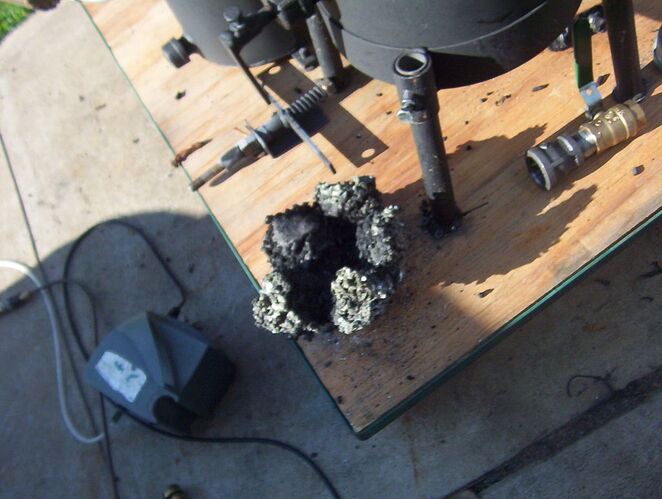

Hi Matthew, welcome to the site. Corn and agricultural waste can be used, but they have high ash content, and can form clinkers pretty easily. Corn in particular is high in silicate, which melts into glassy slag-rocks. This can plug up your grate. Used for a heating application it should be OK, there are gasifiers that are specifically designed for using ag waste, check out the papers in the PDF articles section from the India Institute, and others on gasifying bagasse, rice husks, etc.
I know all about the clinkers that corn makes. My dad has been heating his house with corn for about 10 years now and I have a small corn burner i my garage. I does make a very hard clinker.
The only problem you shough have with clinkers is to grind them up and push them throulgh your shaker grate.

Heres an extreme example of clinker problems grass clipping pellets
