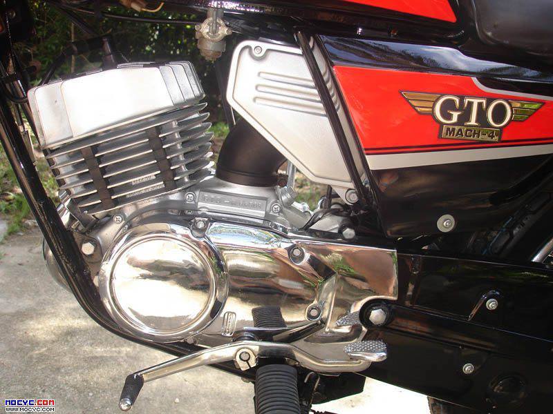

Kawasaki 125 cc GTO Mach 4
The next i was waiting for…
125CC
18 HP
Rotating valve for fuel intake…

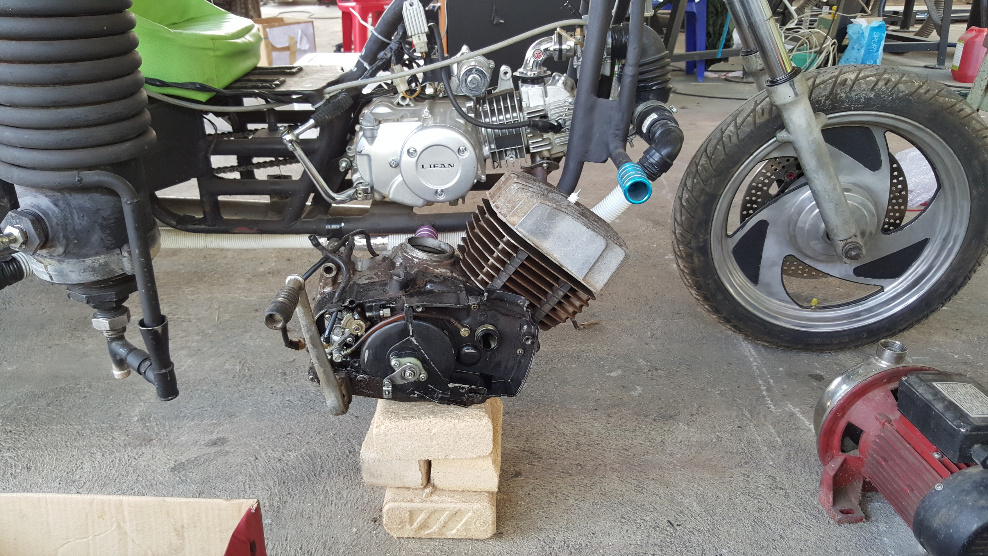

Having it stripped and cylinder in the shop for over bore, + 2.00 mm
This one will have to take the place from the chinese lifan 4stroke engine on the trike…
Koen, a two stroke rotary valve engine on the charcoal powered trike! Guess it has oil injection, too?
Hi Ray, yes it has, tomorow will post some pictures from the insides of the engine

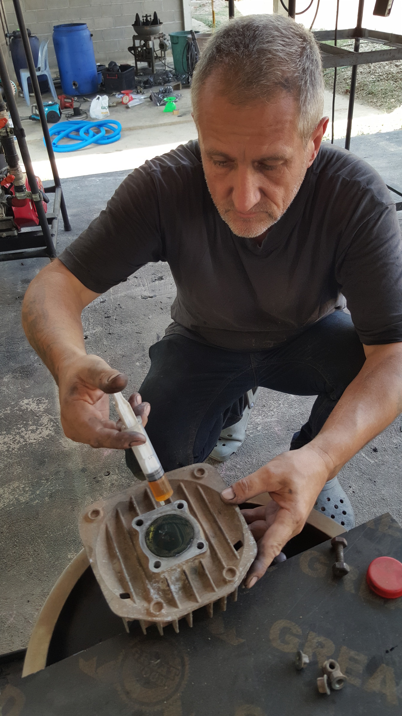

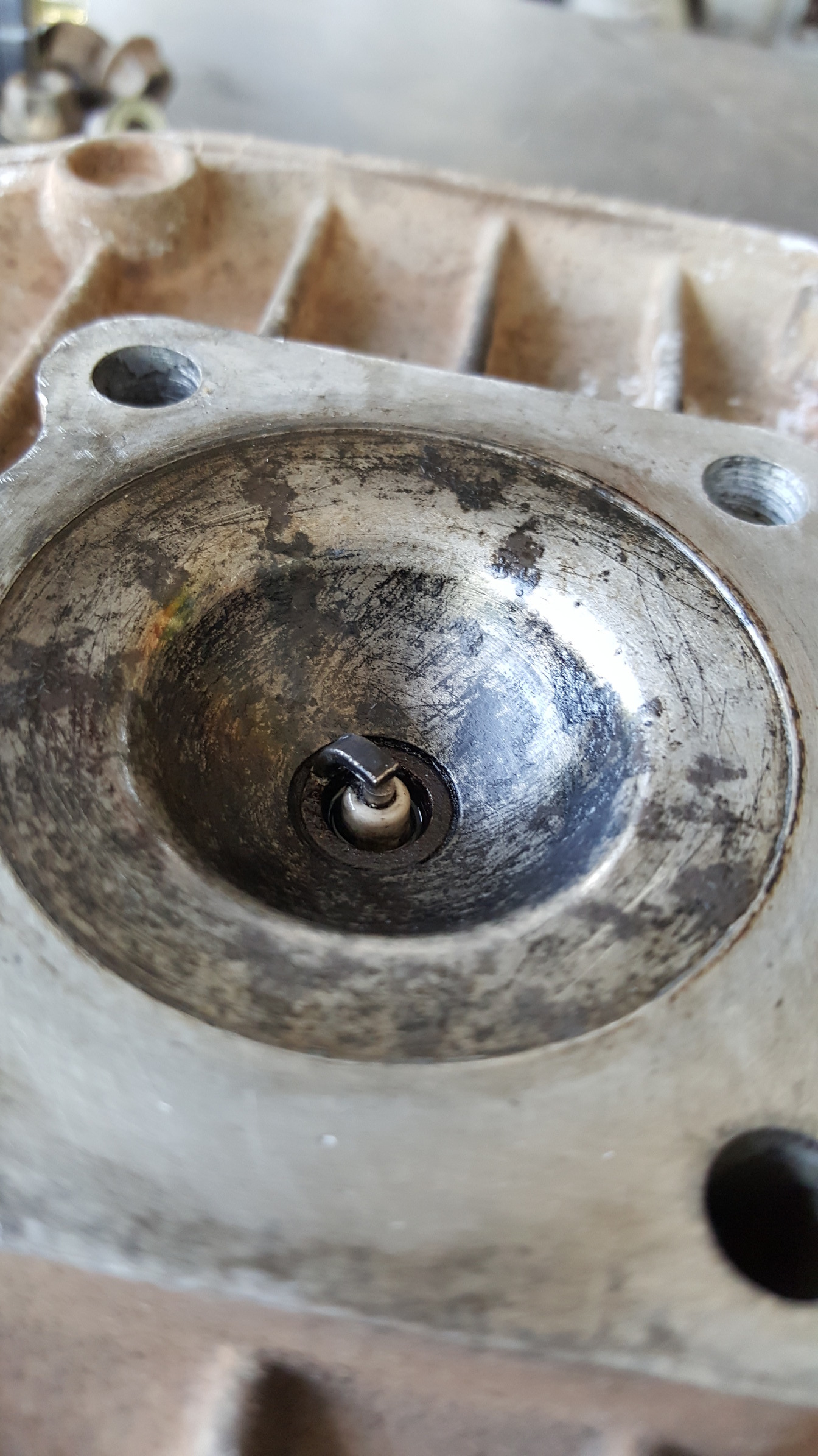

Sizing up, will fit the frame, measuring the volume in the cylinderhead.
Overbore 2.0 mm, adding about 8 cc to the 124cc original, bringing the total to 132 cc
2 stroke , with rotating valve and oil injection :grin:
Cylinderhead , nice quenching shape, volume 13 cc
Gasket and distance from piston, aprox 0,8 mm, to be modified..

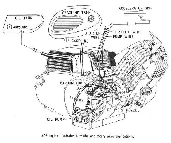

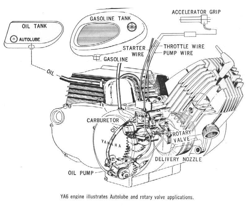

“2 stroke , with rotating valve”
Is there any way to get a picture of the valves?
Hi Brian,
There is 1 rotating valve inside, here are some pictures i got from the internet.
It works as a kind of a slide/door to open or close the entrance for the fuel mixture.
The advantage is the ease to modify and it has less restriction compared with the reedvalve

Just woundering how long them rotating valves have been used,and are they hard too rebuild too keep valve clearance proper? Thanks,nice engine photos.
