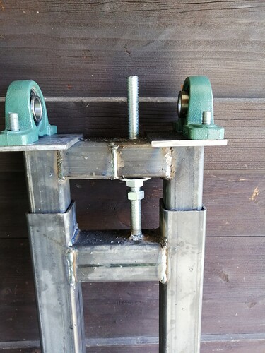

Circumstances finaly forced me to get to the project. l was procrastinating to long, so here it is. My bandsaw sawmill
Its gonna be a simple small one. Powered by a 8 hp petrol engine, woodgas later.

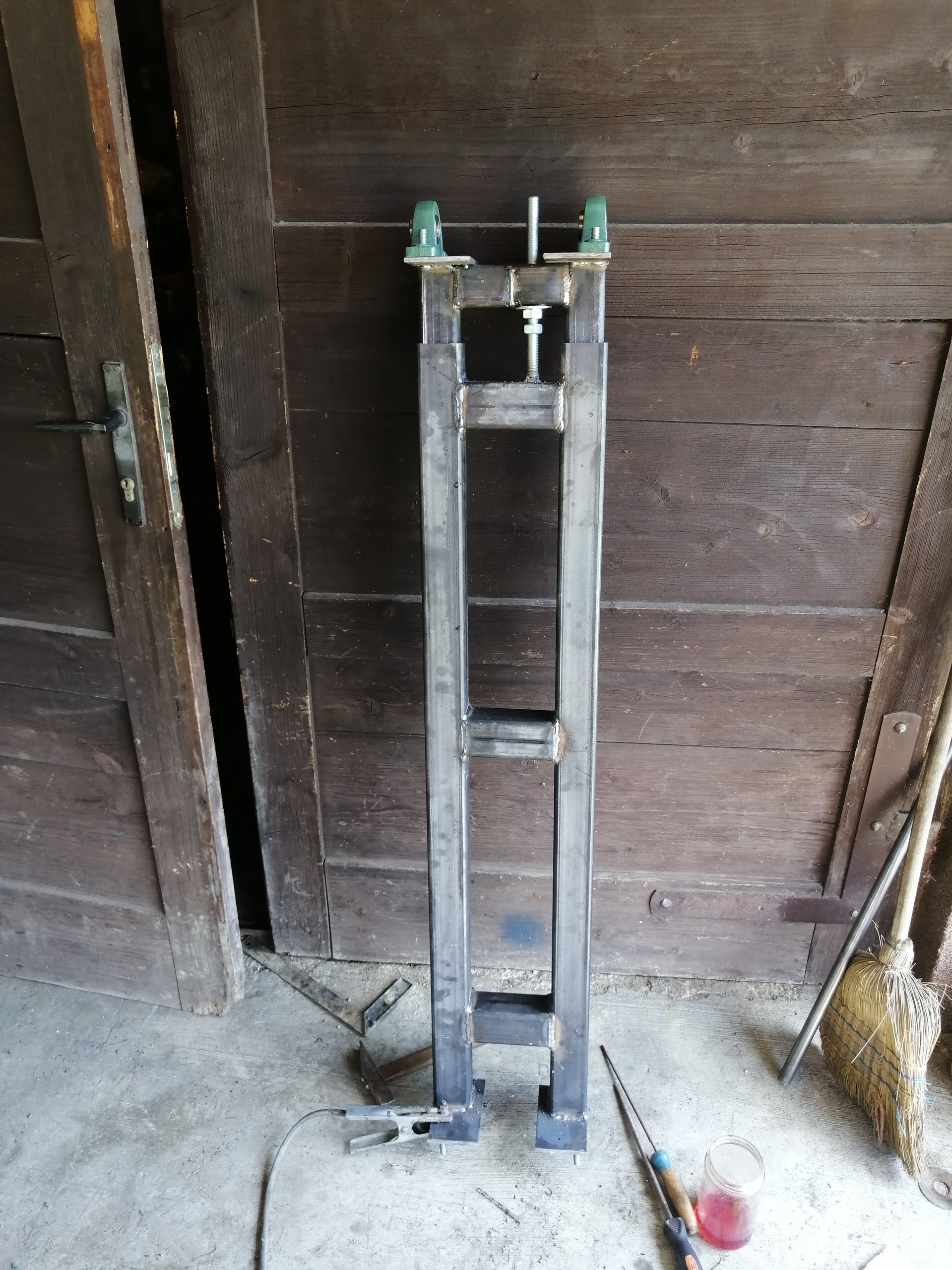

guys at steel store know me allredy and l personaly know a couple of them so they cut steel to size without charge for me on the band saw. After that its just pulling a couple of beads of weld. Problem is l never put plans on paper so l need to download specs to them from my brain. You can see one mistake in the download operation at the top cross pipe, in a hurry l forgot about it and had to graft 2 small peaces together.

I failed t mention this will be a stationary saw system. Thinking about it, l realised l culd allso make it 90° adjustible. If l add a desk and change to a thiner blade it culd allso be used for some more precise woodworking. Will see about that…

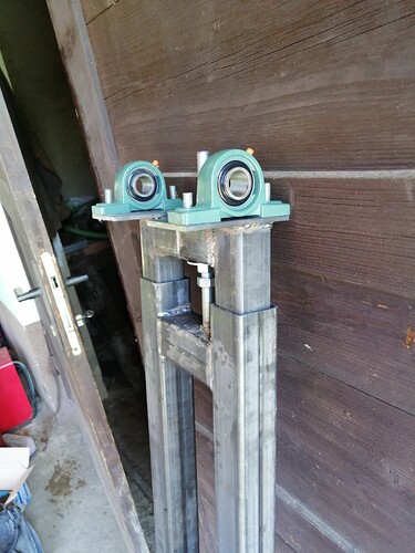

Have you thought about using standard wheel hubs (for fabricating trailers)? Two of them is probably the same cost as your four bearings and no shafts needed. (maybe too late again).

Jan, I have. Didnt decide for it. Its simpler this way and not much costyer, Chinese make screwable bearings for 7$ a peace.

Don’t forgot you need to be able to adjust the distance between the two wheels to tension the blade.

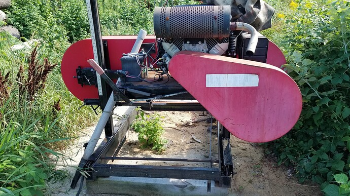

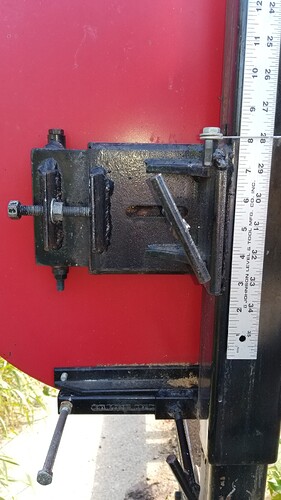

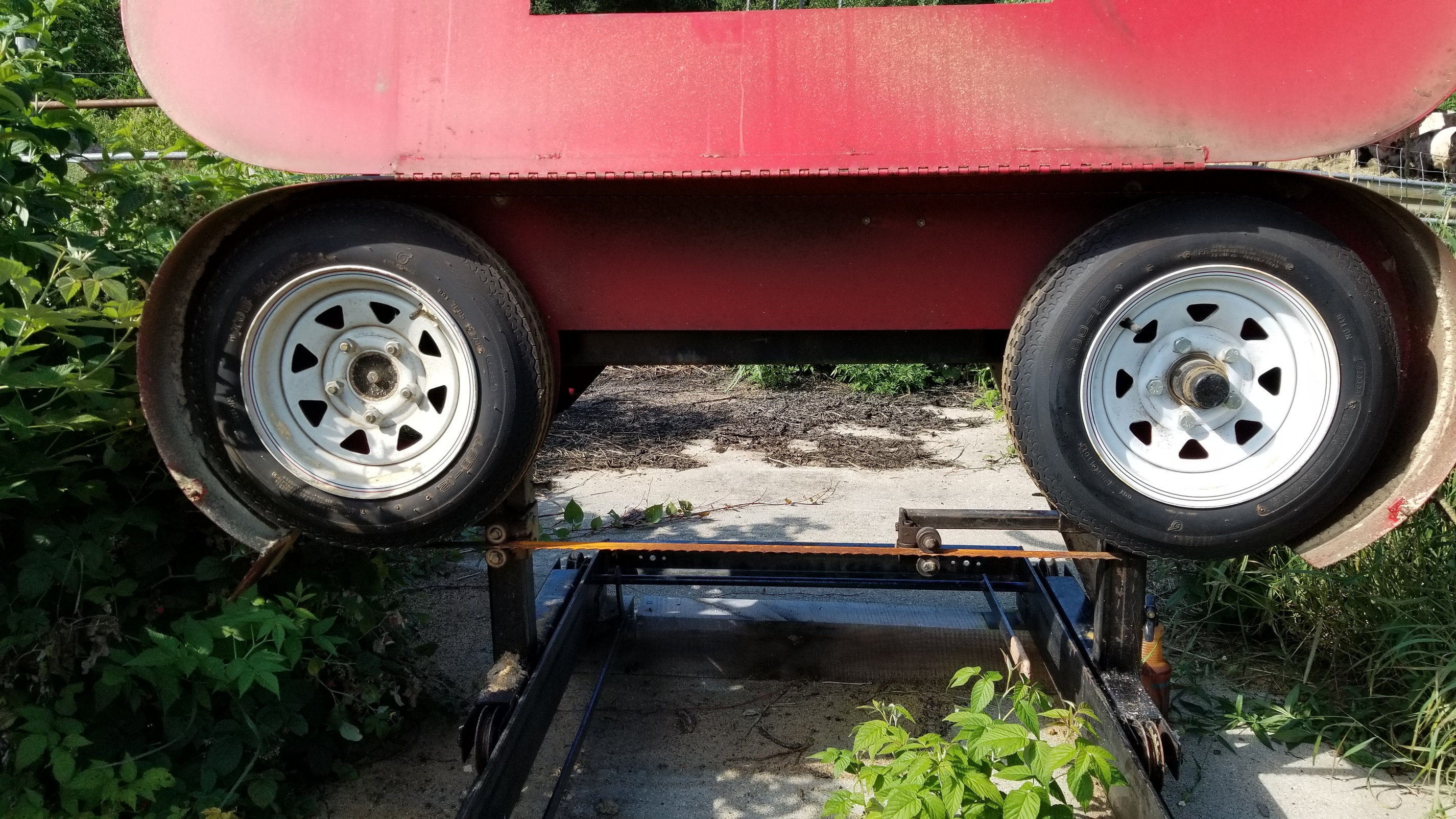

Here are some photos of the head on my mill that might be helpful. Oh also if you leave the log stationary and move the saw head you need far less track you only need track for the length of the log plus the width of the head not twice the length of the log.

Thank you Dan for the pics!
Look on the top on the pic. The pipes slide in one a nother and there is a sturdy screw for tension adjustment. The rig adjusts 4-6".

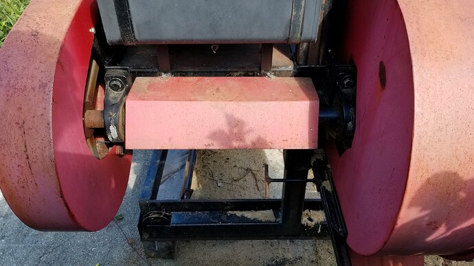

I have a question about those blade liners or what ever they are called. What exactly is that for ? Any insight on how to construct them?

Do you mean the blade guides? They are basically just bearing one of them is on a slide so you can adjust it closer to the log. The idea is to help keep the blade from deflecting up or down when it hits a knot in the log. The problem with a bandsaw mill is that the blade is thin and deflects as the density of the wood changes chasing the easiest cut path. A circular saw takes a wider cut but is stiffer and won’t deflect leaving more true lumber.

I see… I thod they are there allso to prevent the blade geting pushed off the wheels
I toyed with the idea of making a track out of angle iron before I bought my mill. What you need on a track is stiffness and sawdust kills tracks and will bind up a head as you push it through. My plan was to put the angle iron so it was a triangle up on the back side of the bend then run a wheel on each side of the triangle so you had two wheels 45 degrees from each other pressing back to center. My mill simply runs on the top edge of a track with a wheel that is basically a pulley following the ridge. But you do have to keep a stick near by to clean the track periodically.
I haven’t seen any issue with the blades moving on the wheels I wondered how that would work. There is a back roller on the setup though so maybe they do both jobs.
