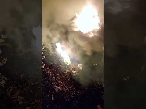

Achived Supernova event today. Not good. Feels scary to say the least. Had to dampen the air inlet to not melt the kiln…
Oh wow, that must have been pretty scary. I hope you guys are ok.
That was some serious heat there.
Was there no way to vent off the gasses to stop it feeding itself or was the fire drawing it anyway? Or was it perhaps unreachable because of the supernova heat?
Doesn’t really matter as long as you’re ok though.
That looks as orange/red hot as you would ever want to get a retort metals. That batch of wood should be a great batch of Charcoal to sale. Good job Kristijan on saving your retort from melting down.
Johan, watch this video taken about 15min after the picture above. Here shit realy got real… safety lid popped, thats a first… squirting out jets of roaring flame…
Wish you guys culd experiance this. The energy!
It realy isnt dangerous by any mean but its not good for the materials. Im willing to bet anything thugh this batch of charcoal will be premium, probably close to graphite in conductivity.
For a long time, l didnt know that pirolisis is a exothermic reaction. Indeed, once it starts, and if there is no more moisture in the wood to moderate the release of gases, there is no going back.
