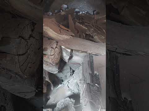

My char dust, sweat and mud filled microphone cant pick it up so well but if you put headphones on you might pick up a song that fresh charcoal sings as it breaths air for the first time. A simphony of light crackling. Starts after about a minute upon opening and lasts about half a hour. Interesting stuff.

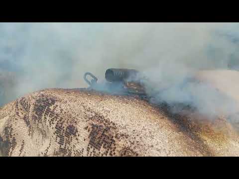

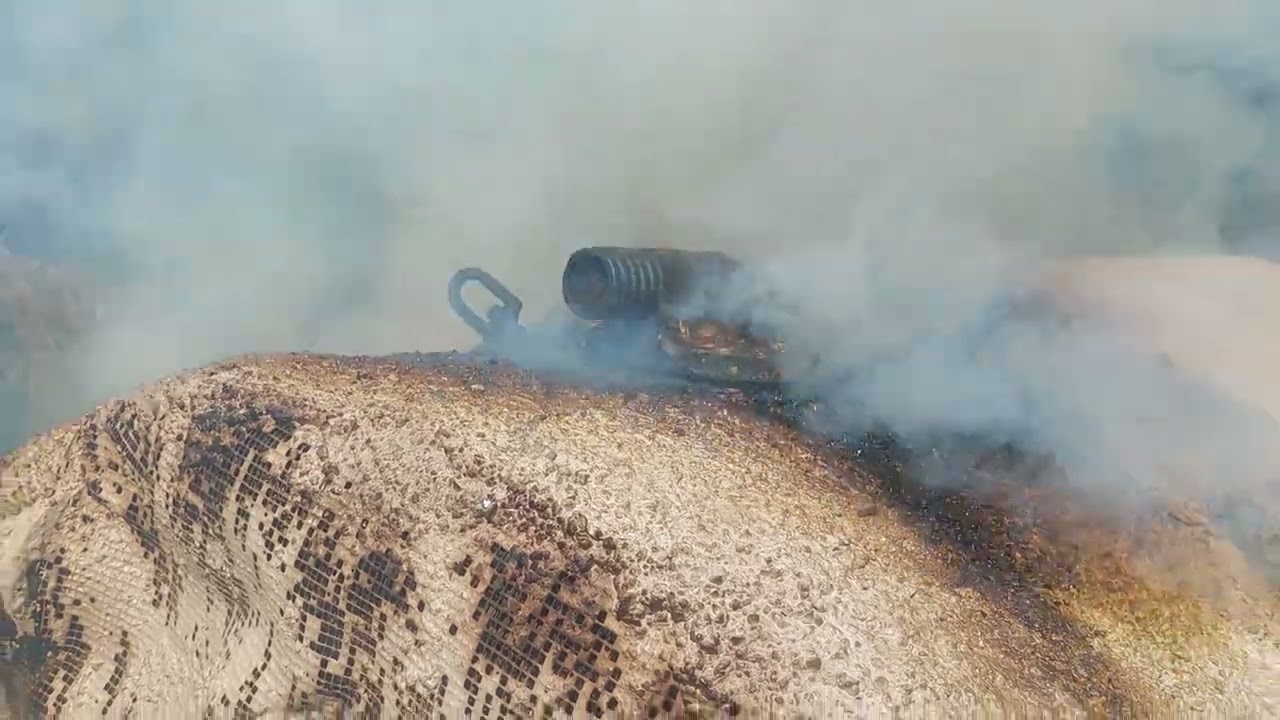

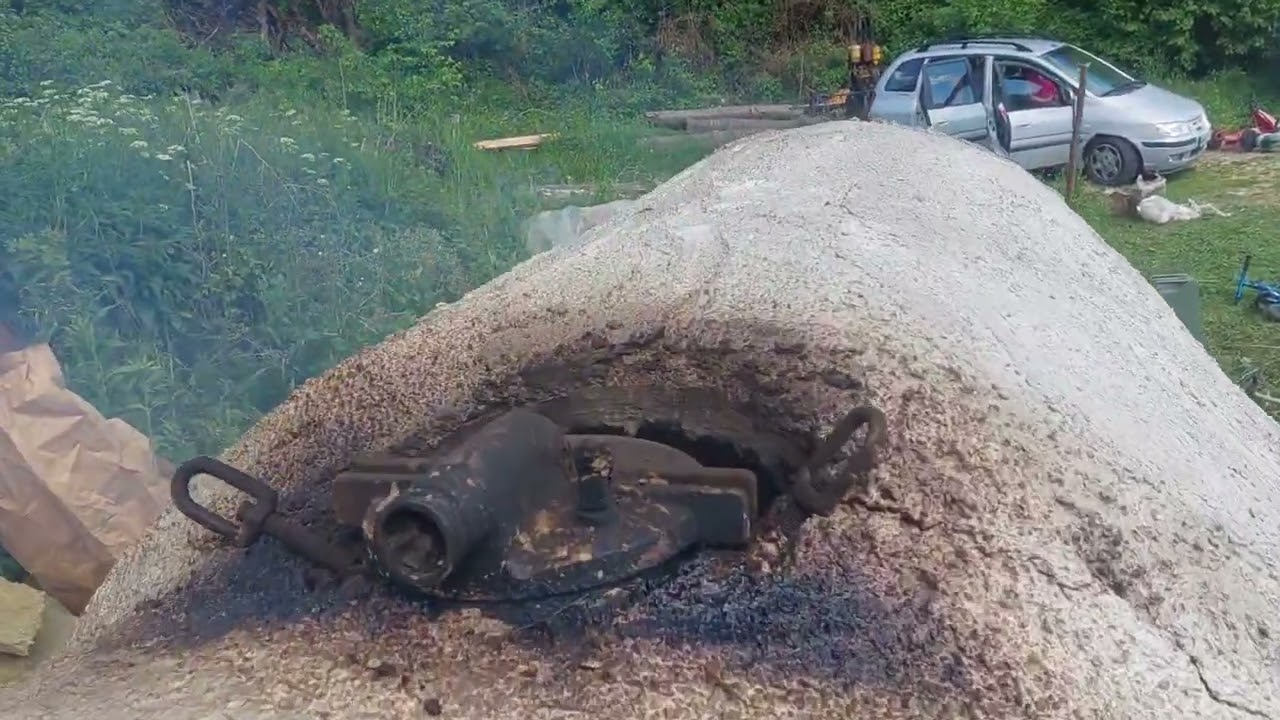

Finaly l insulated the kiln. What a difference! Heatup time went down to 2 hours, an absolute record. The wood is semidry limbs thugh so my clasical fuel (green logs) will take longer for sure but despite that, heating the same wood wuld take at least 5 hours before.

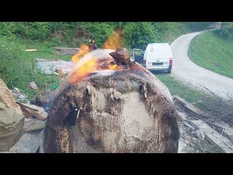

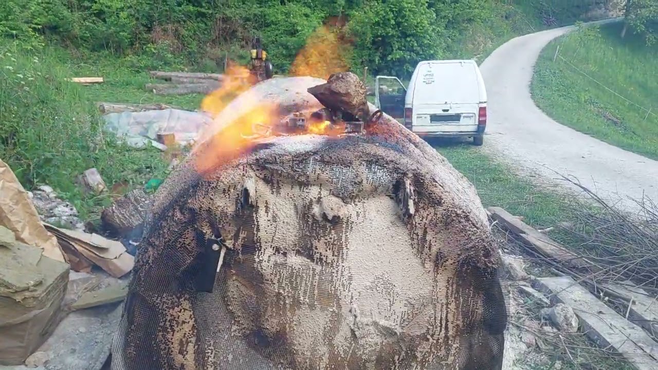

Ha as l hit “reply” this happened. Safety valve popped. Emense pressure inside!
Wow! It’s a good thing you put in a safety valve. Is it just a flap that can be opened by a certain amount of force?
Things progressing quickly! I might concider killing the flame its close to supernova.
You can see it here its just a heavy cast iron 8" lid
Right about here is where we enter the “need for new pants” territory.

Kristijan, what did use for insulation? I see some kind of reinforcement mesh smeared with something.
Good eye JO. I struck gold finding some old fasioned mineral wool plastes at a neighbours place. Those l belive arent even legal anymore (no asbestos). Tough stuff but let me just say parts of me itch that l didnt even know l had :smile:
I placed 3 layrs of this stuff then fiberglass mesh and a thin layr of concrete. Once it all setles l might add a nother layr of fiberglas and concrete. So far its the best layout l had, by far. Realy looking forward to cooking and also extracting tar maybee even gas

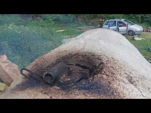

Aaah the first cook of the year!
And what a sucsessfull one! Probably the best one yet. It only took 5 hours of heatup and it was exactly 24h from lightup to packaging.
Yeald was around 170kg over 300lbs with almost no raw leftovers and l threw in some heavy logs. Its incredible how good insulation boosts performance.
