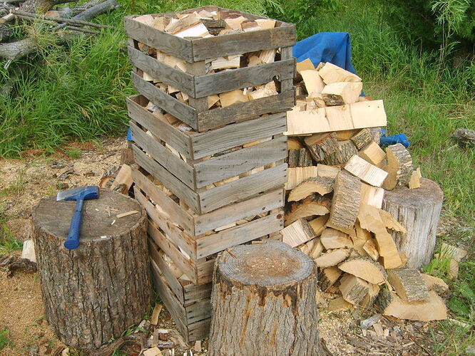

Hey! Got my Estwing “Fireside Friend” yesterday. I like it! 4 pounds - certainly not ever be a backpacking tool. Woodgasers manual armstrong chunk maker! Powered by peanutbutter sandwiches and squirrel/rabbit stew!
I cut some cottonwoods one spring several years ago and the sap literally gushed out of the stump.
Seems to me it rose about a half inch into the air for a little while.
The stuff I used in recent trial was well dried.
It’s a tough wood to split but no match for the Fireside Friend.
