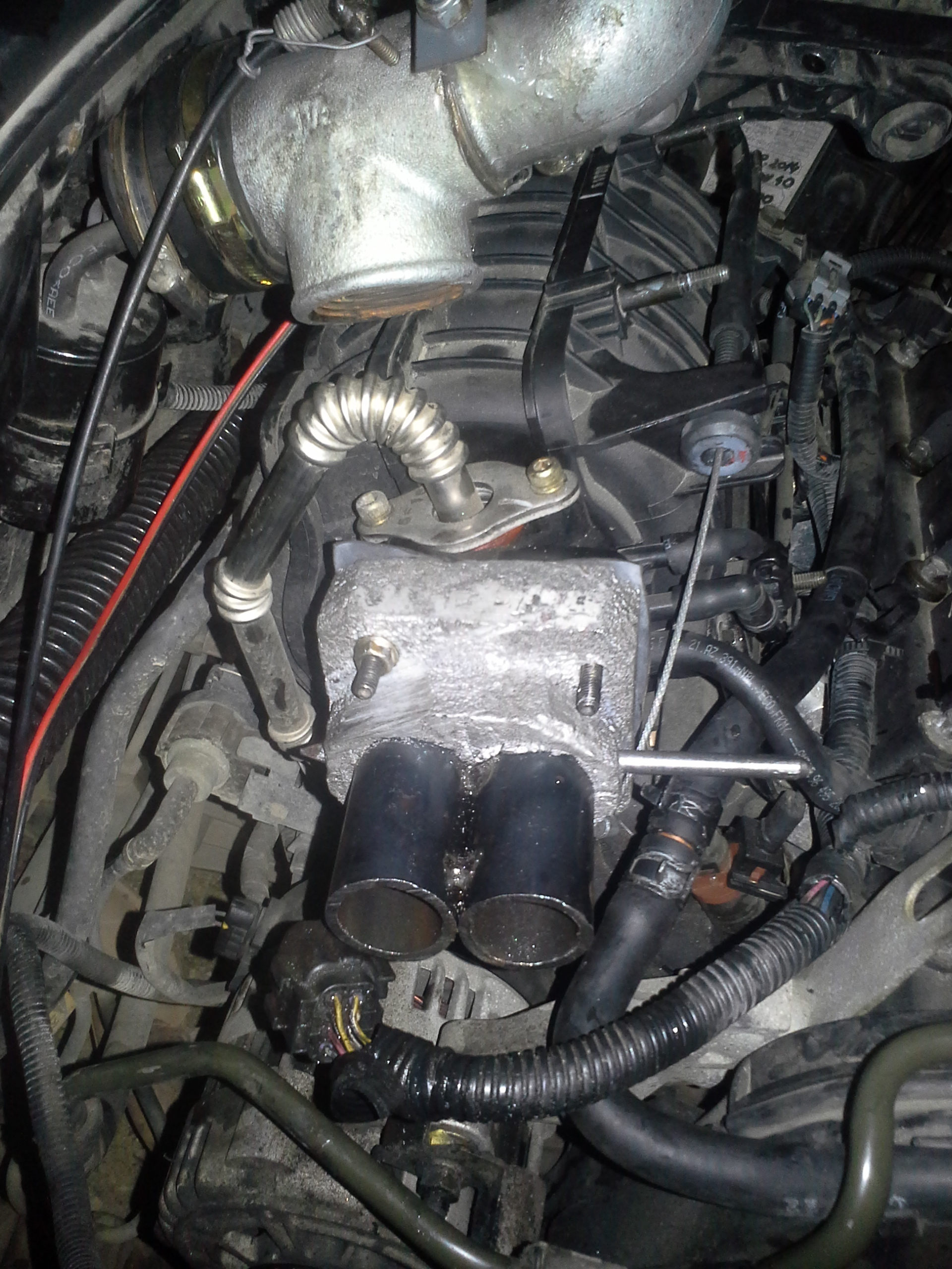

l made the double flap today by Maxs recomendations.
l think it will do the job but, of corse, there is a problem. Since l disconnected the throtle body the computer has no idea of throtle position. No matter how far l open the new twinflap, the rpm doesent rise unless l allso move the original flap. Untill the lambda warms up and override throtle position sensor.

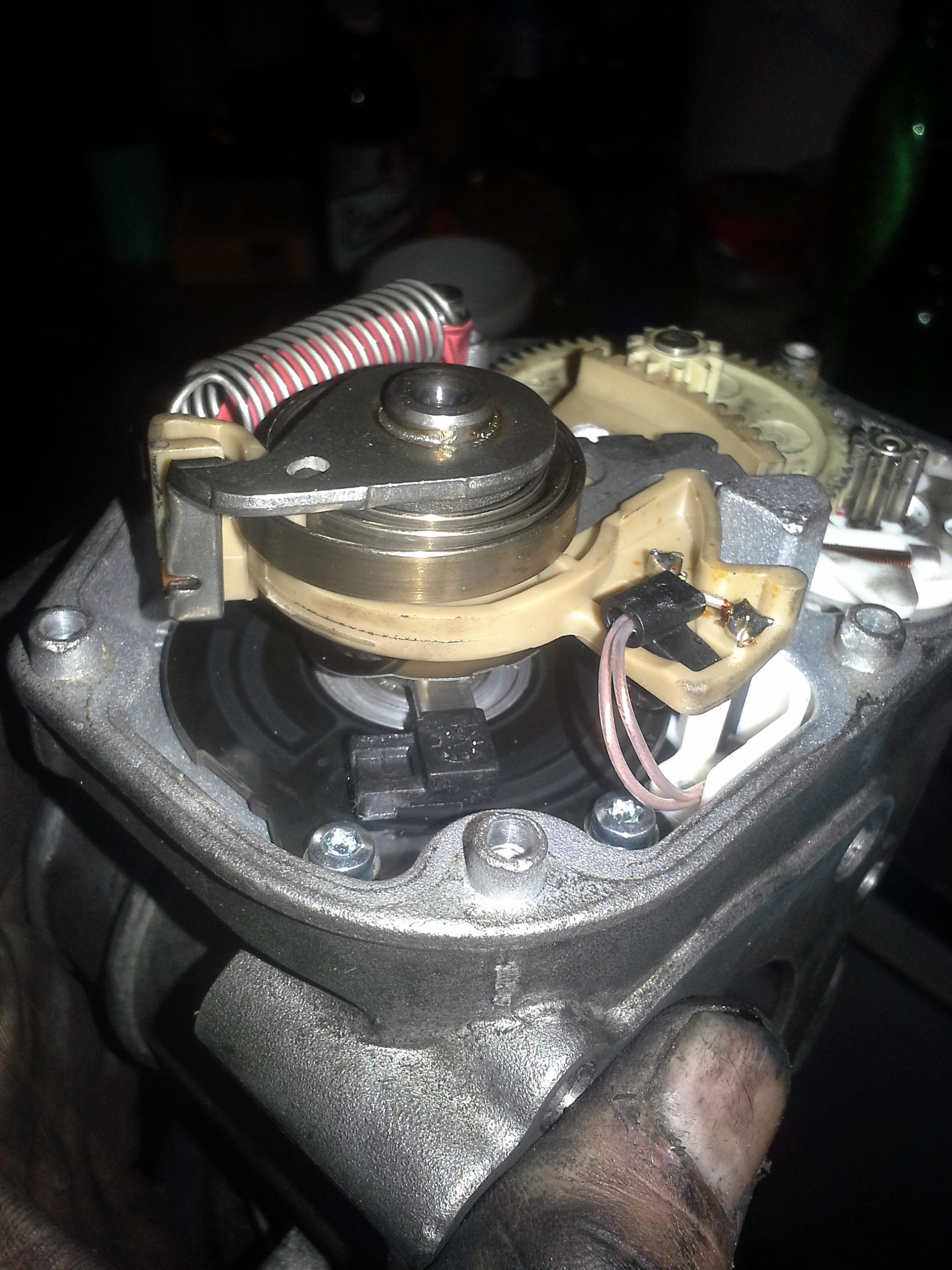

There is a idle servo (non working! it just buzzes) and the throtle position sensor, the black thing slideing on the black plate. My question is how culd one override or symulate this? Is this a reostat?
Ha, this is getting over my head
Kristijan, I’m curious, if I remember right you’re also in an annual inpection area. What are your plans for inspection? Are the changes you make easily reversable? They do look under the hood, don’t they? (And plug in for codes)
Unfortunaly yes. I hope the new throtle body to blend with the rest of the engineparts, it allso isnt hard to change it with the original. Plus it hides a bit with plastic engine cover. l am a bit conserned about the emisions thugh, hope all the experimenting wount hurt the catalisator. This gets printed dyrectly on the licence paper on the inspection, for other things you can sometimes get away with a few € “forgotten” in the inspection papers.
Kristijan,
Well, here I go again talking about things I don’t know enough about…
Yes, the black part looks like a variable resistor, and it is a high-quality one. You could simulate that, but there is more going on with this part. It is a servo, like you said. The buzzing could be just normal hunting around the set position. Could it also be part of your cruise control? also, is that maybe a sensor at the full-throttle position? You don’t want to render your car difficult or unsafe to drive!
Nice job on the twin-flap throttle!
Well there is a variable resistor for throtlle position and one for idle position. There is allso a full closed sensor, there apears not to be a WOT sensor.The servo can only move the throtleplate a litle bit so looks like just for idle. I assumed it wasnt working becouse it lacs power to move the throtle plate at all, just buzzing when it shuld start opening the throtle plate. I have been suspicious about it for quite some time now…

Max, correct absorvation! This is why l removed the original throtle body. No worys on the space, there is plenty of kt if l remove the air filter box!
I culdnt sleep tonught thinking of what to do, thain it crossed my mind, if everything fails, l culd put the new twin throat before the original, conecting it on the same throtle cable. But first, some tests!
