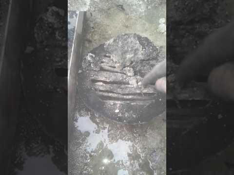

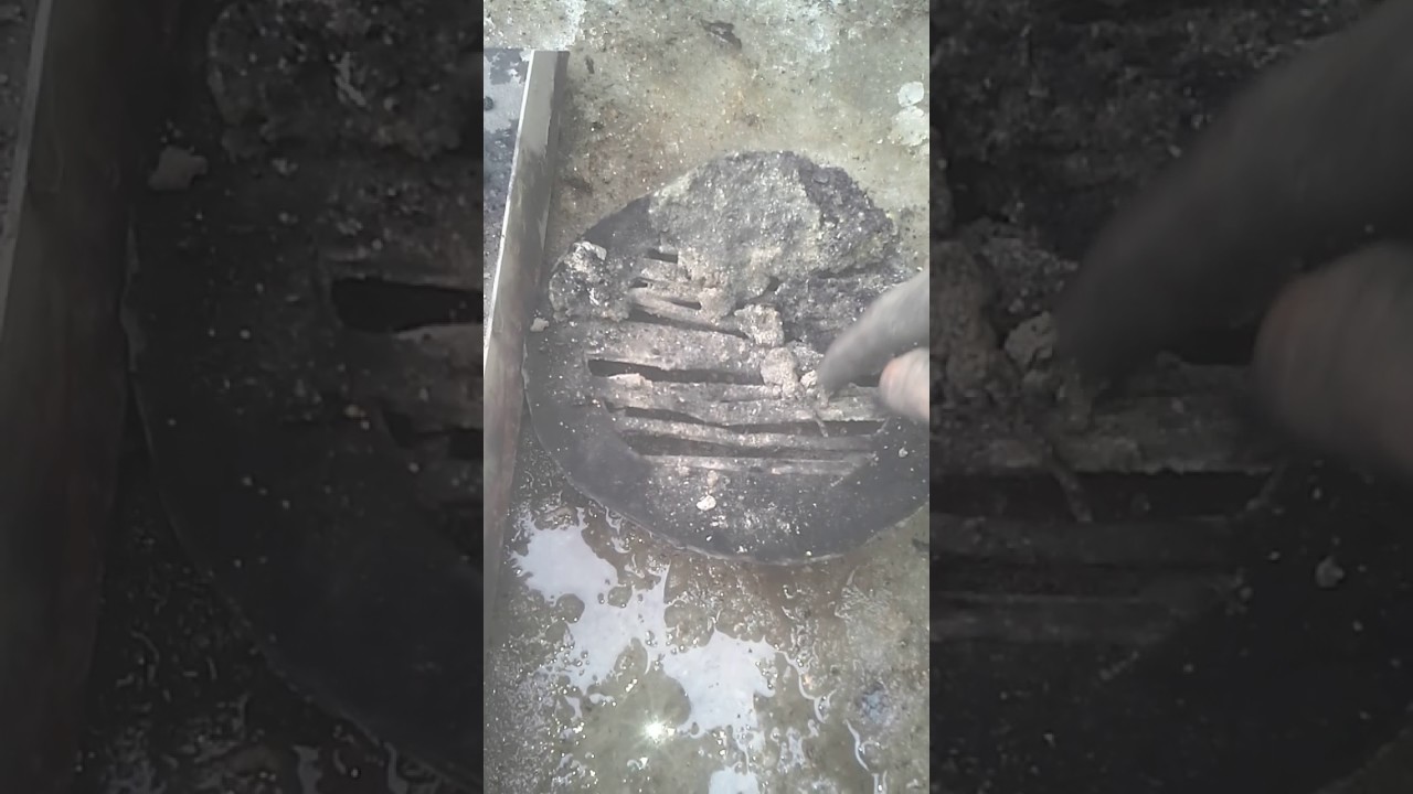

The video preety mutch says it all, just a litle edit to it; when l shut off the camera, l have broken up some ash cake eaven more and found a lot of this glass in. One was so big, broke it in half and seen a perfectly clear inside. So interasting.
Has anyone else ever seen such a phenomenom?
That ash cake looks exactly the same as I get out of my charcoal gasifier around the nozzle.You must have some very high temperatures going on in there.
Kristijan, thats funny, I was just about to put up a dump video myself.
As for the ash I think it’s about what I have discovered when my grate was plugged, but the glass material is new to me. I think Don might be right - that you’re running ash melting temps. I know you have been talking about high silca wood in your area - that may be another reason.
I never had such things and I have potato chipped my grate a few times I think don is on to something it does look a lot like charcoal findings . maybe your short burn tube makes it a wood and charcoal gasifier.
Don, the temps are still a mistery to me. I dont think l am overpulling the gasifier as l had best power and loweest rail temps this week so far but you newer know without a probe.
JO, how do you break the ashcake at refills at long drives? My thinking is they are most problematic, as the cake is not britle and dusty at high temps, so it cant be broken easily when hot.
Ash buildup on the grate seem to be a short ride problem to me. Whenever I see high vacuum I stick my flat tip poker down the grate slots and turn the grate just a few degrees at the next lightup. I have to be very carful not overdoing it or I´ll empty too much out of the reduction and I get a smokey startup. 6:1 vacuum ratio is about the limit from where I can recover without manual grate poking. A grate shaker operated from the cab is one of the top priorities on my to do list. I think the hard baked crust is from running a long time with ash on the grate.
At longer trips, when the gasifier is up to temp and it´s constantly working hard I never have ash problems.

Koen, silicium dioxide melts at about 1700c if l remember right, and a lot sooner if fluxes are added, carbonate wich ash has many. Glass per say is quite sticky as it gets heated above about 800c.
Hmm l take better gas over gasifier heart wear any day. I can make a restriction and grate in less thain half a hour from scrap laying around. If it wuld be ss it wuld last a lot longer.
Realisticly, the restriction gets hit the hardest in my sistem. l wuld guess it exceeds 1000c becouse it is made out of about 9mm thick steel plate and it got bend like it wuld be made out of playdow. Allso, in my previous video you can se ash actualy melts on the restriction. But it works just fine. If l replace 2 per year thats not so much of a problem.
Nozzles and firetube show no sigh or wear.
