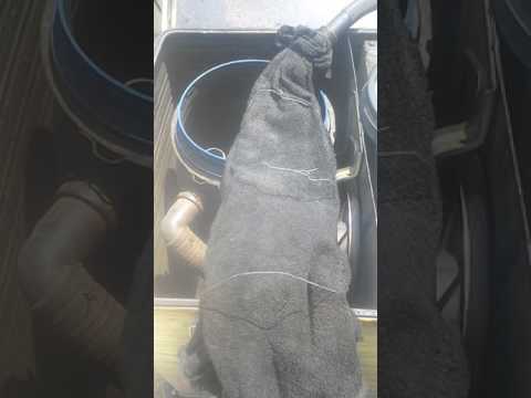

Hi guys, as promissed, the sack filter video.
Took me 3 days to upload, dont know why but my prone is no friend with Youtube.
Anyways, l had driven it for about 300 miles and started feeling restrictive gas flow so l decided to take a look at the towel sack. It was NOT the reason for the restriction (l found a ashplug in the gasifiers restriction-happens from time to time) so l hanged it in the sun for a hour, and put it right back in.
There was maybee a couple of spoons worth of soot in the sack, shuld operate well for a lot more miles.
Put 150 aditional miles on after that.
Now, a nother interasting thing l noticed. Gasifiers never seem to stop surpriseing.
Since l started to burn pure beech chunks, my condense/filter are is full of ammonia! I did smell traces of it before but now l literaly have to vent the filter barrel for a minute in order to come close to the sack without tears in my eyes. Incredibly strong burning smell.
Has anyone saw this too?
I know woodgas is a feedstock for ammonia production but it requires a iron based catalyst to react. And why now, when l swiched to a better fuel?
I dont complain thugh, plants shuld like the ammonia rich condensate and the engine doesent complain on rich ammonia allso
I notice ammonia smells also on my charcoal gasifiers both on the Geo Tracker and my lawn tractor when I open the fill lids.
Thanks kristijan i been trying too wrap my head around how you get that bag too open up while in vacuem mode hooked too the motor or are you useing pos. Preasure with a pusher blower.?? Looks good. Plus 30 charictors.
Well, the sack inflates when pressure is higher in side the bag thain out. It doesent matter if this is established with pushing the air in with a shopvac or sucking the gas out. The gas passing trugh the sack is whatinflates it if you like.
Its similar to how your lungs inflate while drawing the chest down.
Don
Ha, at refills? Thats newâŚ
Thanks so i would say the vacuem is applied too the out side of the towl filter?and air moveing in too the inside the bag opens the bag filter?
Spot on!
Plus characters
Is that after the 300 miles? That does not sound that good unless you have a cyclone too?
I do have a cyclone, but it has shown to be ineffective. Not the cyclone its self but its dust box is 90° to the cyclone, becouse there was no other way to mount, and the 3/4" 90° knee transition plugs fast so its as if l dont have it. Most soot/fine/ash char gets collected in the cooler, the rest ends in the sack.
