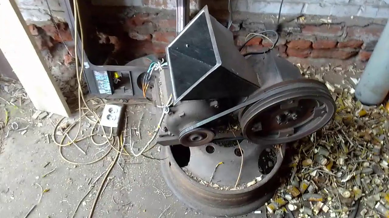

to significantly reduce the cost of time and effort to prepare fuel for a wood gas generator, a branch cutter will be quite convenient.
