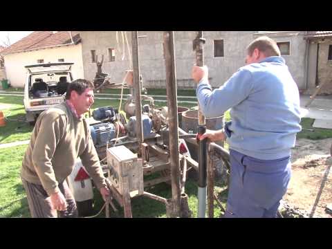

Marat, if you have clay soil, it is quite easy to drill with the process of washing the drilled soil. This video clip nicely shows the process of drilling and then blowing out - cleaning the bore, …
