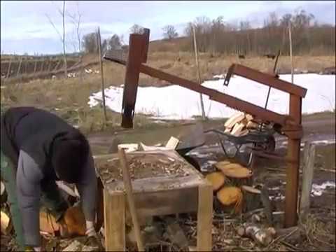

Been trying to scheme up a pattie/cookie splitter to use. I’ve seen @RPMHartman gravity splitter and it looks great. I’d rather it be manual though. Looked at some of the DIY manual log splitters but I’m wondering if it’s possible to miniaturize them for the thin cookie cuts?
I’ve still got probably 60 feet of that 36" diameter red oak and it takes forever to process with just a Fiskars hatchet. Maybe the simplest solution would be making a sturdy table for splitting kindling and cookies that has a lip so my chunks don’t go flying everywhere. I think bending over to pick up the errant chunks is the worst part.
Yes exactly like that, but I doubt it would need to be half as big for just 3-6" long cookies of wood. I actually had started to make a copy of Herb’s splitter using a truck inner axle and a hatchet head. Weighs about 25Lbs right now. With some assistance that can split a cookie. Herb’s splitter works purely off of gravity so his had to be heavier.
Edit: I’m going to replace the hatchet head with a splitting wedge head, will add 5 more pounds and give a more aggressive taper. If I can split cookies with just a little downward force I may be able to make a manual splitter with a return spring. Maybe a moped or motorcycle spring would be enough ![]()

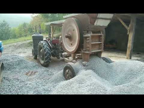

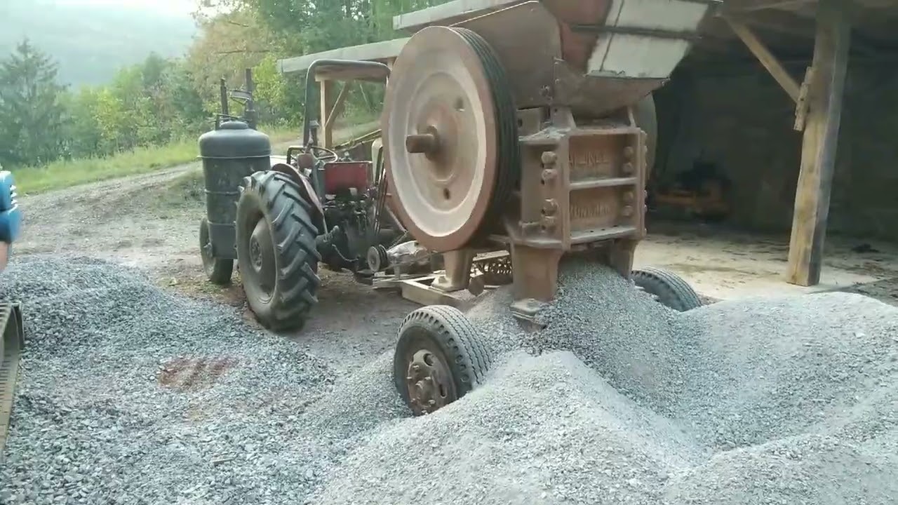

Wow Tone, that could be one hell of a good charcoal crusher! A little overkill, but… ![]()
Hello Martin, I was also thinking about this, and the chopper for thicker wood could be adapted from the side, the flywheels weigh approx. 1200 kg.
